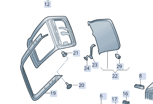

image.png.da85ef62f5d611eacfac23997a72825e.pngItem 24. 23 is the handle.
Part number for the bolt is N90651302
Looks like maybe only one of the two trim panels needs to come off to see if the fixing (part 29) is still there for the bolt to attach to.

Thanks for the diagram.  Could it be that Part 29 is actually one of the many spring clips that hold the trim in place, rather than being a fixing for the grab handle? The image looks like that.
You might be right as 22 appears to possibly include clip 29 by the use of the drawing bracket to panel 22.  It's not clear as the drawing bracket is so close to the number 23.  Some lists will give quantity against the part number that makes things clearer (example only - 1 panel, 6 clips).
Don't have too much faith in parts drawings even from manufacturers as they can have errors and omissions.
Have look at the following parts site for a difference to the one shown but until you have the factory fitted part out you don't know for sure how accurate any drawing is or if the part you get is exactly the same. - https://skoda.7zap.com/en/cz/
