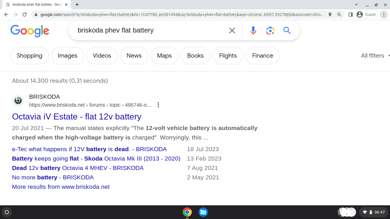

@Novascape   Really you should not need to point them in the right direction, even the Service Desk staff that know nothing about cars even Skoda,s.
They might 'Never of seen this before',  or Never heard about this before.    This says more about them than the actual cars.
@Rooted after my last experience when I took it in for a complete failure to start and they tried to tell me it didnt happen because the car had nothing in the logs.
My local dealership probably needs help to use Google or a sign pointing to a recall for same sort of issue
