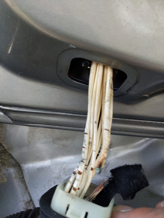

My apologies…the wiring on the left gaitor (as you look into the boot) resembles your picture.
I can’t see no break in the wires…but I am guessing it somewhere.
How do I find the break ?
There is the break.
Spoiler
Thanks for everyone's help. Very much appreciated.
Last question...how to I fix that ?
Crimps ?
Type "Febi repair kit Skoda Yeti tailgate" into the Bay of E.
Good luck!

47 minutes ago, MCAMRA said:
There is the break.
That would do it yes, and you see my point about how if could look mechanically OK but be  electrically FUBAR now?
Good luck!
The part fitted like a treat.
Everything is back to normal. Boot opens, lights work, and the back windscreen wiper does its stuff.
