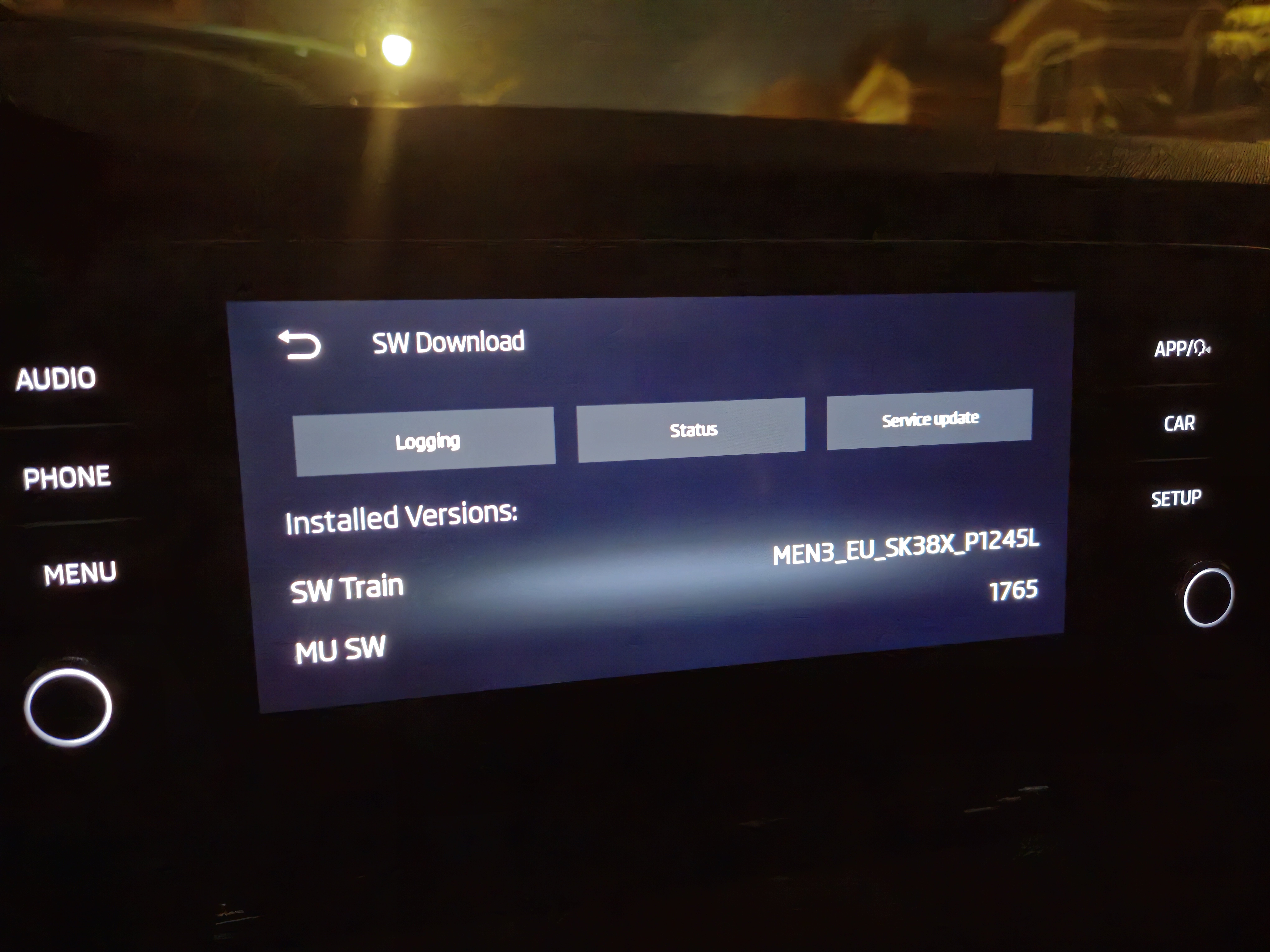

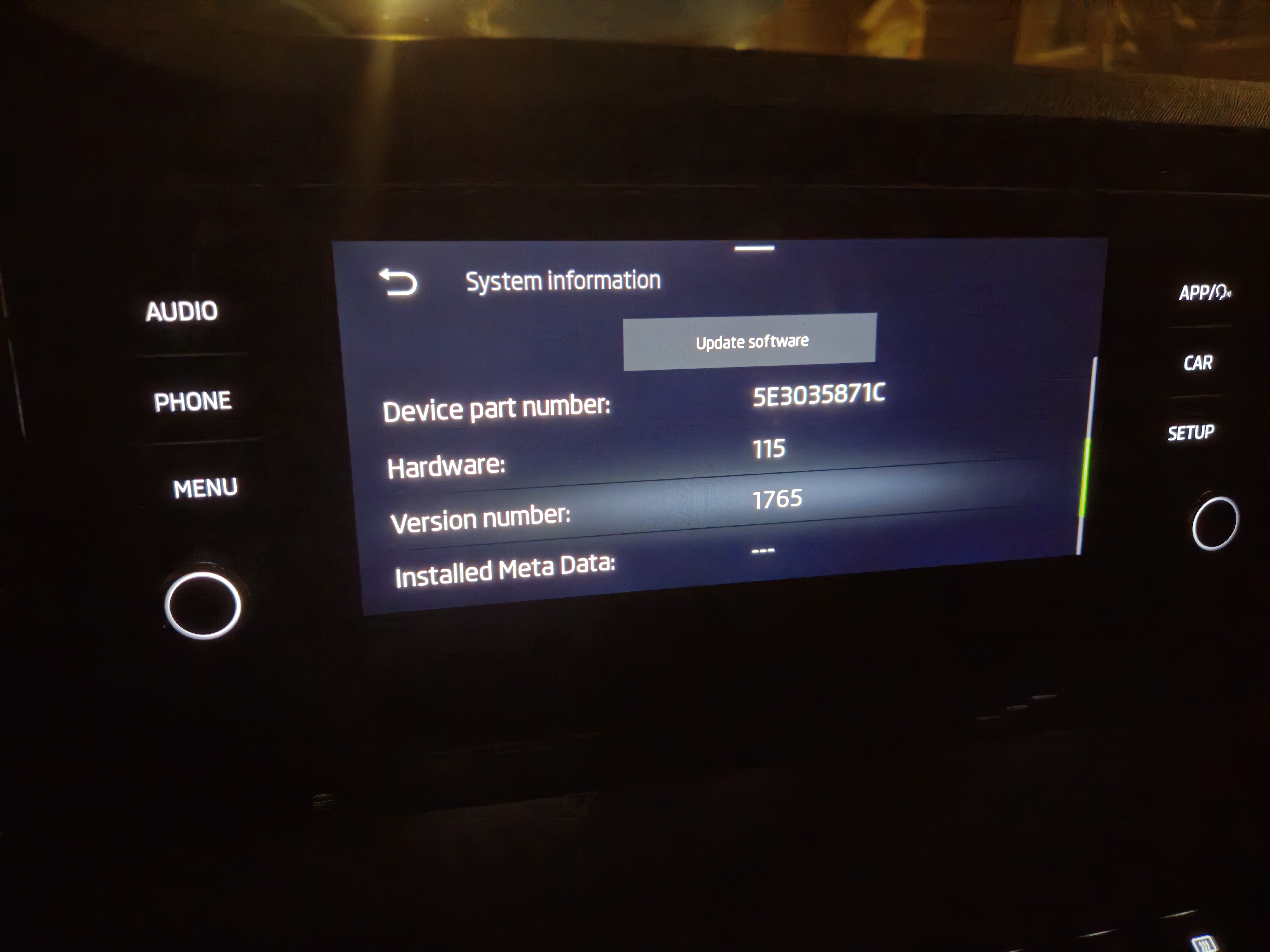

So I just bought a 2nd hand 2022 octavia and what I'm assuming is an outdated software (shown in the attached pictures). Meaning that I've come across the infamous android auto connectivity
problem with my Samsung s23+.
I've done some research and and found that the version 1800 fixes this issue.  Other than taking it to the dealer, how can I update it myself to the latest software and fix the issue seeing as when I press update software nothing shows up.
Thanks

If it's a very low number it needs to visit the dealer to have two upgrades, one to take it upto 18xx, then another from 18xx to 19xx, but I think it also depends on the radio/infotainment system fitted.

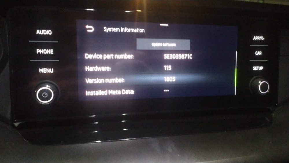

I managed to take it to the dealer in the end and they updated it to 1805 claiming that it was the latest software available for my 2022 octavia. But it did fix the android auto issue with my S23+ though!
I take it yours was done under warranty. Mine is not in warranty, bought it 2nd hand 3.5 years old.
You're thinking of MOI3. This is MEN3, it uses completely different software 🙂. 1805 is currently the latest for this system
