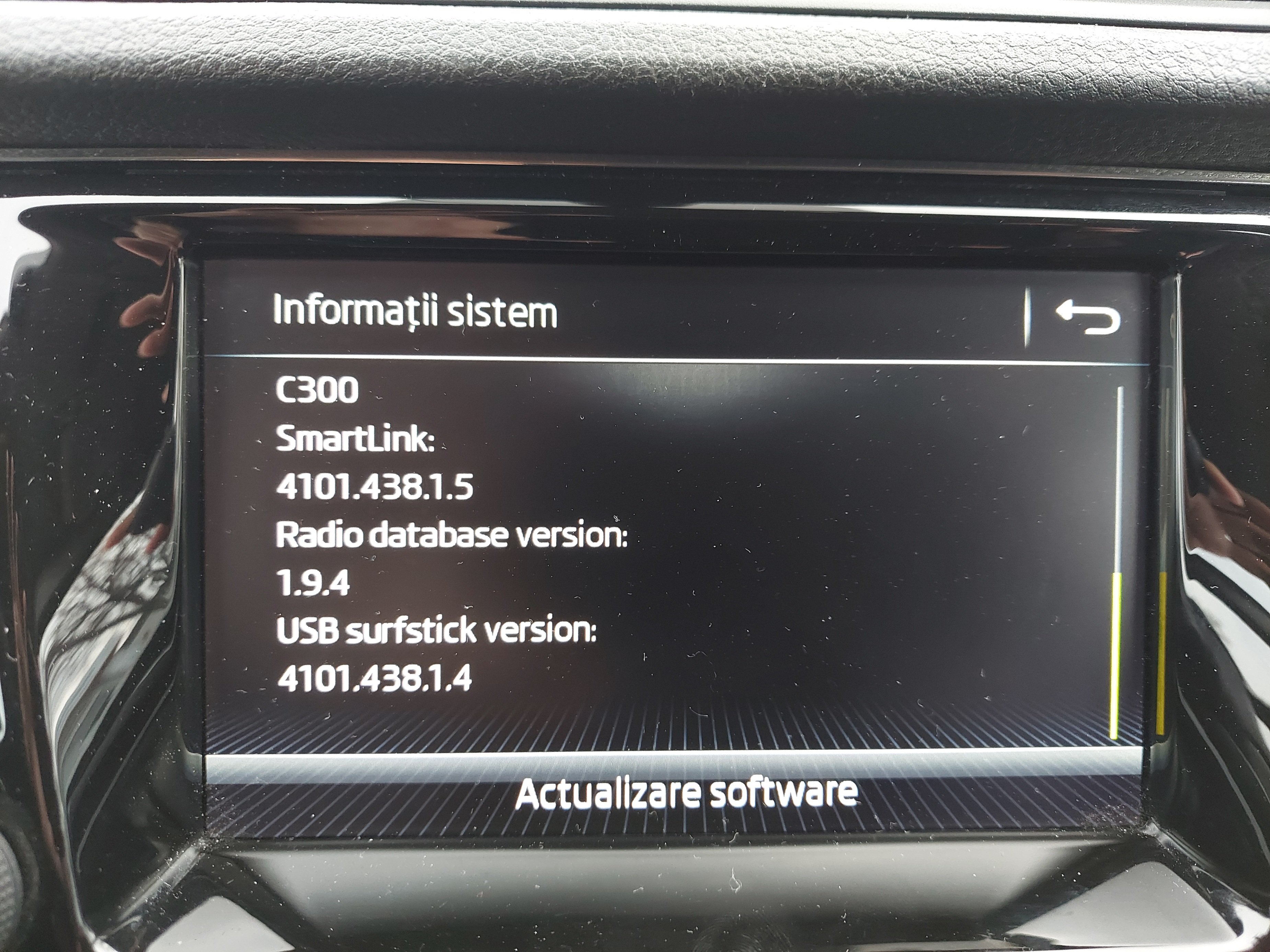

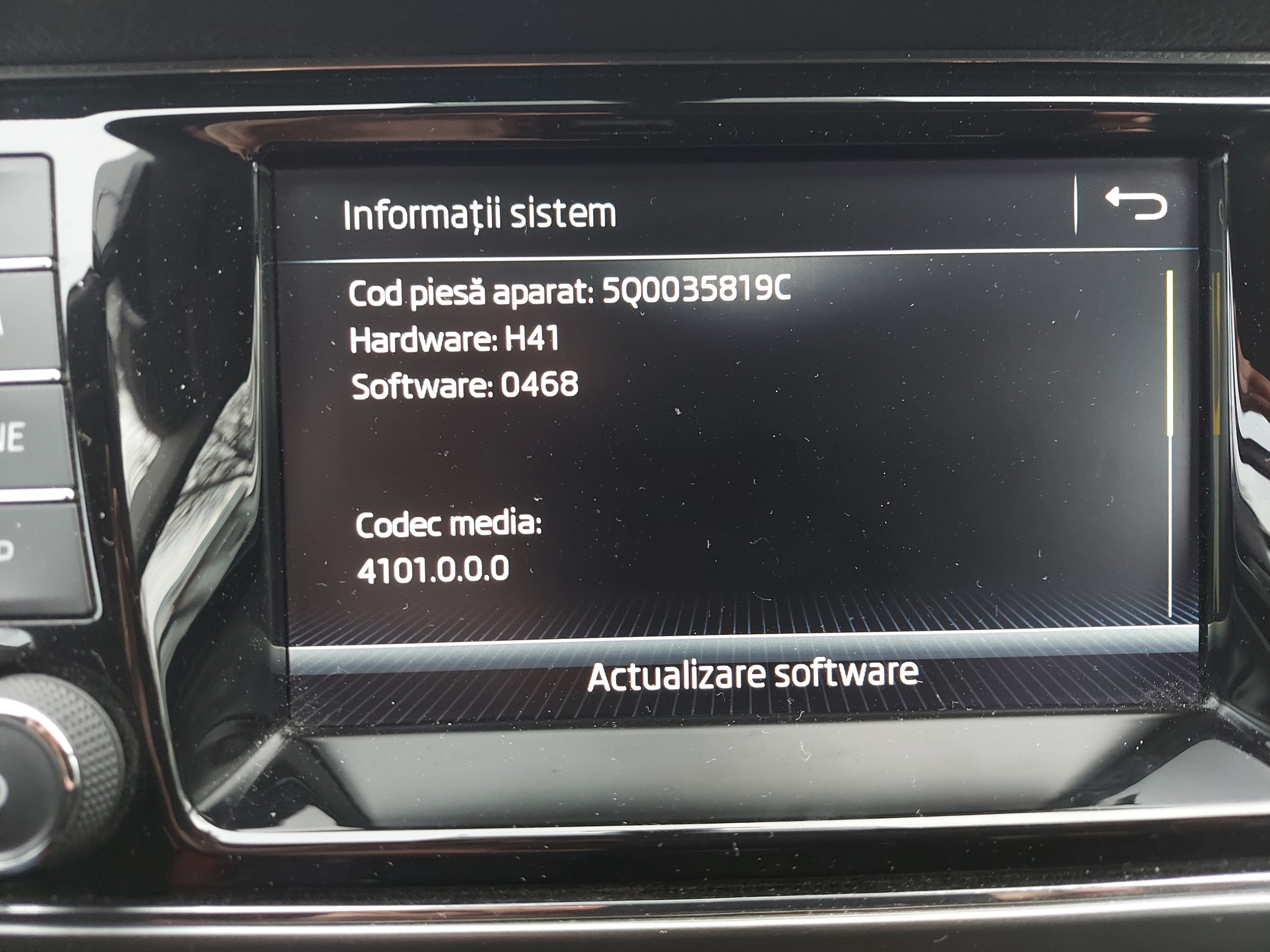

I own fabia mk3 2017, how add smartlink function to my car,  i suppose i must change unit. I attach the photo with version.
VIN TMBJR6NJ2JZ053939

The problem that the function is not in the menu
@Planetse 5Q0035819x and 5Q0035820x (x - any letter) units do NOT support SmartLink so purchasing from SKODA does not make any sense. They also do NOT support voice command and rear view camera.
@dragos1980 I can deliver patched 5Q0035840C unit, in Plug&PLay version, that supports all the features I mentioned above, as well as Performance Monitor (SPort menu). If you are interested pls contact me on PM.
