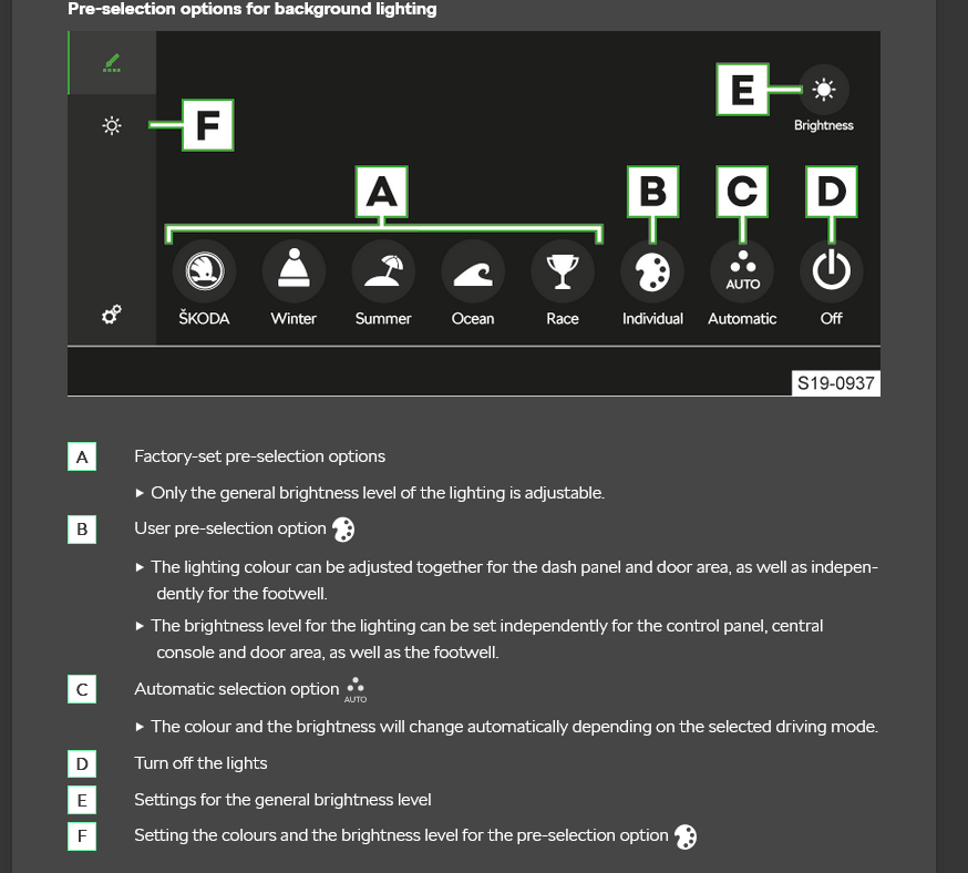

Fantastic, thankyou @Stonekeeper, that works perfectly. I don't suppose you know if you can change the background lighting so it's different for each driving mode?
