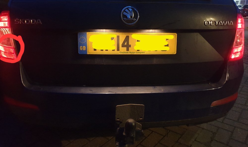

help needed please my N/S bottom part of the C lamp does not work , I have checked the bulb , I have even swapped the holder from left to right but still the same.

Car - Skoda Octavia Mk3 2014 Tdi Elegance - nearside rear light bottom bulb doesn't illuminate.
First what is the LHS (nearside) bottom bulb supposed to light up for sidelight or fog light - if fog light the foglight only illuminates on the RHS from factory - if suidelight carry on with questions below.
Put your headlights on and the rear fog light on to check positioning of fog light.  Have the ignition on and check position of rear brake light by getting someoine to press the pedal or wedge it with a stick (against drivers seat and move seat to a forward position to press the pedal enough, have something to stop the end of the stick damaging the seat hardback book, cutting board, ect.).
  • Bulb has been checked - how?  Has the bulb been put in another part of the light cluster or in the light cluster on the other side where the bulbs there are known to work?
  • Is the bottom nearside light position for rear sidelight only?
  • Is that position on the RHS light cluster also for rear fog light?
  • Is the bulb in that position (on LHS) marked up for W5W (5w, capless (501) or P21/5 (21w/5w, offset bayonet (380) or other?
  • Have you checked live and earth at the LHS bottom bulb holder part of the LHS cluster?
Whatever test equipment you are using did you check it was working properly before using the tester for testing?

Thanks , for all your suggestions . The n/s bottom lamp  is a side light and fog light , the fog light works but not for side light . is there some coding i need to do so it knows it should be a side light
AfAIK in the UK the LHS fog light isn't usually enable from factory.
So if the bulb is a P21/5 (21w/5w, offset bayonet (380 have you put the bulb in opposite way round with the offset pins on the wrong side?
Edited by nta16
ETA: image
you Are right its not , i just wanted to prove that it worked , the RHS is a single  filament  bulb as well , it just makes it brighter , both are single filament
