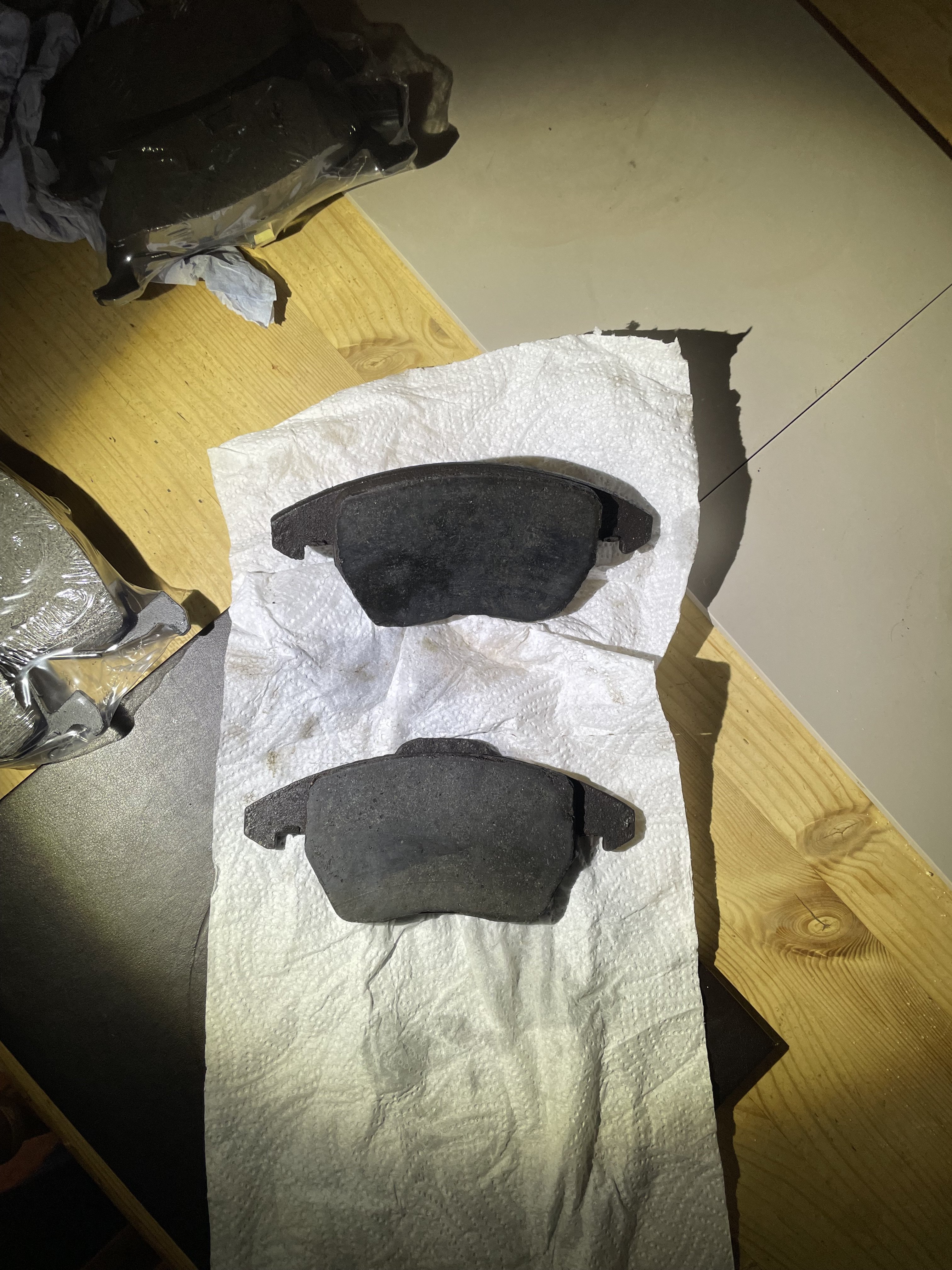

I've notice a rough or grinding type sound from the brakes the past week, there appears to be plenty of wear left on the pads. I've powerwashed around calipers, cleaned the guides and used some copper grease to lubricate the guides.
Looking at  this photo does the bottom pad seems a bit glazed?

Have you checked the back of the disc? one pad looks carbonised and the other looks as if some other material has
contaminated the pad have they worn evenly and not taken on a taper?

I'd say definitely not glazed.
In my opinion, I would say the surface of the disc pads are rather poorly pitted.

I would replace the pads.
