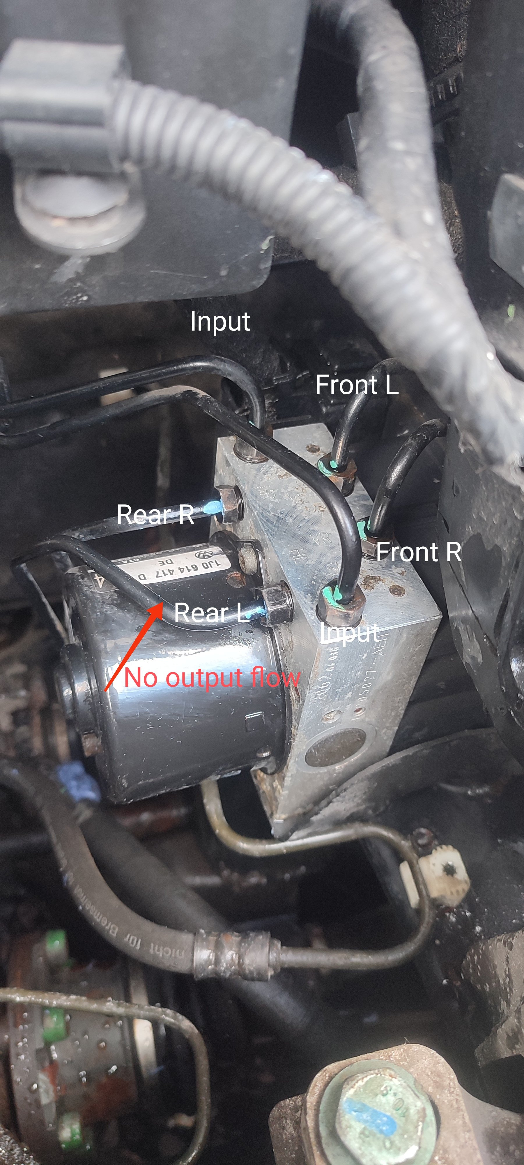

I've basically fault found right back to the ABS pump, (line from caliper to ABS pump is clear).
Applying pressure to the master cylinder & all other 3 calipers flow fluid.
I moved to the ABS pump & loosened the outlets on that & confirm fluid flowing out of Front R, Front L, Rear R, but of course Rear L is dry nothing coming out.
The two pressure lines (input) into the ABS pump from cylinder are also good.
Just checking with you folks 'the experts', would you agree that it sounds as if the compensator inside the ABS block has failed?  I'm thinking of ordering a new 1J0 614 417 D ABS pump/compensator.
