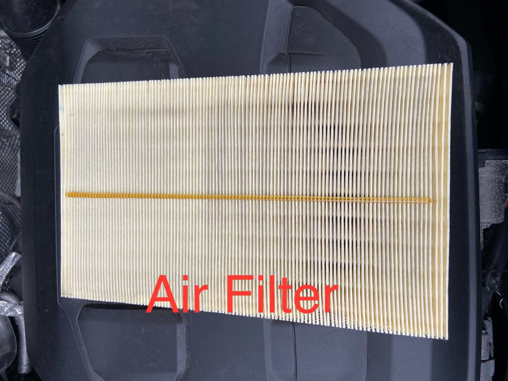

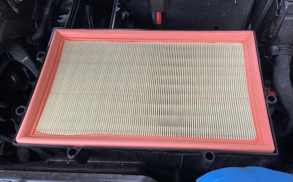

Engine air filter took me 5 minutes. From exiting garage. Didn’t look very dirty at 9,400 miles.

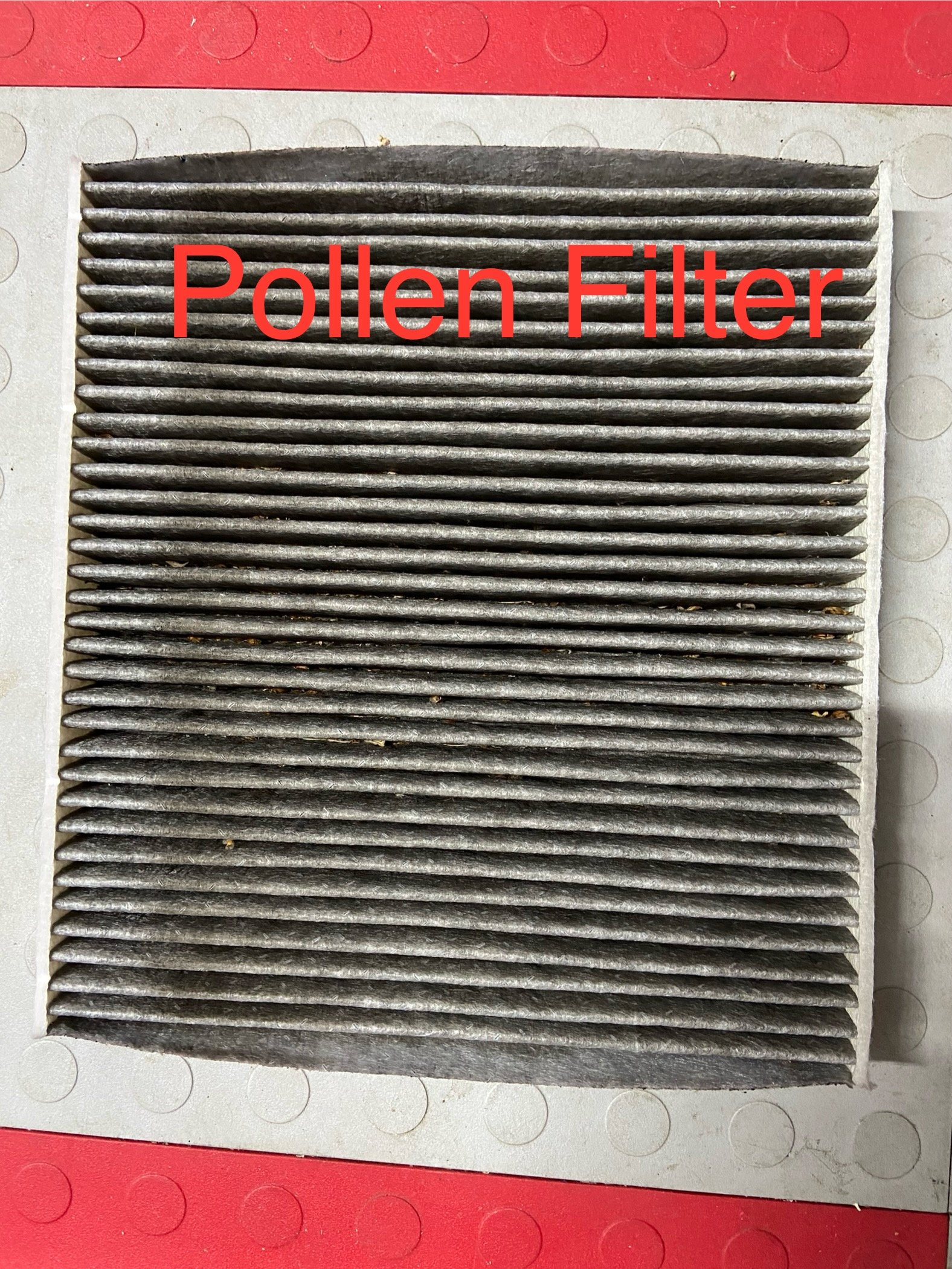

Pollen filter took longer - 9 minutes all in - because I had to return to garage for a big screwdriver to lever the tags back that release the glovebox lid.
The side tags seem different from my previous Kodiaq and I couldn’t lever them sideways with my fingers. Awkward access and stronger “spring”. I was ready for the RH cog wheel jumping out of place, so reassembled the RH damper before popping the glovebox lid back into place.
Pollen filter was pretty dirty. Must be doing a good job.

The cabin / pollen filter looks quite clean.
It’s a charcoal filter which makes it look dirty even though it may not be.

I'm surprised you found the engine air filter difficult.
What did you find?
It only took me a few minutes to remove the 8 (I think) screws holding the cover on.
Then swapping the old filter for new and putting the 8 screws back in.
I did cheat using both a normal Torx hand tool plus a power drill with a Torx  bit.
It really was easy.
Sorry, no pictures.
