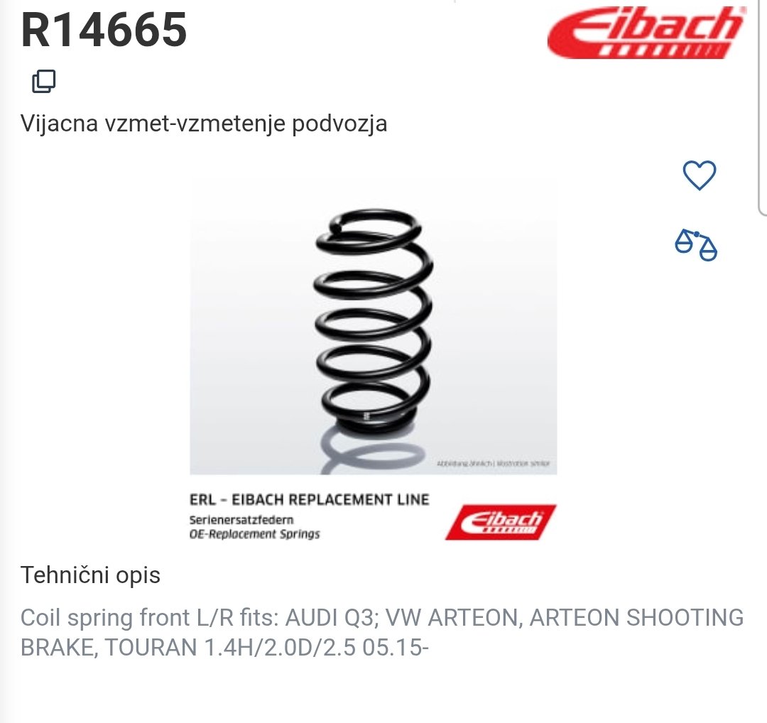

Standard ride height front spring
5Q0411105GM Length 315mm, Wire diameter 12.25mm
Sports/lowered ride height front springs
5Q0411105HE Length 278mm, Wire diameter 12.25mm
https://www.autodoc.co.uk/eibach/17876011
5Q0411105HF Length 282mm, Wire diameter 12.5mm
https://www.autodoc.co.uk/eibach/17876012
5Q0411105HG Length 287mm, Wire diameter 12.75mm
https://www.autodoc.co.uk/eibach/17875999
