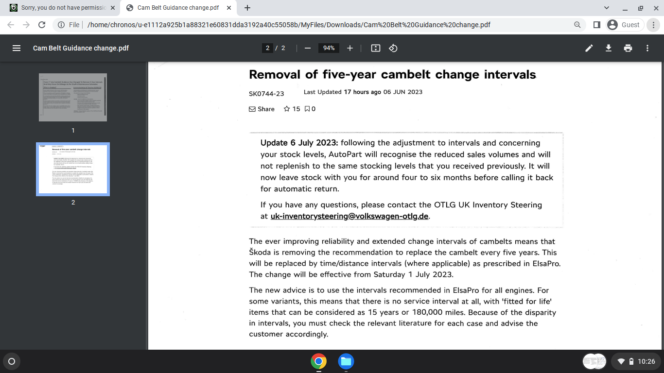

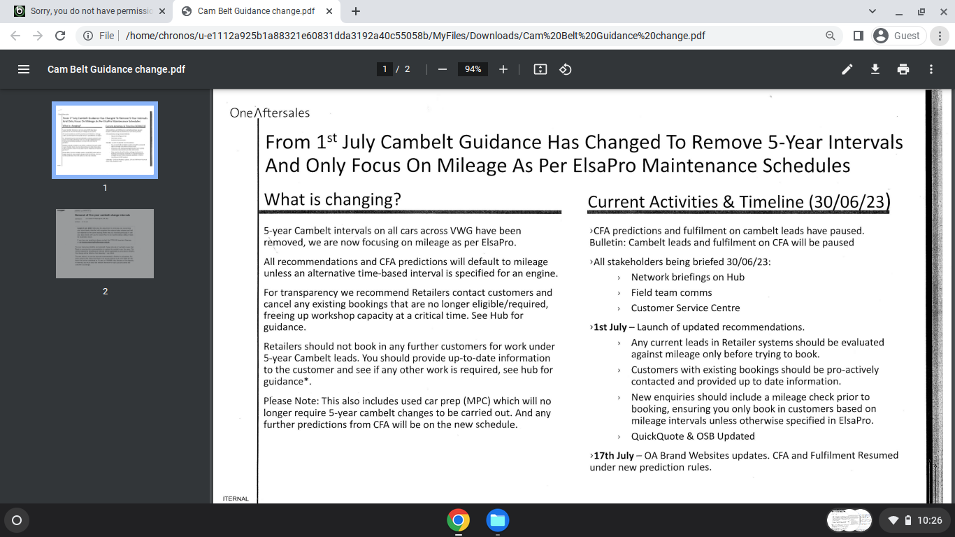

Timing chain.  But someone else can maybe confirm.
(& If  it had been a Cam Belt best not assume that it is every 5 years, because VW / Skoda dropped that in the Non-Dust UK last year for TSI,s.)

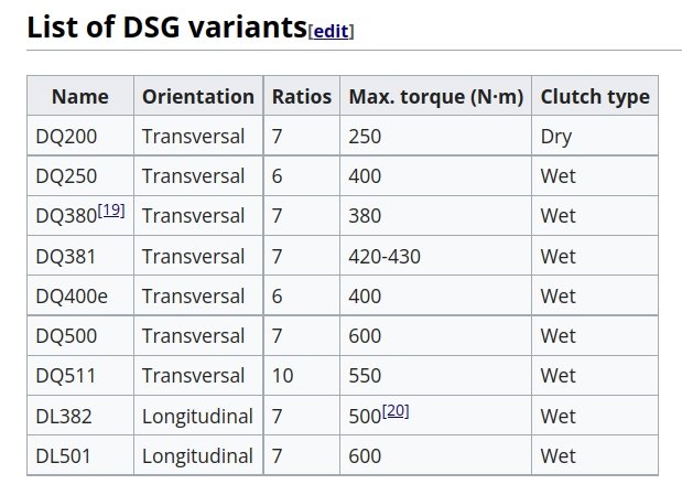

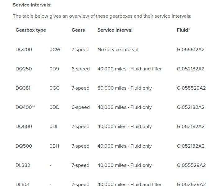

As to the DSG, if a DQ381 7 speed wet clutch the Service Schedule is at 80,000 miles.    You might want to think on that being done sooner.  & correctly.

Yep I've just found out the same on another group I'm on. Chain rather than belt (I thought it was chain but had seen something online that said belt so it threw me somewhat) and it's the DQ381 so 80,000 miles with no mention of a time.... My current DSG (DQ200) on the Superb is 4 years / 40,000 miles so I'm going to just stick with what I'm used to although I'll stretch it slightly to between 4 and 5 years if it means tying it in with an annual service etc.....

@WaveyDavey   What car /engine do you have with a DQ200 DSG?
  A DQ200 DSG has no Service Schedule, Guidelines, Recommendation or Spec for oil changes.   Just saying so people do not get the wrong end of a long stick.
Well done... You spotted my deliberate typo mistake to make sure you were taking notice. 😁   Should have read DQ250 not DQ200. (MY11 Superb CR140).
