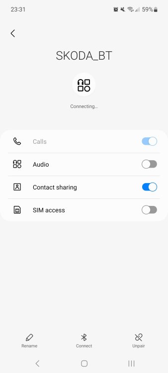

In your phone Bluetooth settings disable SIM Access and see if it still works in hands free only mode.
There is no bluetooth connection  - "Incompatible Device".
Thanks for the reply anyway. Good to know for future reference.
