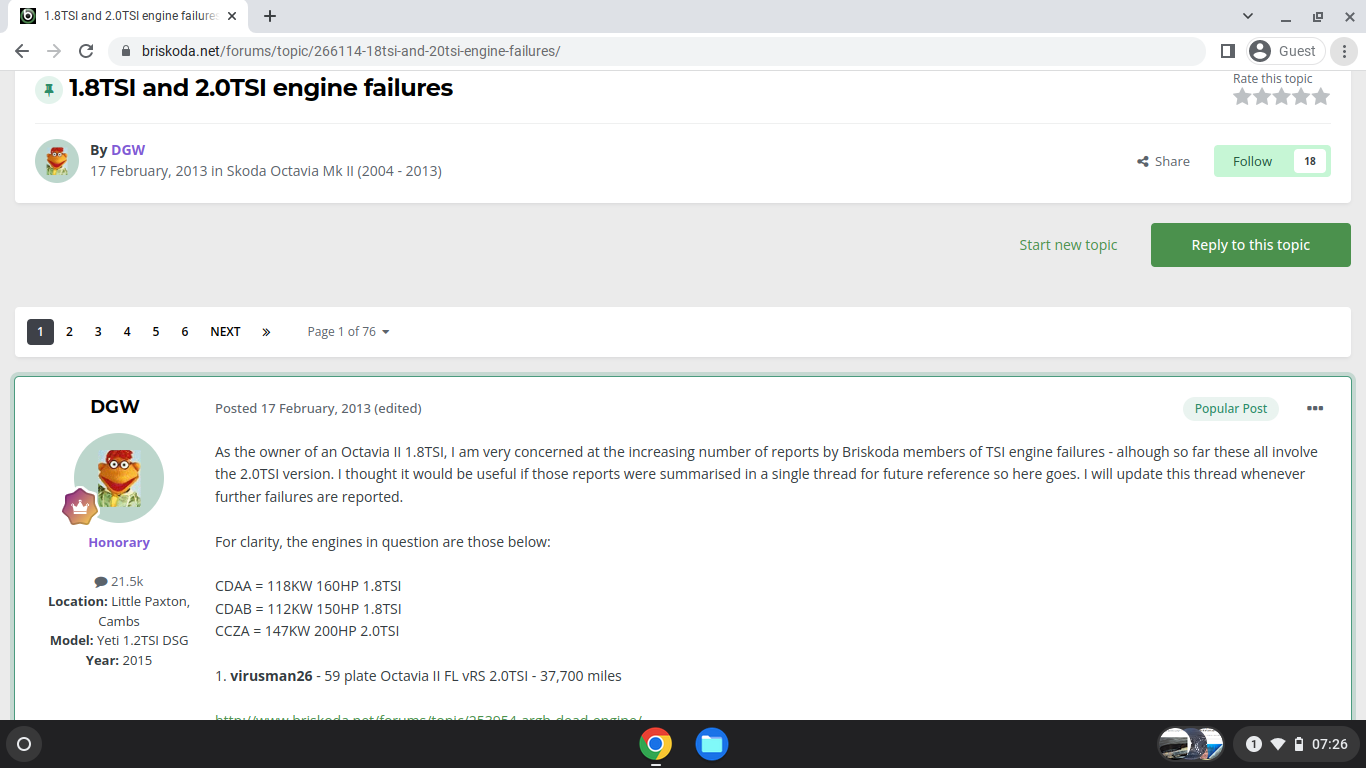

Yes,
you have the issue likely that is pinned at the top of the section. Just an other 1.8 TSI worn out.

Don't understand 'issue pinned at section top.'

The pinned thread at the top of the section is about the early demise of some of the 1.8 & 2.0 TSI engines.
Yours has not had an early demise, but are you sure the engine has not had prior issues, or minor or major work done.
