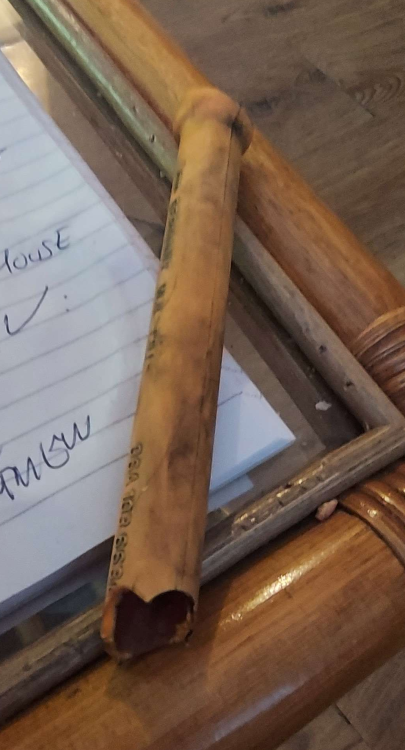

To top off my day i got home and routinely check everything under the bonnet to find this.
This was hanging off the dipstick where it goes into the sump. It was 17.05, I did manage to phone them and they have agreed to replaced this.  When I asked him about it, he admitted he had seen this, but it certainly was not in this state when I last pulled it out.. So not only did he not warn me, I am shocked that the bits may have gone down into the sump.. So all in all I am really annoyed  However the garage have offered to replace it but cannot do it till Wednesday.
I can only assume the bits off the end of this may already be in the sump or in the Pan, so I will not be driving it apart from it going back to the garage, Could this cause damage??

After calming down I checked it over and cannot find any lodged yellow plastic from the oil dipstick housing. so hopefully no damage done.  What amazes me is this garage has 4.5 Review rating has been there 20 years, utterly shocked. Many people may be thinking why don't I do it may myself, but unfortunately without giving a life story + plus not owning the tools or knowledge I dont want to destroy something or go over my head. Meaning an oil change and filter is probably the limitation of what I can do presently. Garages seem to be in a hurry and must have been so ham fisted to cause damage.  They also like to use the excuse that its a 24 year old car and I can just expect these things to "Happen"
