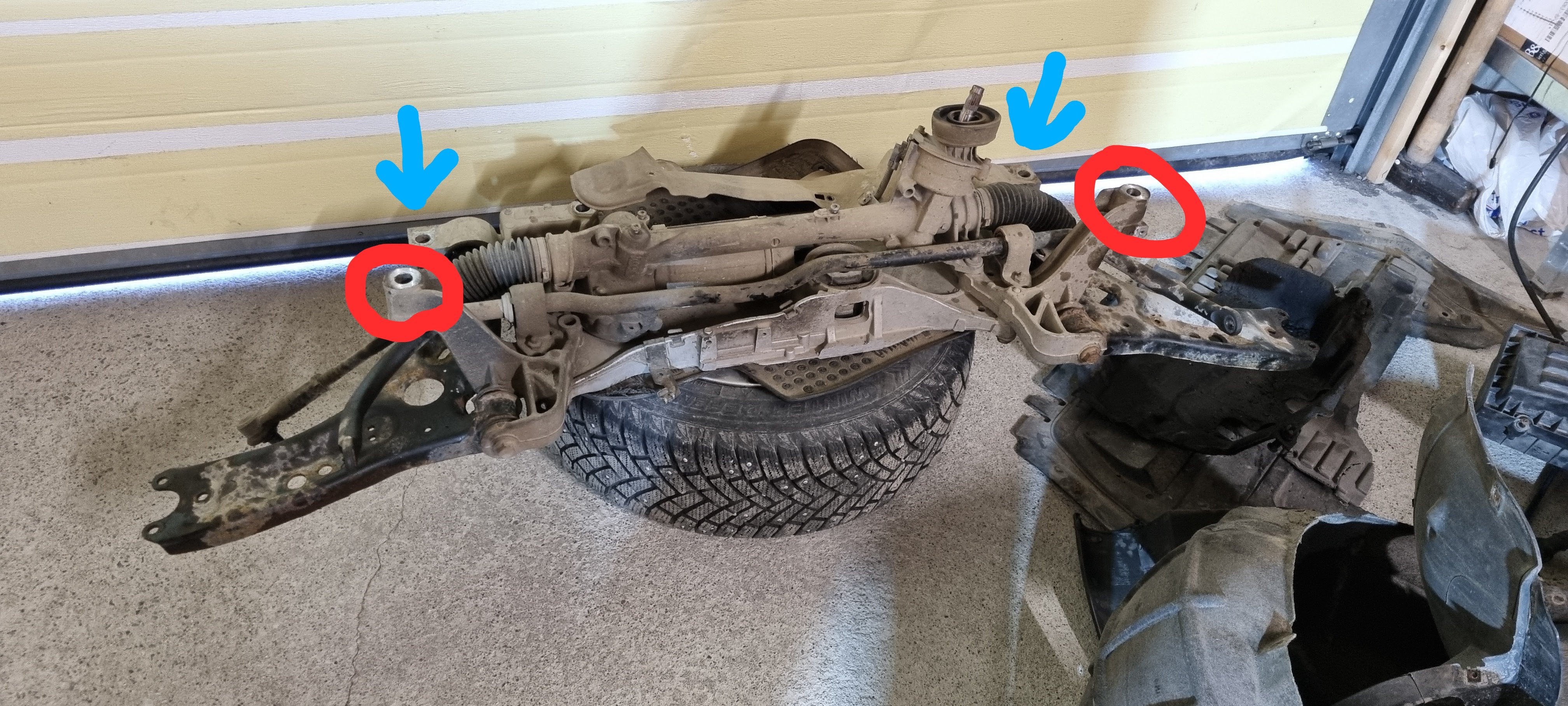

You see one of them here on tis picture.
Need 4 of them in total. One for the lower control arm (big 18mm bolt) and the other through the subframe arm bolted to the frame (also 18mm bolt) on each side.
