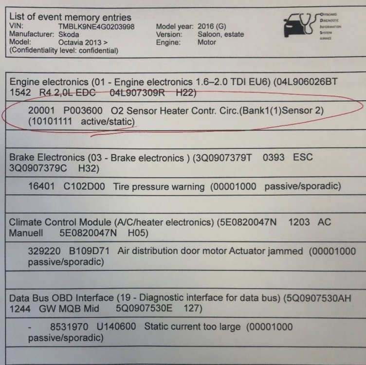

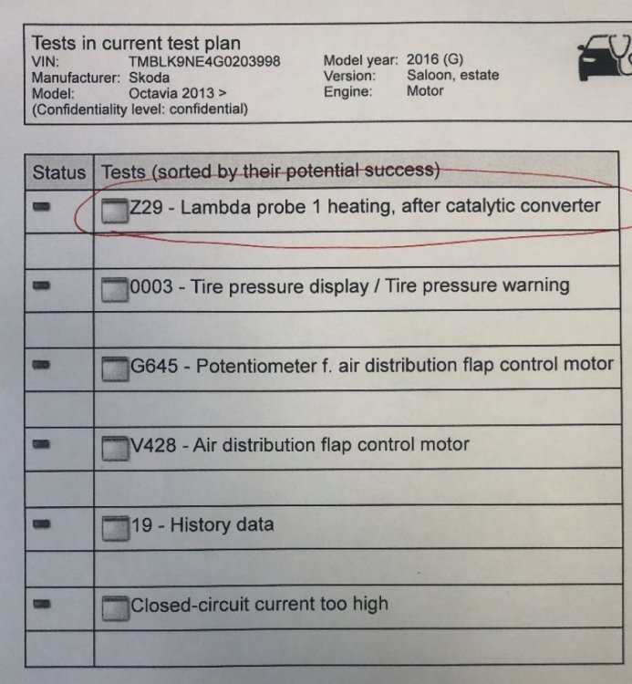

I'll ask them to give me the engine code on Monday, also the failure code witch they got after puting the new rear oxygen sensor in. This company has license from WV factory and use computers specifically to serve WV Scoda cars. Thanks.

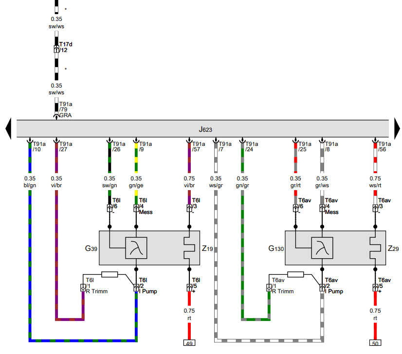

It is a CUNA engine, car was built 24/02/16. Part number of after-cat sensor is 04L 906 262. Is that what was fitted as the replacement? Or aftermarket equivalent?
Your oxygen sensor wiring is as shown here G130/Z29 seems like the one you need to focus on.
The red wires are both fed by fuse 8 in the engine bay fusebox (10 Amp). The black/white wire going off the top of page will not be relevant.
