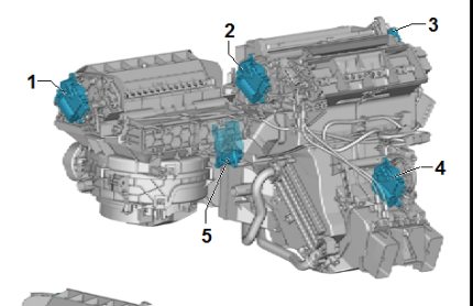

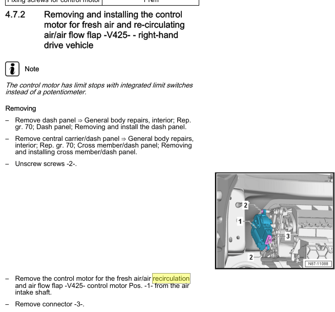

Number one on this diagram. So up and left of the pollen filter housing behind the glovebox (for Climatronic equipped cars)
Thank you. That is more or less the same as what I found on the MK3, so guess it makes sense as the car isn't totally new.
I do have Cimatronic (vRS) and will follow this through next sunny day :)
