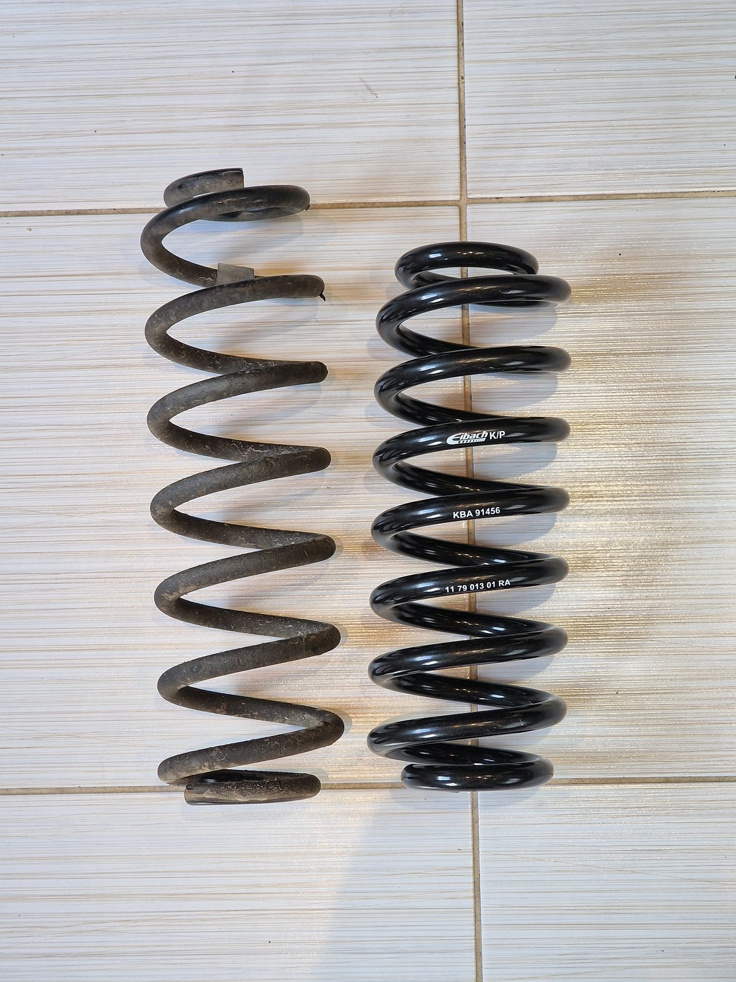

you can't look just to "length" parameter, Eibach have thicker wire
as example OEM vs Eibach Rear springs, where last one give just few mm diff ride height
few measures(mm) - wheel center to the arch
	front	rear
l.	385	378		# 2023.03.01	OEM
r.	390	380
l.	377	359		# 2024.04.03	OEM
r.	377	361
l.	379	376		# 2024.04.29	OEM
r.	381	377
one week after insall
l.	371	369		# 2024.05.08	B6 Damptronic +  Eibach Pro Kodiaq
r.	375	370
