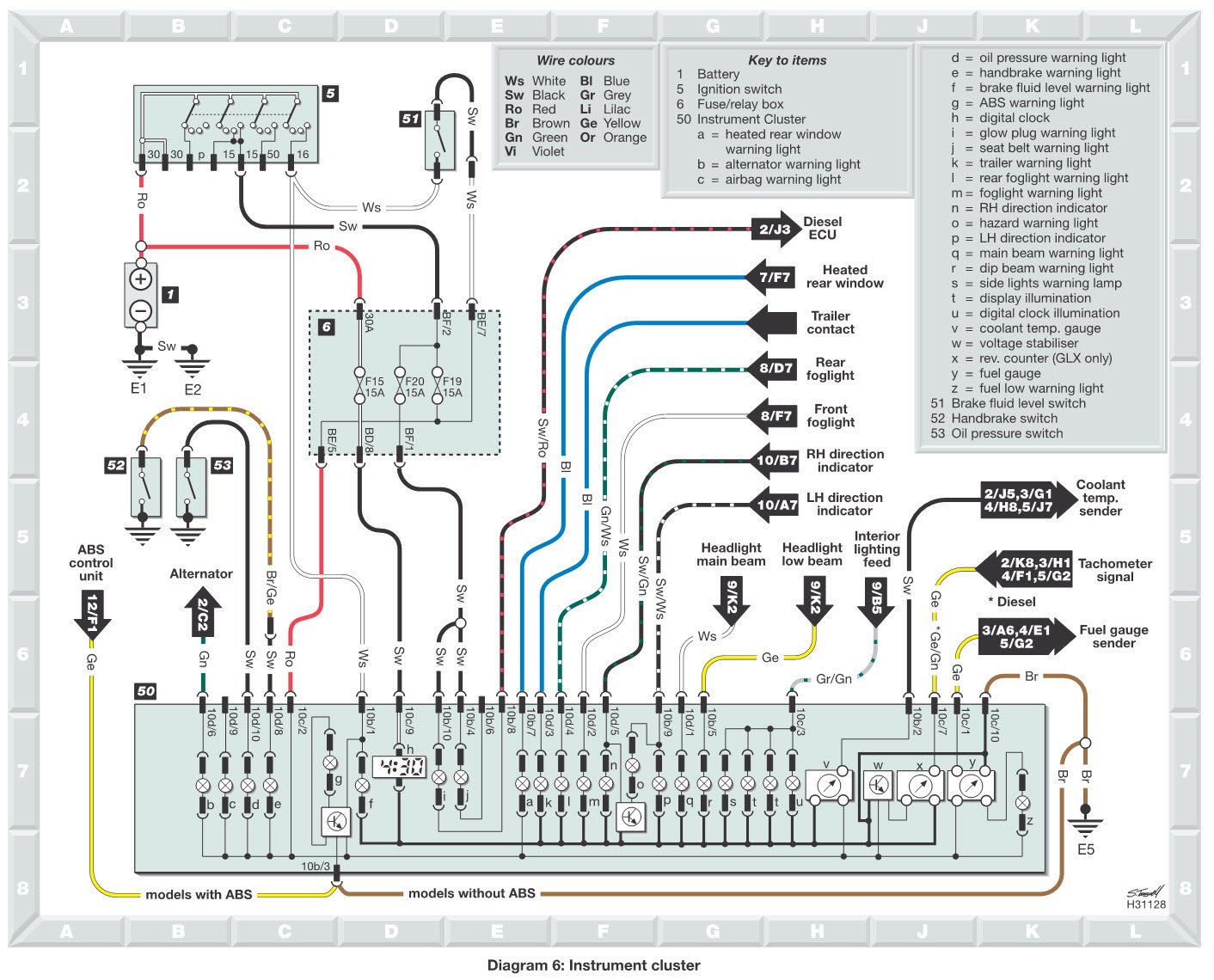

Im doing a 1.9tdi VP 90 in my feli, the engine is in the place but now im stuck in the wiring part. Have the engine wiring and the ECU. Already have the plug for the ECU need wiring scematic of the felicia pickup anyone have that?

felicia pickup 1.9d engine and fuse box wiring
Edited by ChinaBoyZ31
I have also these, Wiring Diagram LX 1.9 (AEF)
Pickup 1.9 (AEF).pdf
Thanks buddy that help a lot
