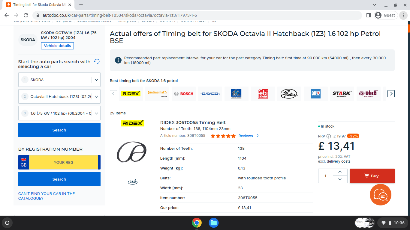

The Haynes manual for the Golf Mk5 suggests every 60,000 miles for all the different engines in them, commenting that VAG recommend 120,000 miles.
Given the age of the car I would change the belt, tensioner and any idlers.
