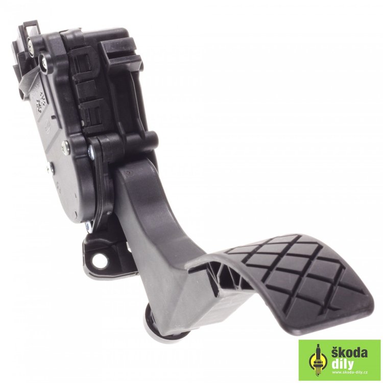

Hiya all. I’ve noticed on the last few longer journeys i’ve done the accelerator pedal has an annoying creak when holding it at a specific position. I can feel it through my foot, so pretty sure it’s the pedal.
I had something similar on my old Fiesta. That had an exposed spring that i sprayed with some grease and it was fine afterwards… after a quick glance though it looks like the fabia one is a sealed unit.
Anyone else had the same? Any recommendations?

My first thought was to give it a good spray with something but I wasn't too sure about any electrics inside. I'm assuming they are drive by wire so will be some sensors and stuff in. I already have some GT85 and you're right on the smell :D think it'll be safe to use?
I checked only earlier this year with WD-40 Company (the invasive Yank corporation that owns the former British company that was GT85) and on second try they replied that it hadn't been tested for such unlike WD-40 Multi-Use but a couple people I know that have tried it have said it's been fine, I'm not sure I've ever used it on electrics because I still have Servisol Super 10 switch cleaner and lubricant but I probably have and would without worrying about it but I'm just some bloke off the internet.  If you use it and it buggers up the pedal and you crash and die do let me know and I'll be more cautious about its use.
Always remember to shake the can first (the instructions are on the label).
ETA: One of my theories is that the thin aerosol lubricant spray can/may wash out debris but that doesn't mean you have to use a lot of the spray, shake the can, quick spray both sides of the pedal pivot, leave to soak in for a minute or two, work the pedal up and down by hand, if creak has gone great if not another quick spray, soak and work in.
You may need more to get the old spray grease out, an old tooth brush bristles might be enough, I don't know I've never looked at the pedal.

I do have some contact cleaner spray, might try a little of that first to help clear. I may have some silicone spray left which should be non conductive iirc 🤔 was hoping this was a more common thing with an internet approved solution.
Pedal looks like this btw

Yes you could try some contact cleaner at the pivot points and if that don't work move on to GT85, even if it does work after you could give the GT85 a quick shake and spray as a longer lasting lubricant.
Thanks for the photo say going into the dark hole of the footwell looking at black plastic against dark carpet on my knees.
