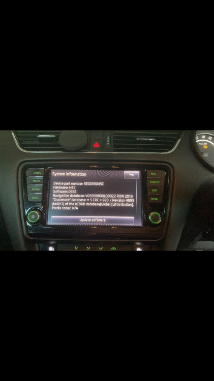

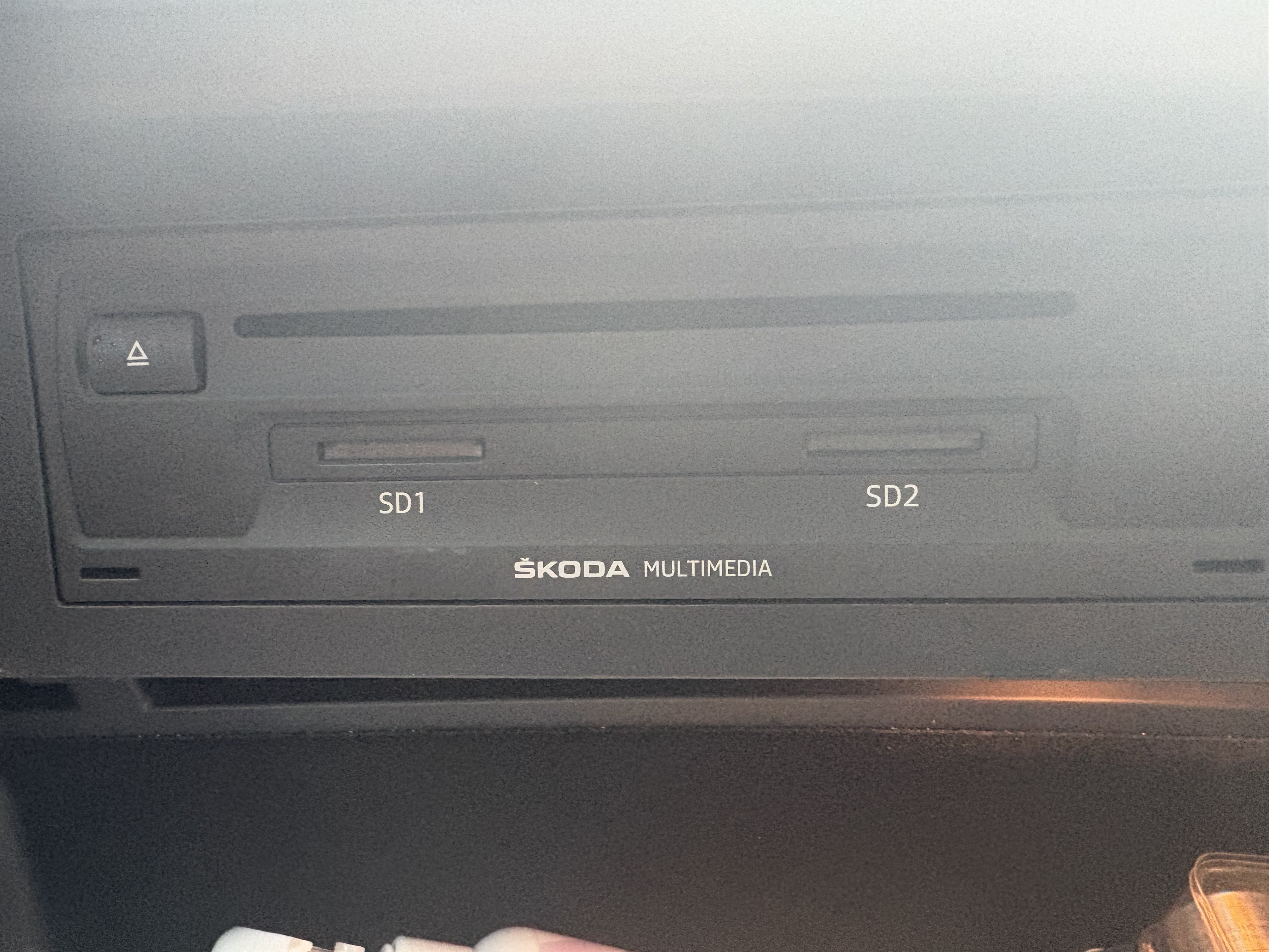

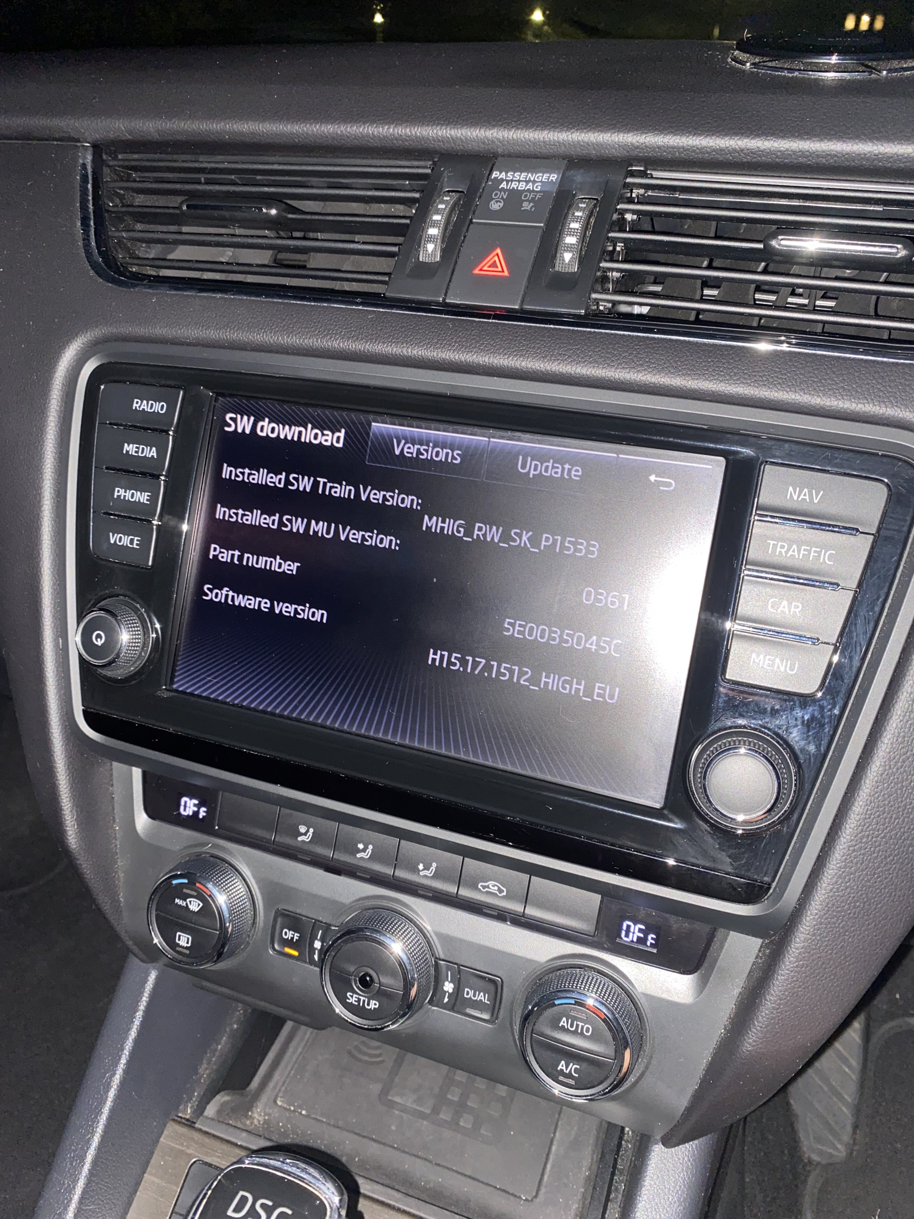

Hey @pab567
Keen to please have details on Apple car play unit upgrade
I have model 5E0035045C
See images below
Really just want car play
I would pm but I am a new member
Cheers Dave
PM sent
