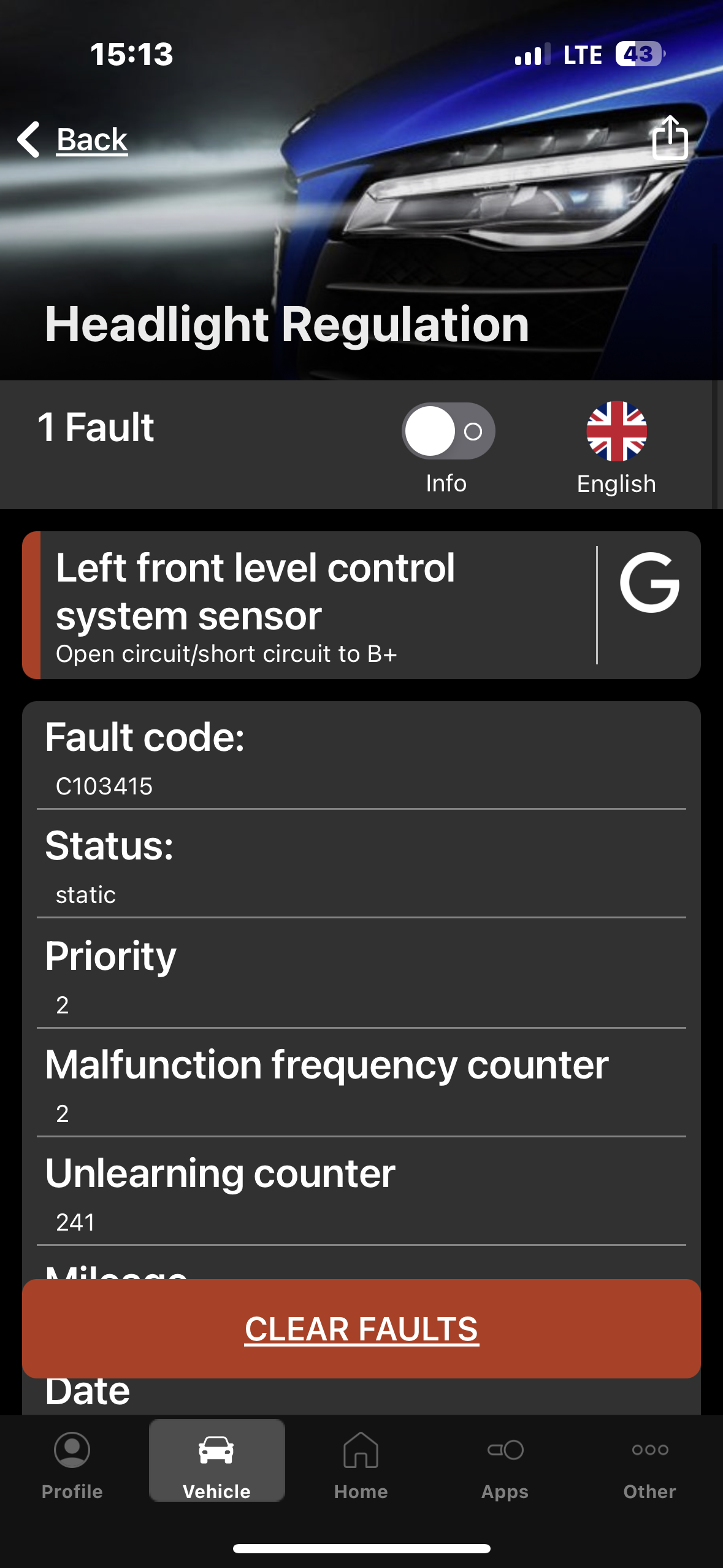

I also hawe a scaning screenshot from obd.

Find the left front level control system sensor and check for broken wires.
