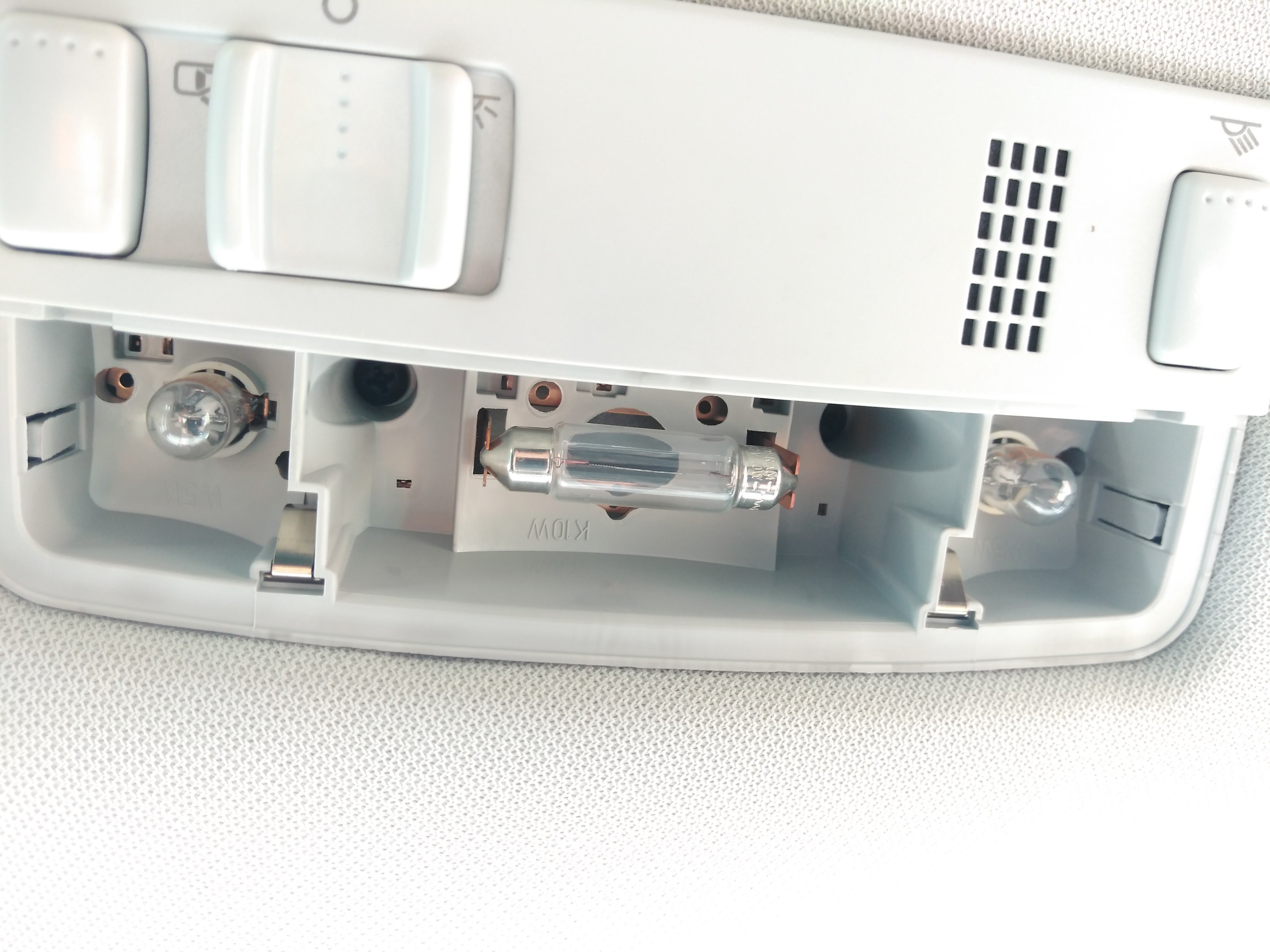

Hi, I've identified the centre bulb as a 7576f festoon bulb, but I can't identify the others easily. Does anyone have the number handy?
According to the parts cattlefrog HERE they're item #12 - W5W-12V5W.

Can the 10W socket fit a 264/265 bulb? Looking it up the part numbers and results are all over the place.
If you don't have a a hand book you can download one for your model year from the sticky posts at the the top of this section.
The hand book shows, in the fuses and lights section:
front interior lighting C10W
Reading lights W5W (as posted by Mike the Thinker)
Rear interior lighting C10W
