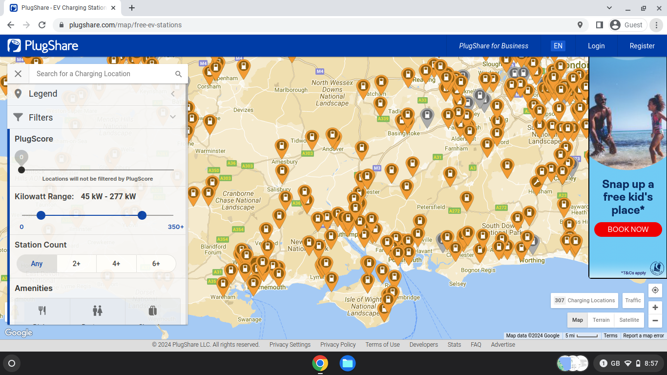

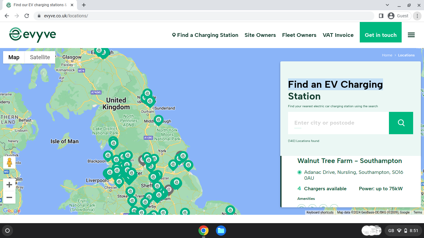

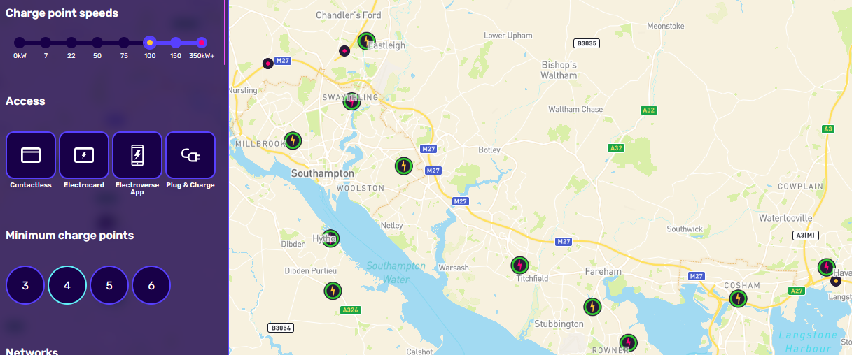

Not 'much cheapness'  but i have found these handy and with EV,s with 100 kW max charging i got the 75 kW for quite well into the battery charging.
