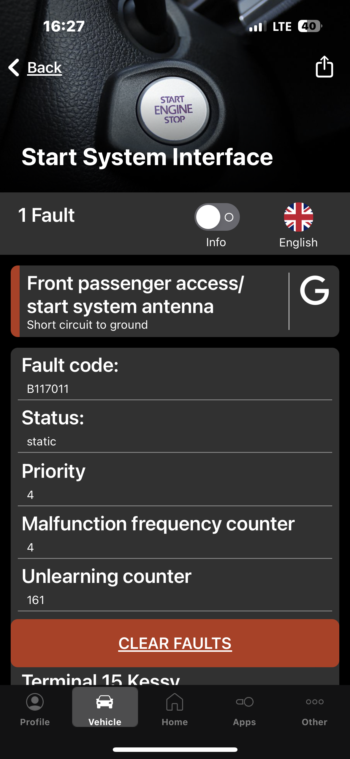

today on my display come up -keyless error mind driving and beeping every 5 secounds.
what is this now know somebody here?

Where is keyless antena in superb?  In handle? Or behind the door panel?
There are 1 in each door handle, one at the tailgate and one under the centre console.
all depends what’s actually faulty as that fault description isn’t too specific
