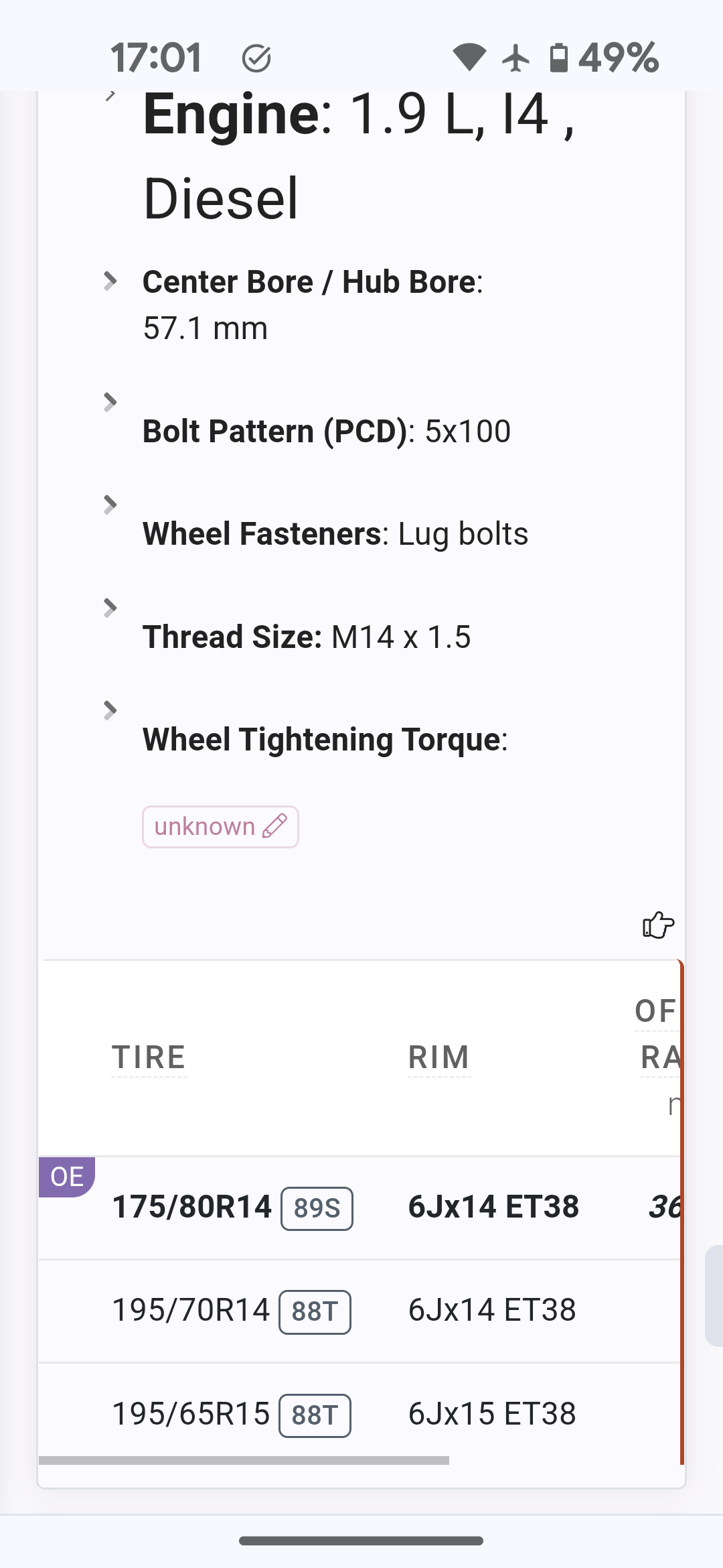

I'm wondering if a seat Ibiza or a golf 14" wheel will fit my Octavia SDI MK1, I think they should. They are 5 stud wheels also. Still have the original wheels on & thinking 1 is getting ropey.

Good morning Ewan, probably will but it depends on the bolt PCD and the centre bore size - there are two sizes.

If the Ibiza or Golf are similar years to the Octavia, pretty sure to be same.
Ibiza, Polo & Fabia are not the same as in 5 x 100.
 I read on the many websites that shown Octavia Mk1 that they were also.
Hi, found them sizes for the car wheels so will just have to wait till l get ashore but will keep looking for wheel less than £50 quoted from scrappy.

If you're going to use 195/70R14, consider 195/65R15 instead because it's a much cheaper tyre size and there's a much bigger choice of tyres.
Alcar 7760 6Jx15 ET38 5/100 57.1 steel rim (from Polo MK5, Ibiza MK4, Fabia MK3) (8.02kg)

Also consider the 5.5Jx15 ET40 5/100 57.1 (from Polo MK6, Audi A1, Ibiza MK5, Fabia MK4) because it's much lighter than the 6Jx15 ET38 5/100 57.1 steel rim...at just 6.6kg.

As you can see in the chart below, a 195/65R15 tyre size can be fitted to a rim width between 5.5" and 7"...hence there's no problem fitting the 195/65R15 tyre size to either of the above 5.5J or 6J steel rims.
ETRTO approved rim widths for passenger car tyres
195/65R15 5.5-6.0-7.0
