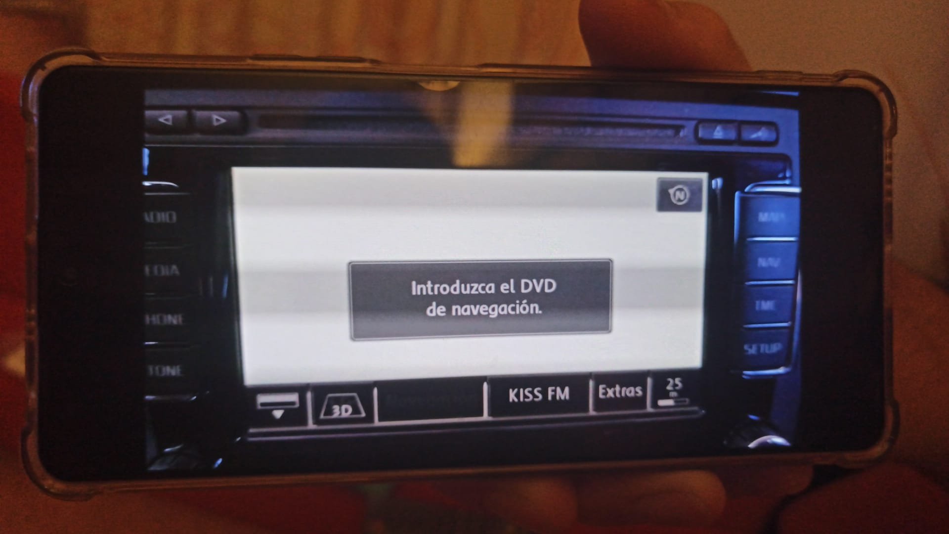

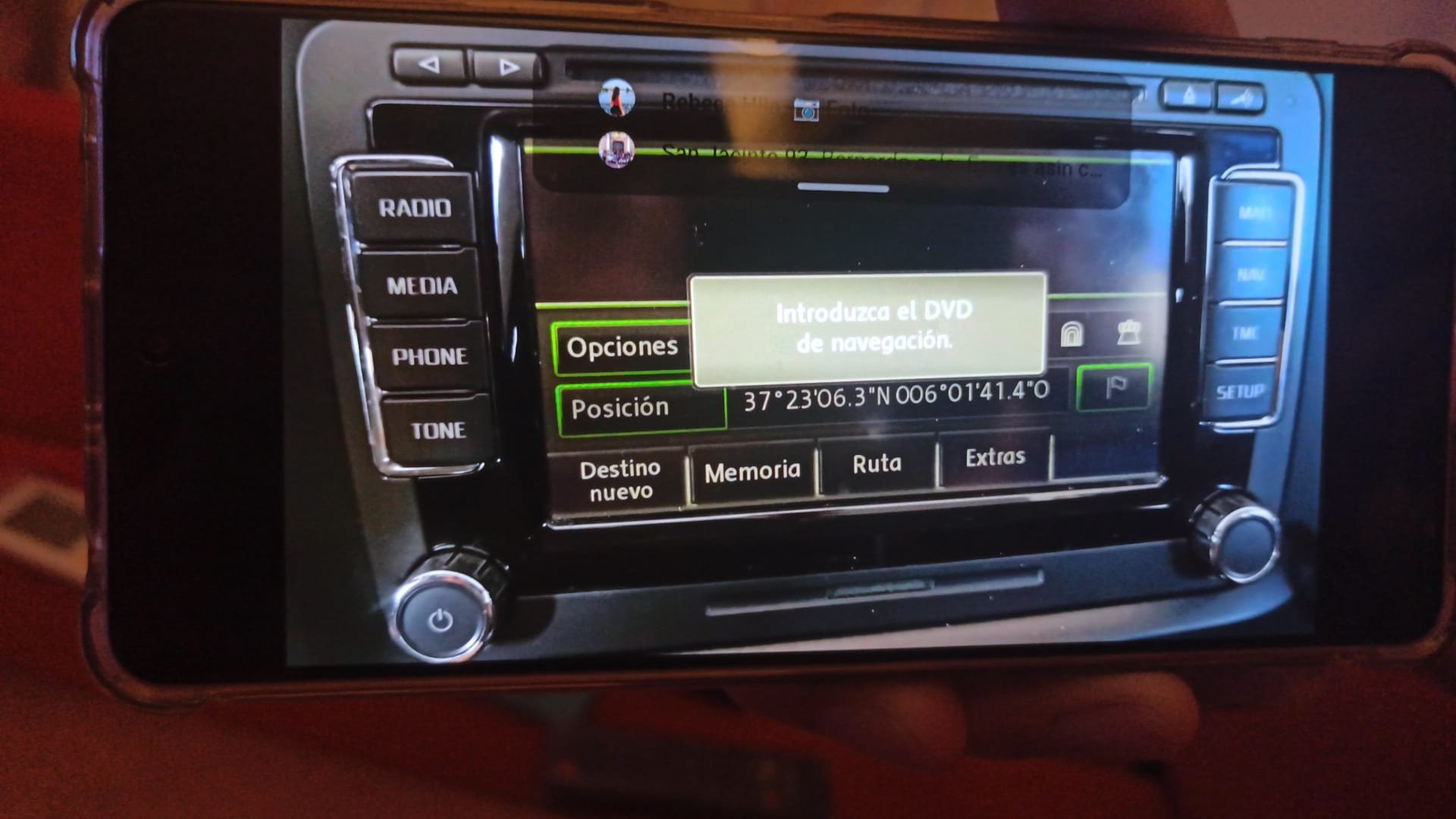

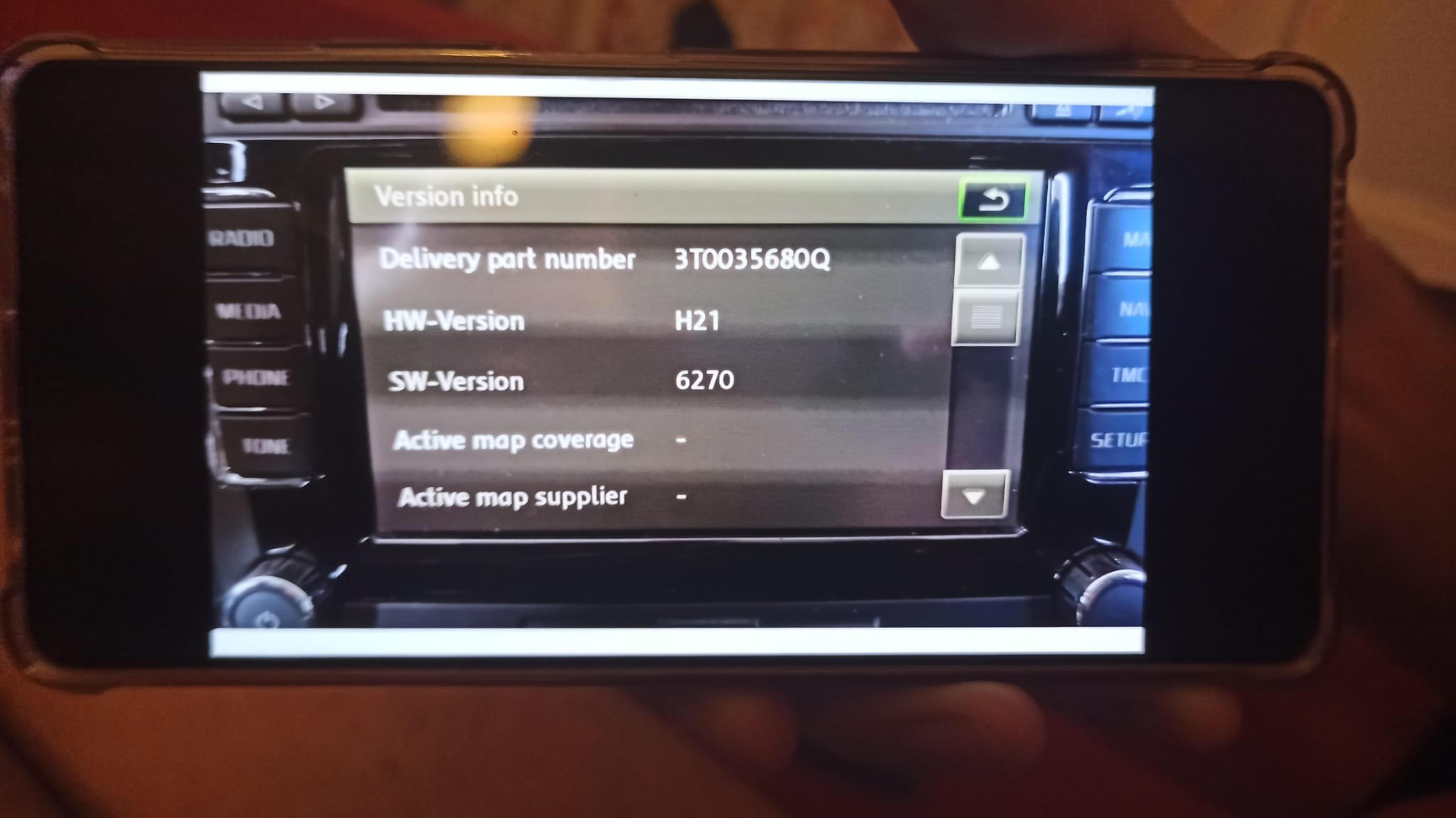

Hello, I have a Columbus radio, but for a few days it has been asking me to insert the navigation DVD, and I don't have it. Does anyone have the .iso image of the DVD I'm asking for?
I indicate the information:
Delivery part number: 3T0035680Q
HW version: H21
Firmware version: 6270
Active map coverage: -
Active map supplier: -
Thank you so much
If you had maps on disk drive then probably it is broken or corrupted... First of all, upgrade firmware to 6276 - I will send you link in PM - and then install maps from DVD (I beleive you will get some link to the image)
Burn firmware image on CD-R, not DVD-R
Thanks a lot.
Indeed it seems as if the maps have disappeared, even the Active Map Coverage and the Active Map Suplier are empty.
I have downloaded the firmware .iso and will burn it to CD-R. Please do you have the installation instructions?
I don't see the link to the maps for Europe. I live in Spain. Can you give me the link and also tell me how to install them?
You are being very kind, my father is a Taxi Driver in Seville and his job has been complicated without navigation.
All the best
Burn the image, insert disc with unit on and ignition off, it will start the update automatically. Update takes approx. 45 minutes. However, if the disc is broken then SW upfgrade may fail and then you will need to replace it. Your unit is equipped with 30GB or 32GB IDE SSD 2.5" drive. It's not easy to find a replacement but you can use also bigger disc, e.g. 128GB (this is the cheapest one I found on ebay). Replacement is not very hard but will require the unit to be completely disassemblied.

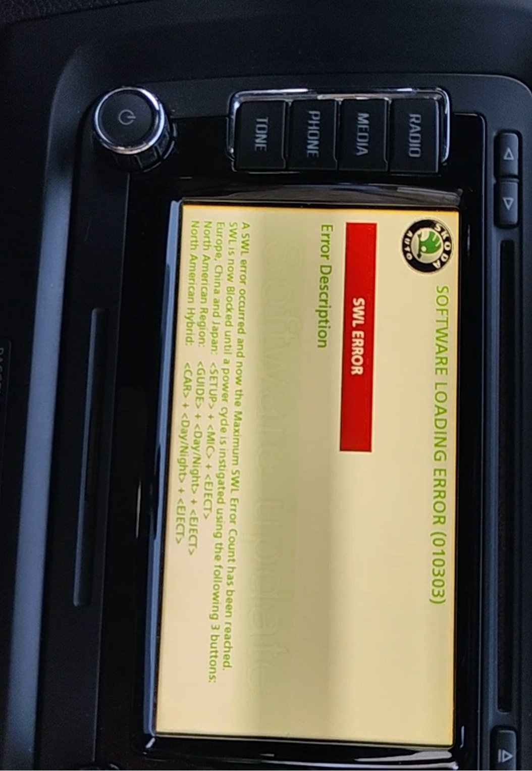

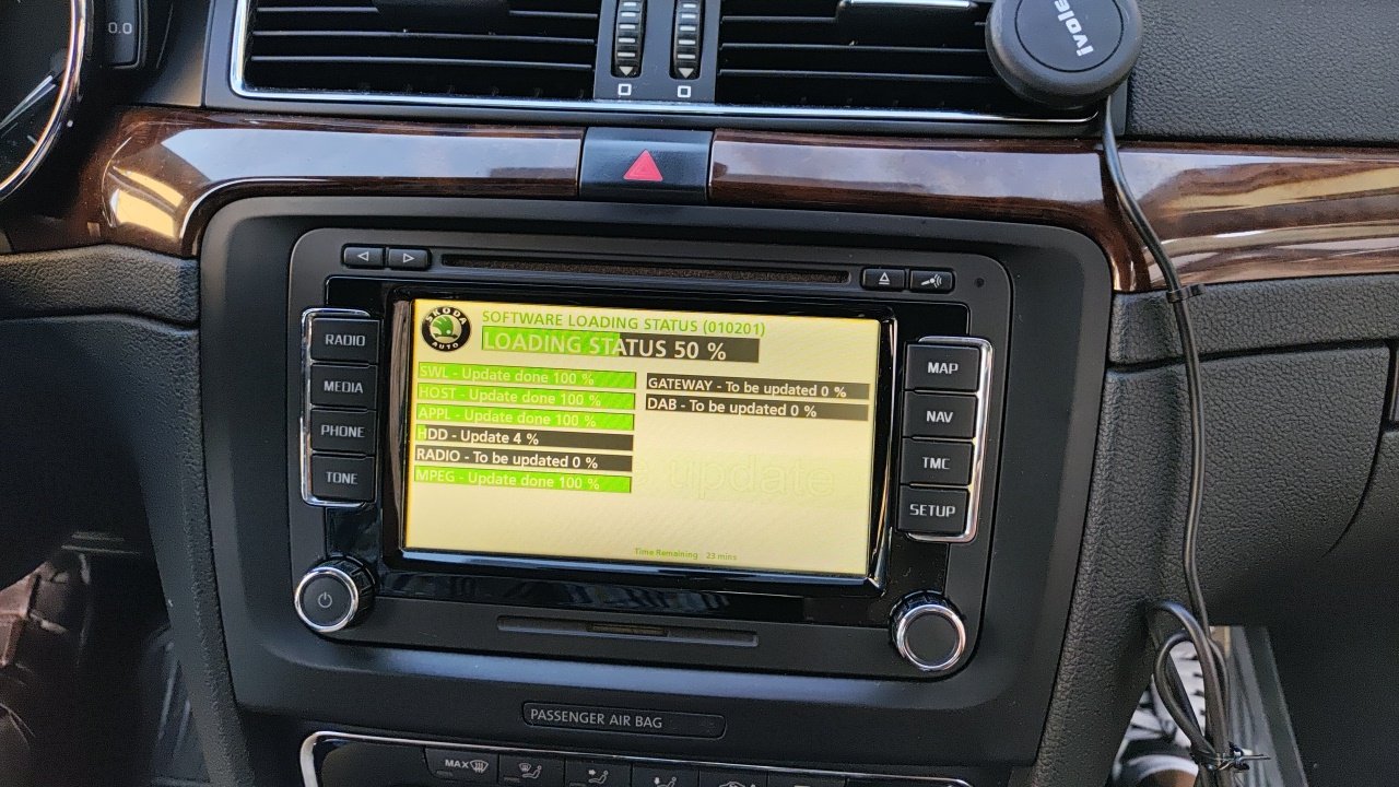

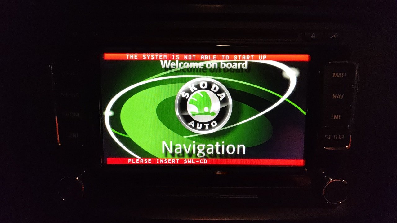

Hello, the update didn't go well until it froze in the HDD section at 4% and it rejected the CD.

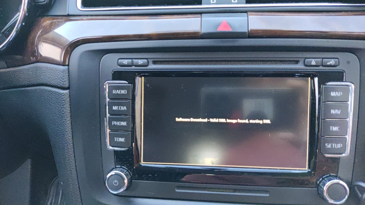

I'm scared, now there is a black screen saying Software Download - Valid SWL Image found, starting SWL. It's been like this for more than 39 minutes and without the CD inside. Help me!
Now systeM say "THE SYSTEM IS NOT ABLE TO STAR UP".
Do you have any recovery cd?, or do you know what cd it is asking for?
You have to replace SSD first then just insert the CD-R with SW burned

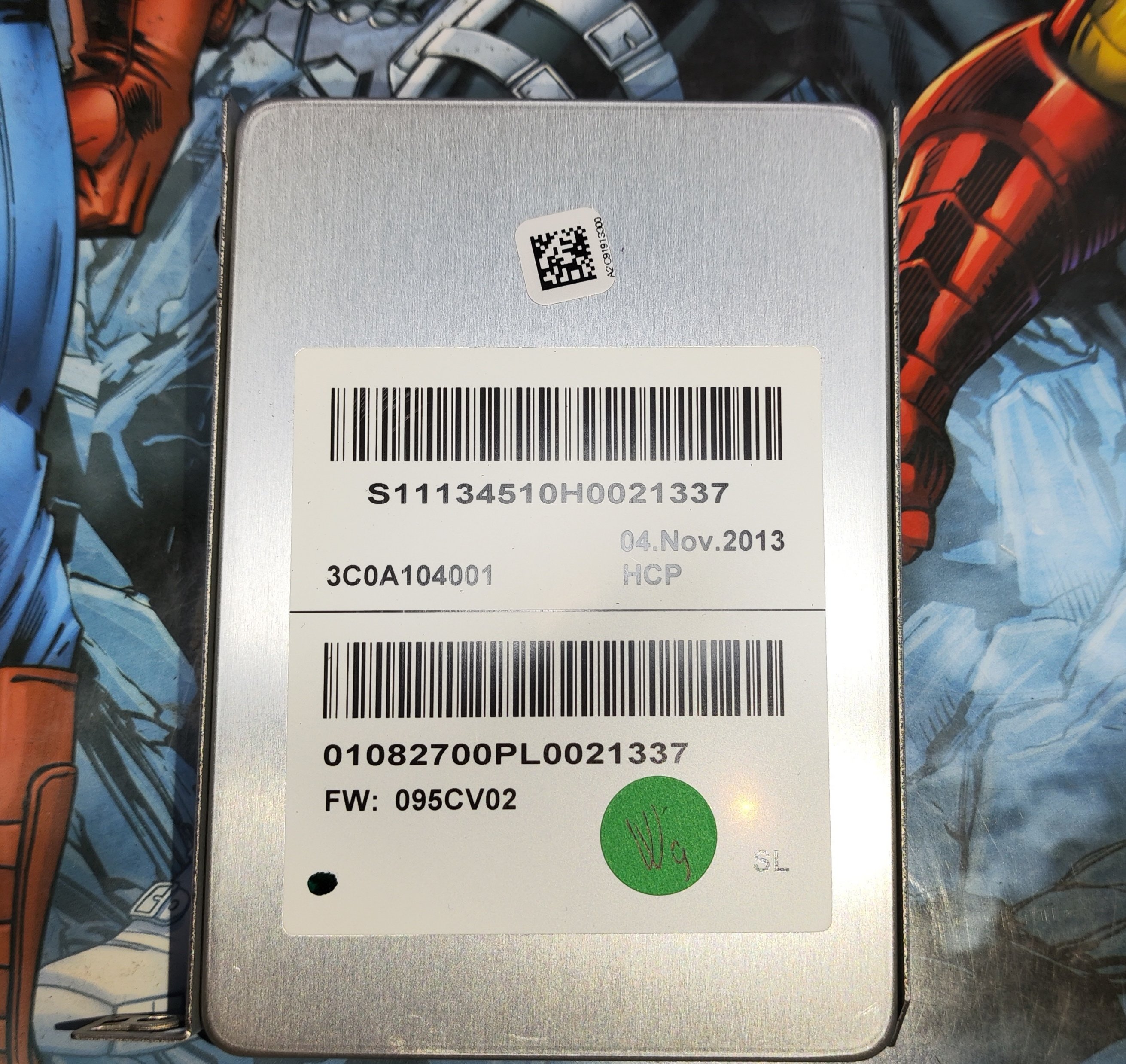

Hello, in a few days I will receive the new 44-pin 64GB SSD and i try again.
I provide the photo of the original hard drive.
I will report on the progress with the new ssd pata 64gb
Thank you.
