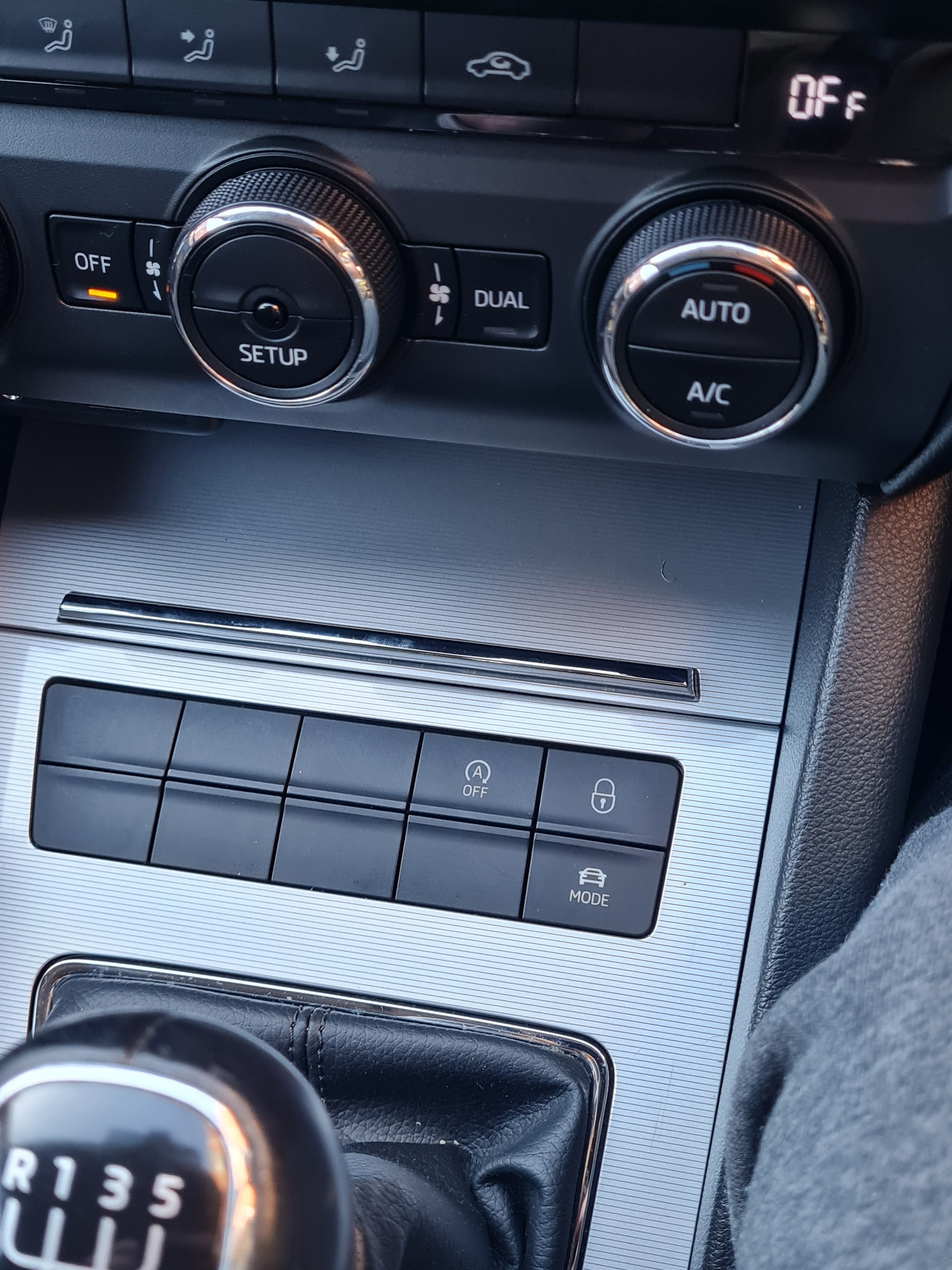

No error on screen that I can see only have 3 buttons near hand break20240806_082748.thumb.jpg.106eca1f4a642f9249a51f0a7b1b9ac3.jpg
