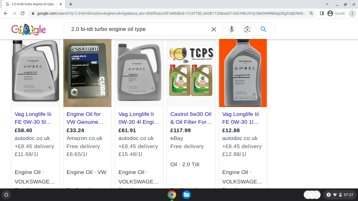

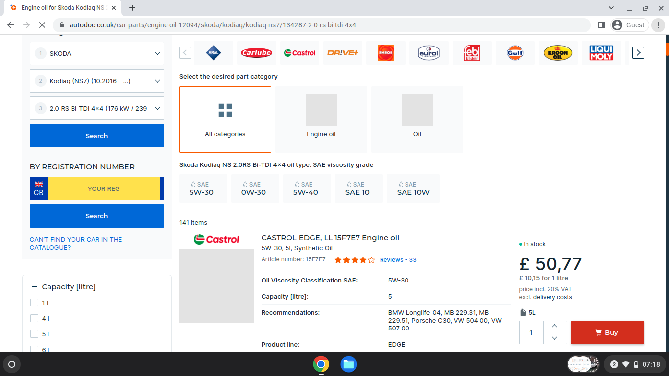

Is there no reference to VW508 00 / 509 00  so 0w 20 FS IV for fixed or Variable servicing.      the VW509 00 being for a TDI.
(As VW Group went to in 2018 for getting WLTP results for Certification.)
Then it can be VW504 00 / 507 00,
  0w 30 FS III or 5w 30 FS III,   VW507 00 being for a TDI.   Fixed or Variable / Flexible Service Regimes.
