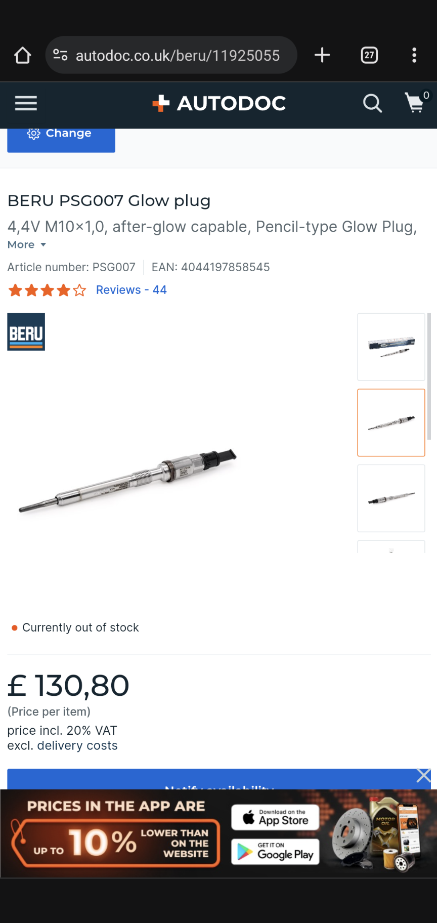

I have the error code for glowplug #3 along with the warning light.
I am trying to order one but struggling to determine which one is correct.

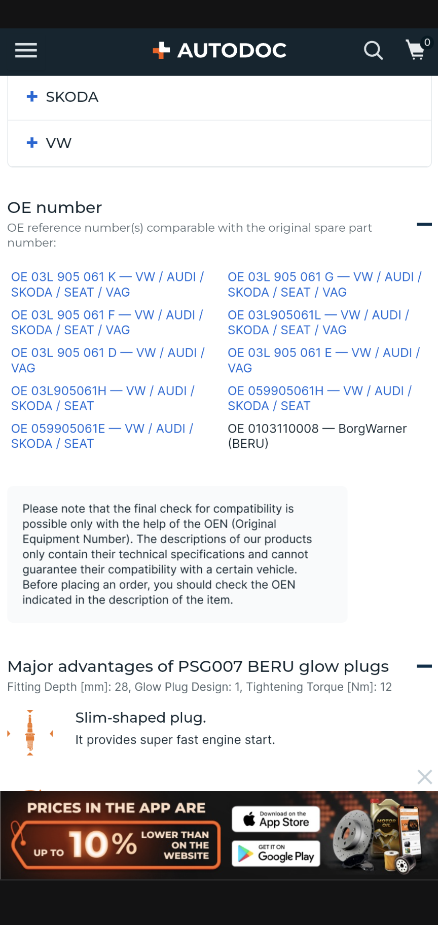

They all seem to start the same
03L 905 061 K but then have different letters at the end. EG the K or L etc.
I have a 67 plate 2.0 superb 150ps
I can give reg plate if needed.
Is the 03 one correct or is one which starts with 04 as I've found websites which give me that one.

Ring your local Skoda dealer and ask them for price and confirm part number, better to be sure
Hi Mat,
Had exactly the same issue on my Sportline 67 plate.  It ended up being that expensive glow plug (no. 3) (with pressure sensor?) but was fixed under my Skoda Warranty at a dealer.
