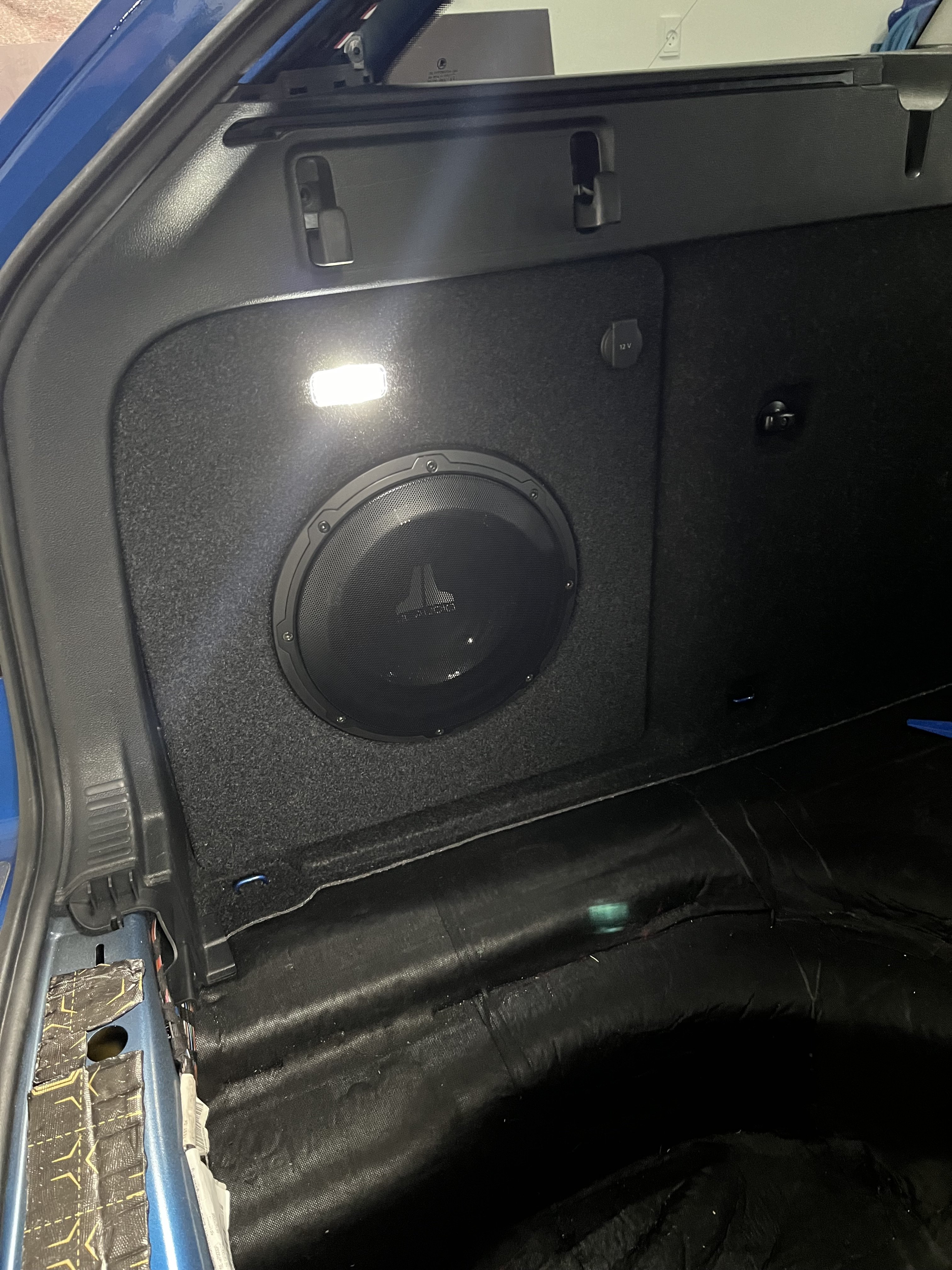

I wanted an upgrade that was small but still with a great sound so decided on a Match M5.4DSP amp installed in high power mode and a 10” sub in the familiar Basser subbox that goes in the left side of the trunk. I looked at various subs to go in the box and I decided to with the JL 10W1v3-2 as it fit the box volume and suits the amp well.

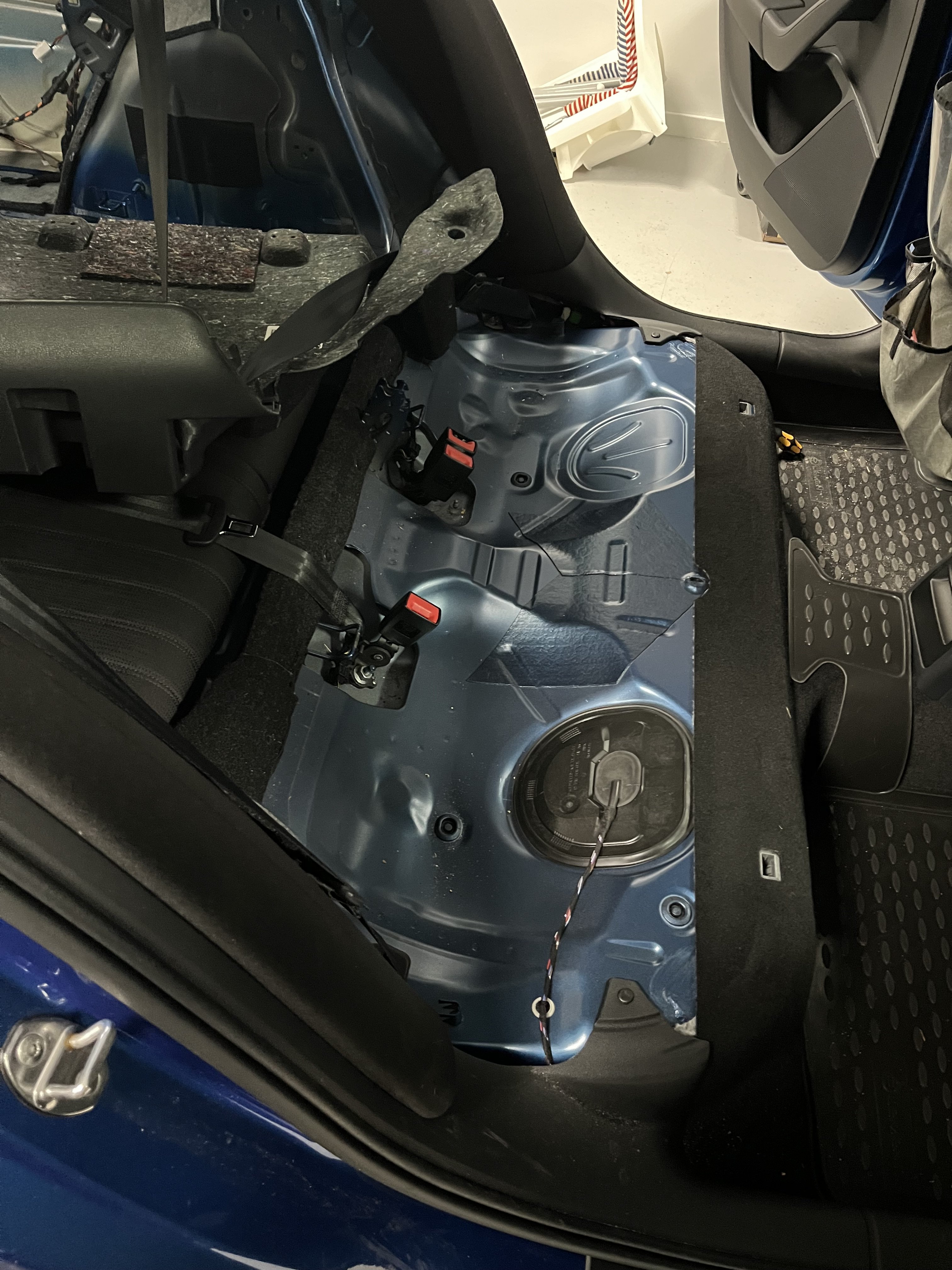

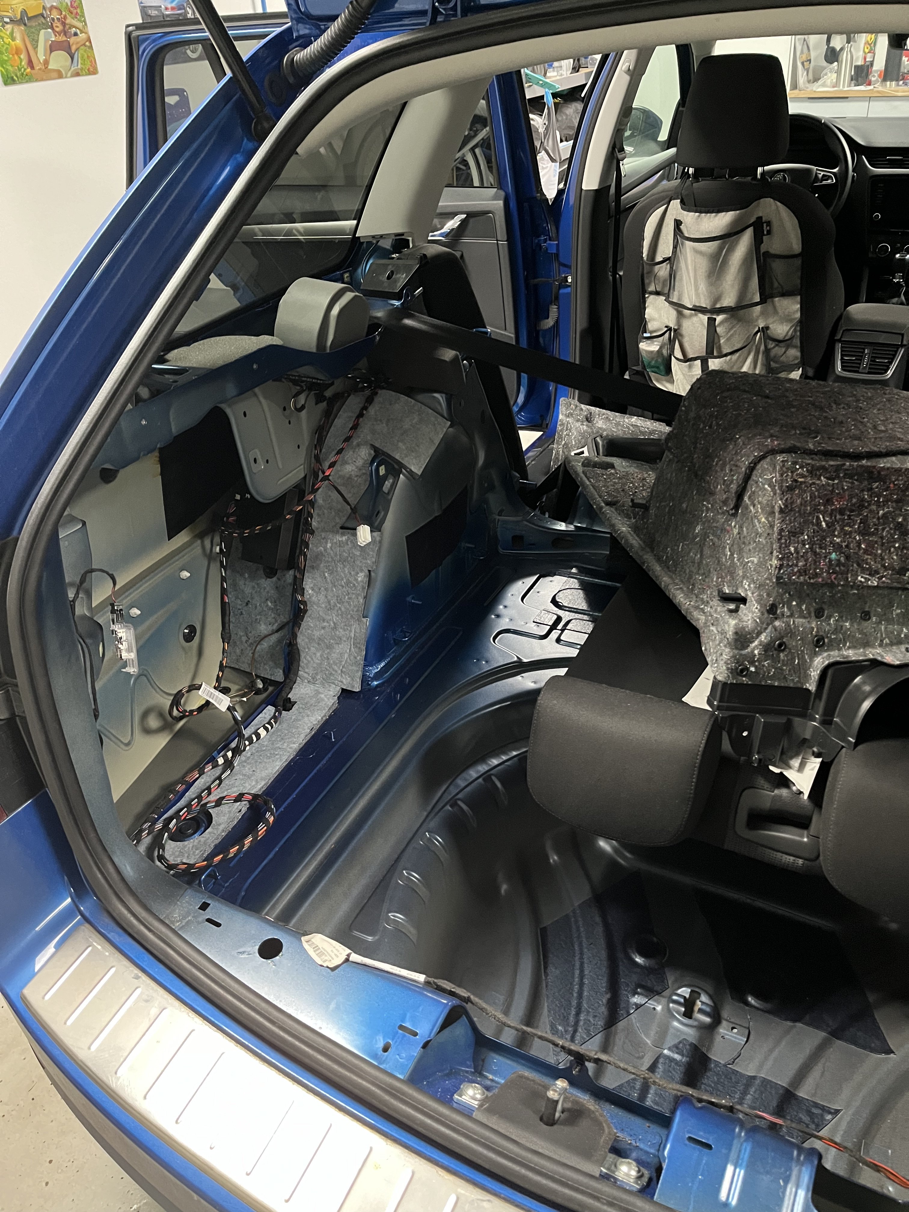

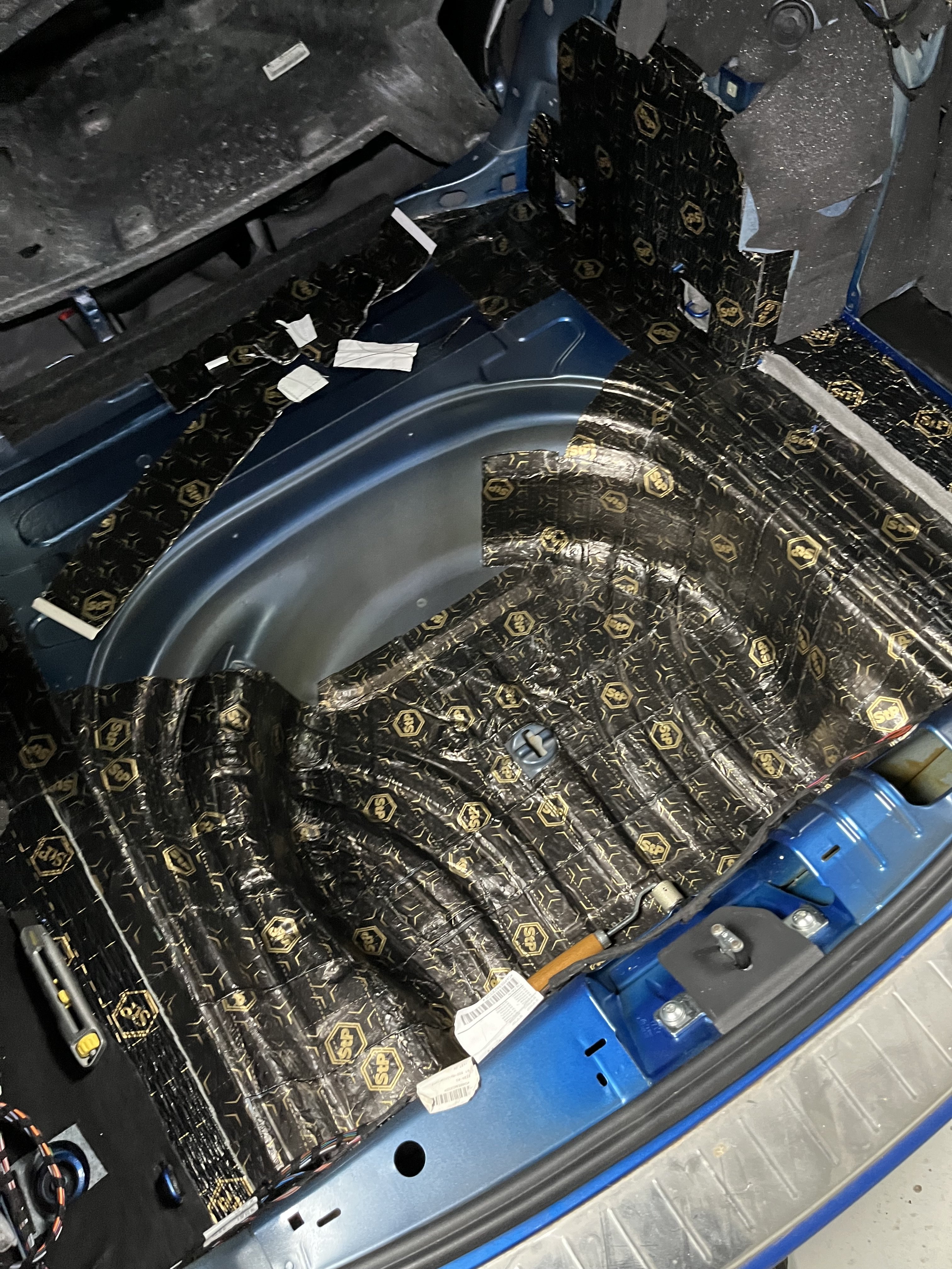

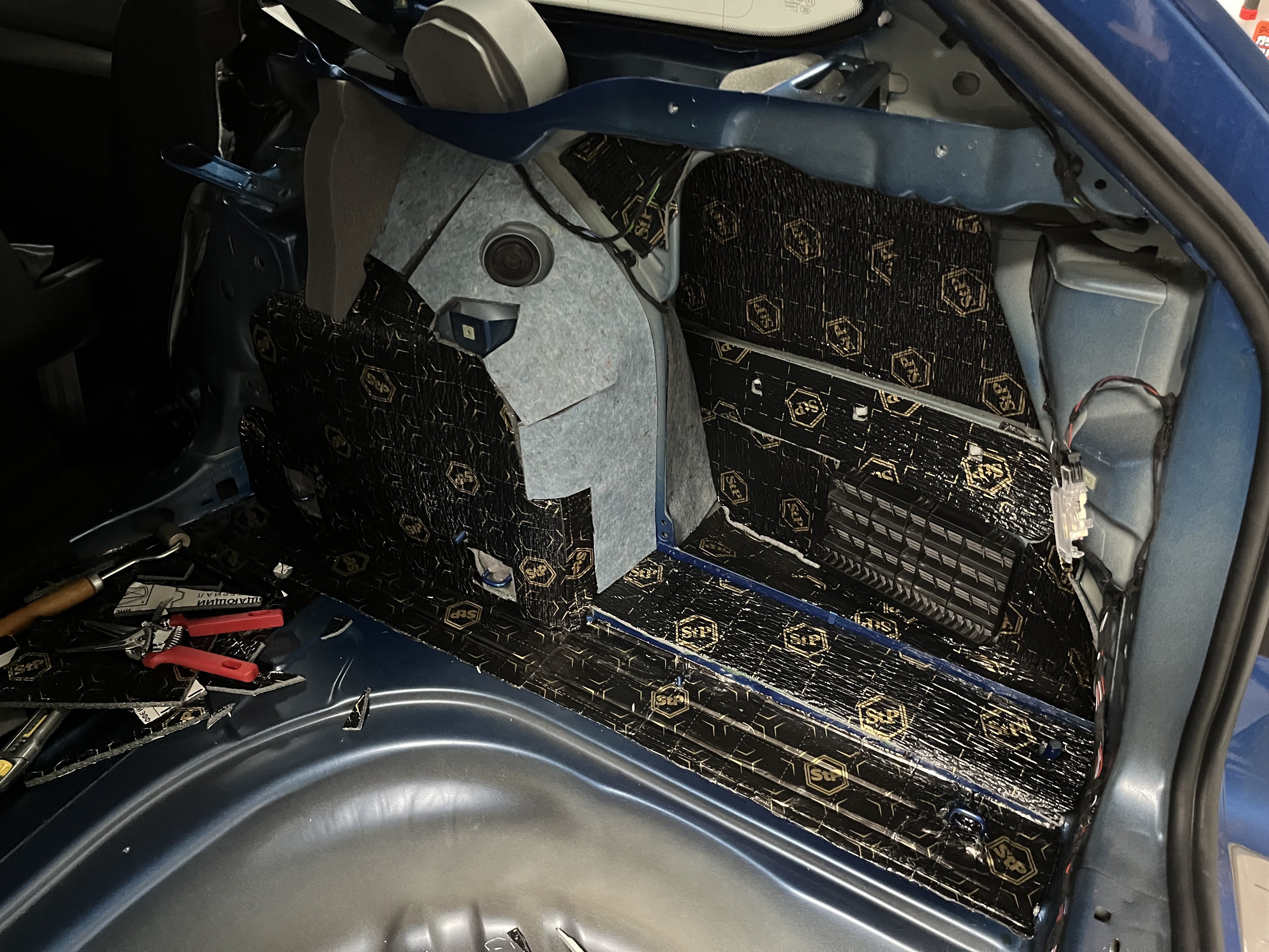

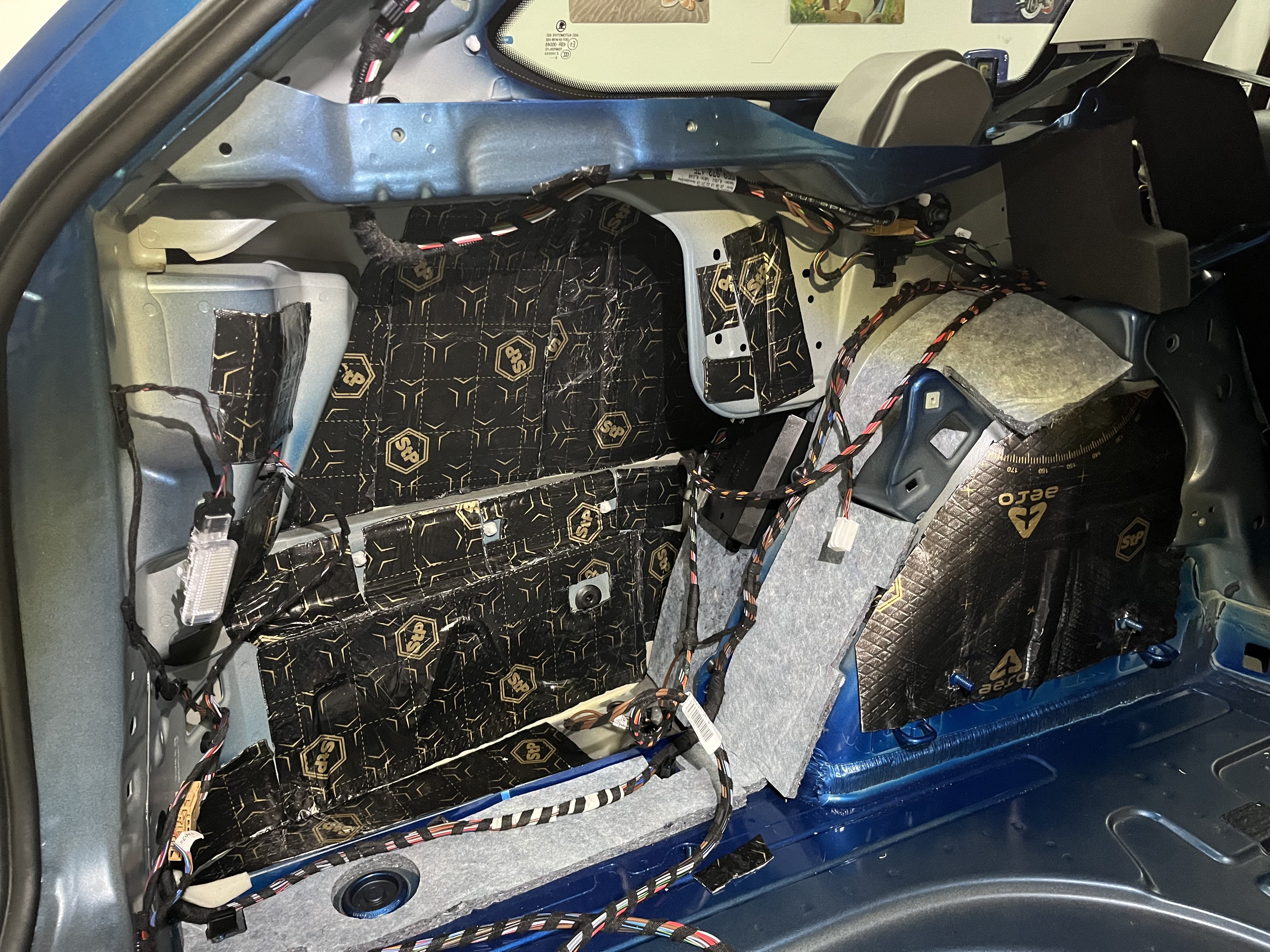

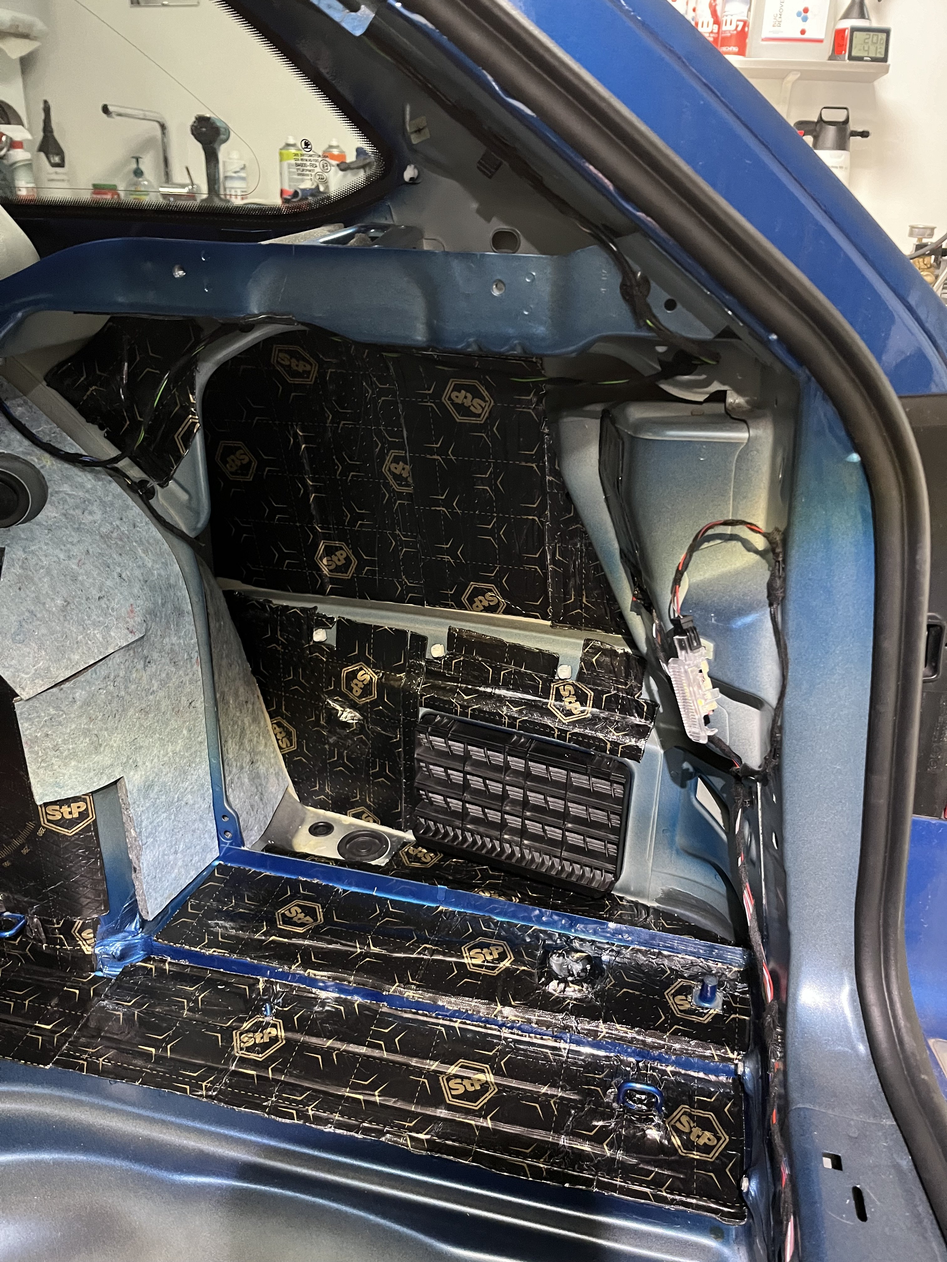

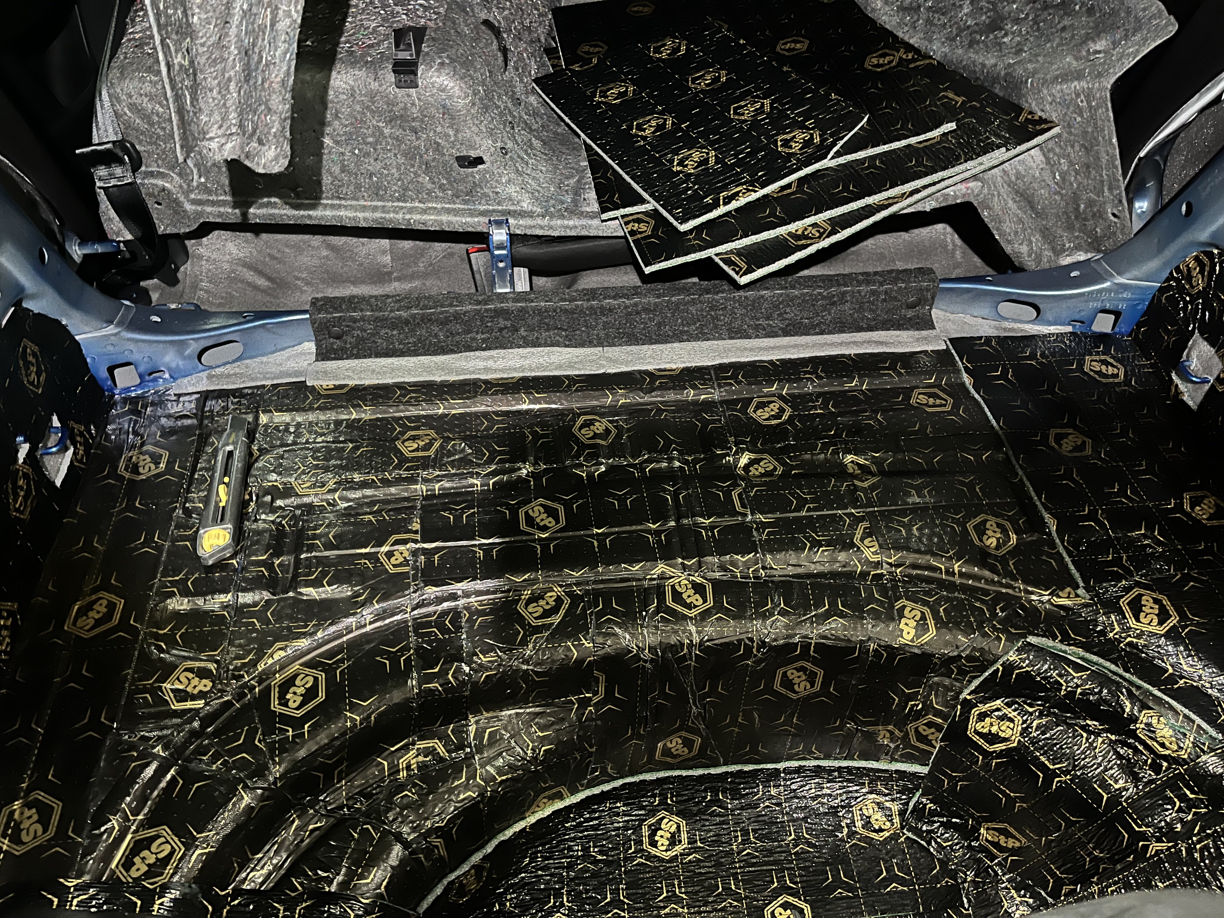

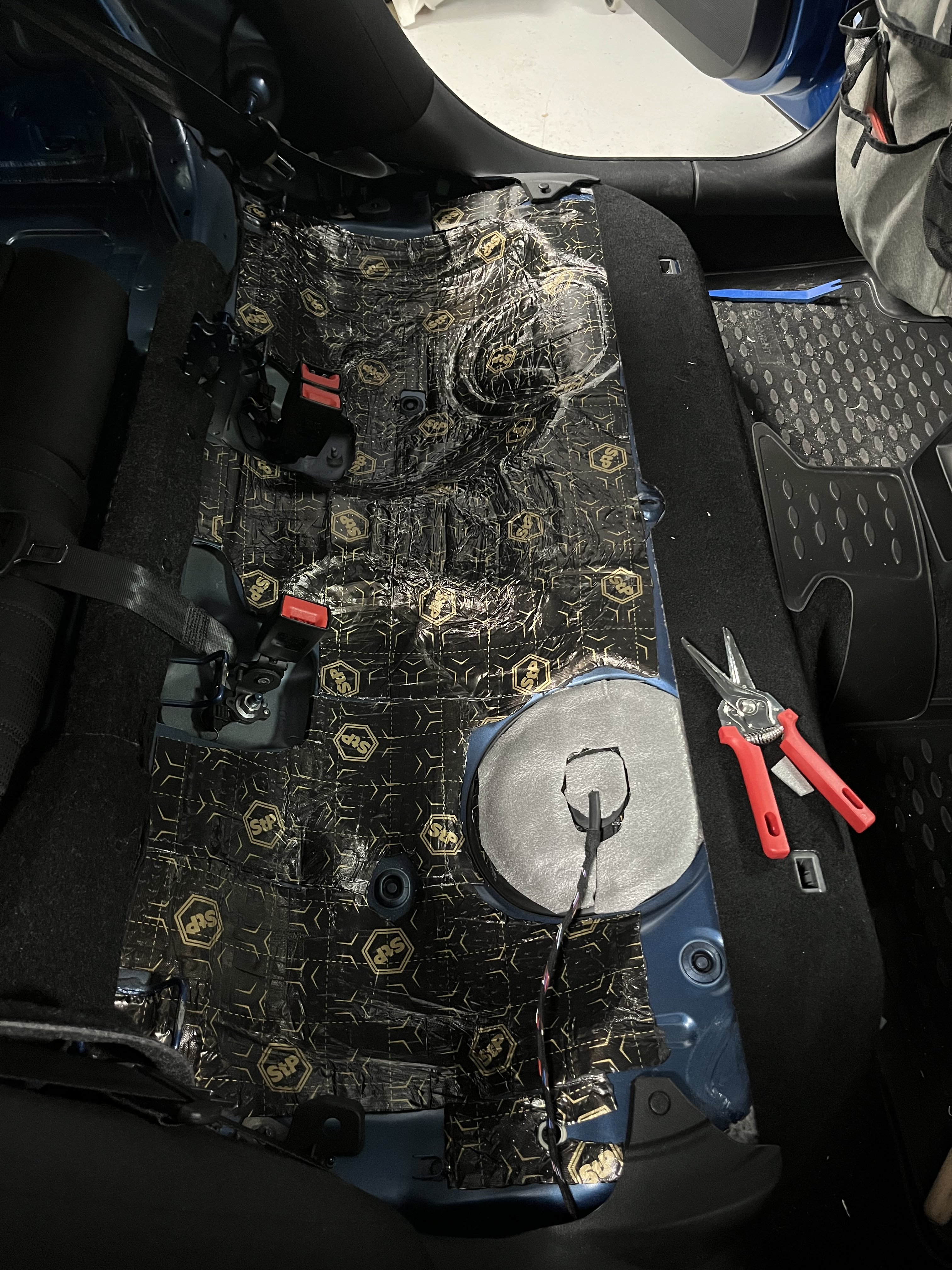

I mostly used 3 layers of damping. First layer is vibration damping butyl 2.3mm, second layers are sound insulation 6mm or 4mm in places where space is tight and third layer are noise absorbing 5mm or 10mm.
There are places where I only used 2 layers, under the back seat i used 4mm insulation on top,of the butyl. On the trunk floor i used Mass Loaded Vinyl as the tird layer.
