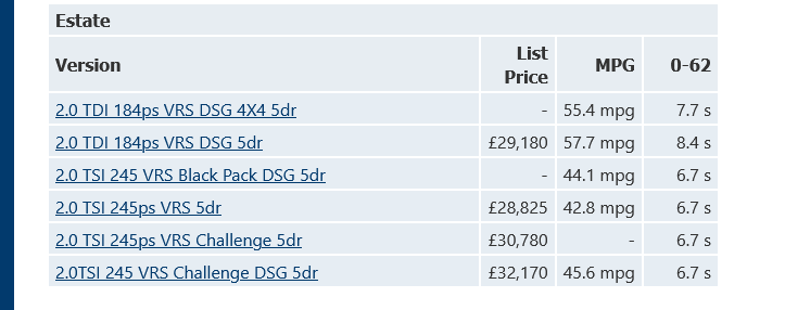

Well with 45 litre Fabia MK2 tanks you could get in over 50 litres and see the petrol and then vent it and get more in. So as it is. Different strokes for different folks in different models.   As it is a driver with a daily driver should pretty much know about their car.  If paying attention.
Screenshot2024-09-04at11-06-40SkodaOctaviavRS(20132020)ReviewHonestJohn.png.069188f091a7617c67d312b465da56ad.png

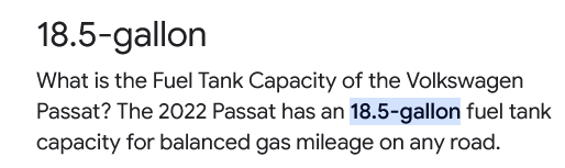

I have seen stats for the Passat at 18.5 Gallons capacity
Screenshot2024-09-04at11-11-31vwpassatfueltankcapacity-GoogleSearch.png.5d6b2d09758900816c1b445f569030f9.png
Given the BS about "balanced gas mileage" that will be US and not imperial gallons.
70 litres?
A little bit less of the top of my head.
How did the thread deviate to the fuel capacity of an American Passat? 😀
