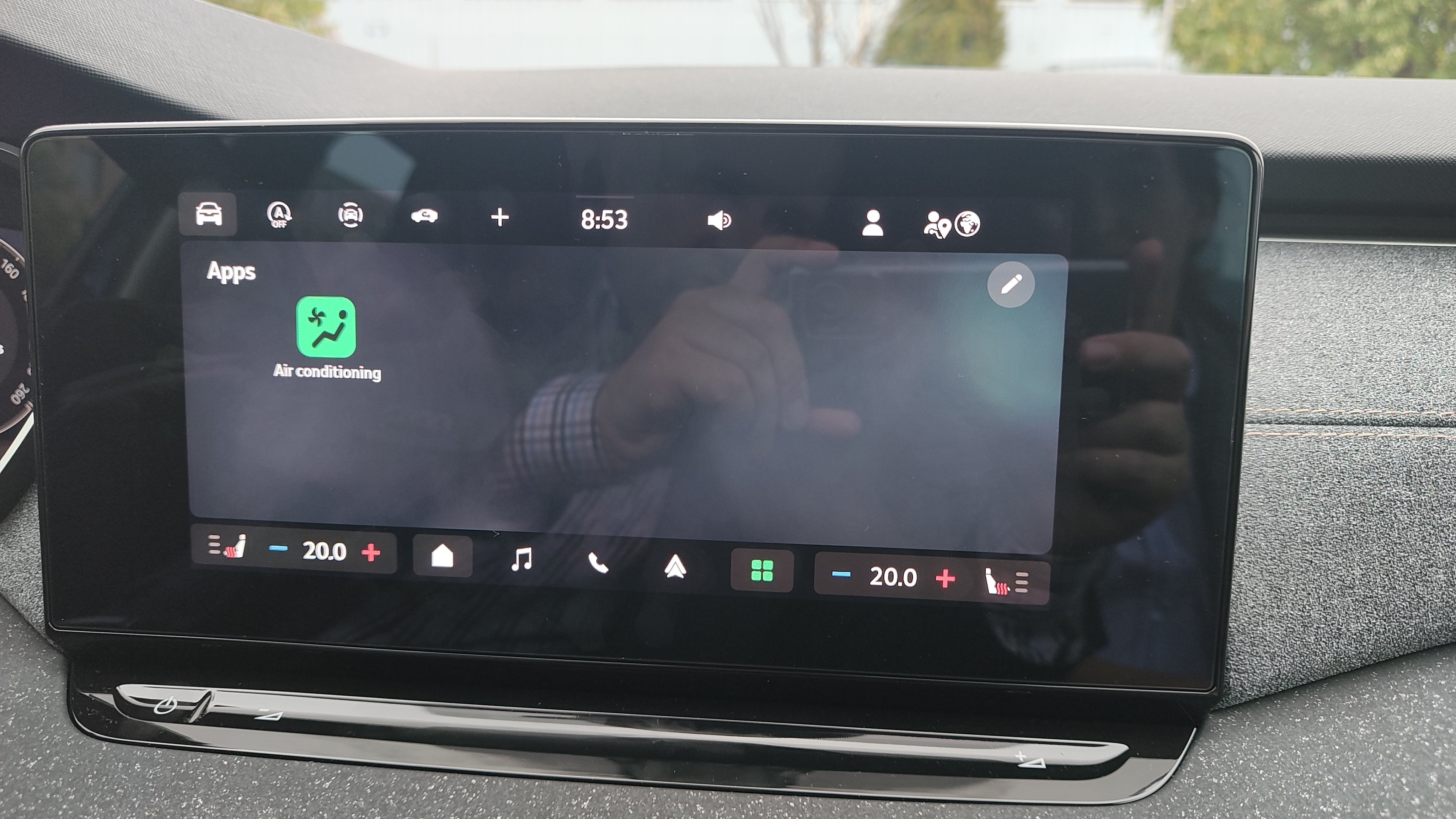

Do you have a photo of the screen showing what it looks like?
Not seen one with an edit button.

Sure. Here is a photo of the screen. When I click on Edit, the only option I have is to reset my favorites (as if there is something to favor). Manual-wise - the first round of troubleshooting was with the booklet but it was useless.

This is what mine looks like - Mk4 FL which I got last Tuesday.
