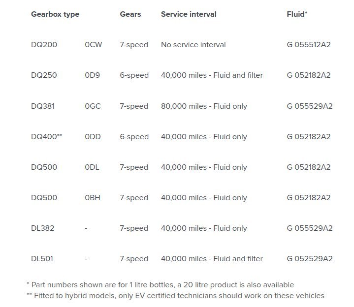

Whoever told you your DSG was way overdue a Service does not know what DSG the car has.
The DQ200 DSG your car has has no Service Schedule or Interval for changing Oil or a Filter.
There are 2 oils.   In the MCU and the Box.  (They can be Changed, but there is no schedule and 40,000 miles does not apply to them.)
Did your car even get the Recall Action / Service Campaign from 2014 on 2010-2012 DQ200,s.
'34F7',  The Oil changed from Synthetic to Mineral and a Software Updare.
There should be a sticker in the Spare Tyre Well showing if done. Date & Dealers Stamp.
