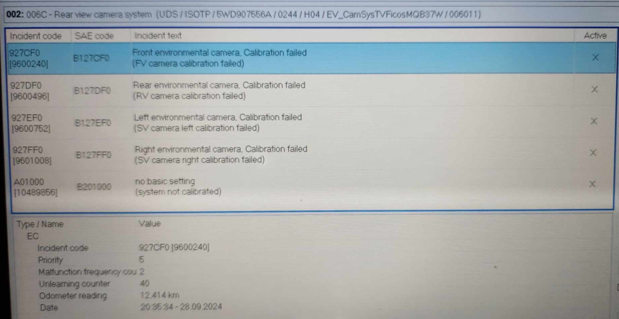

So I'm in the middle of doing a 360 camera retrofit for my Octavia but i'm getting a bit stuck. All the parts are installed and coded but i'm not getting any video output so i'm trying to eliminate possible issues.

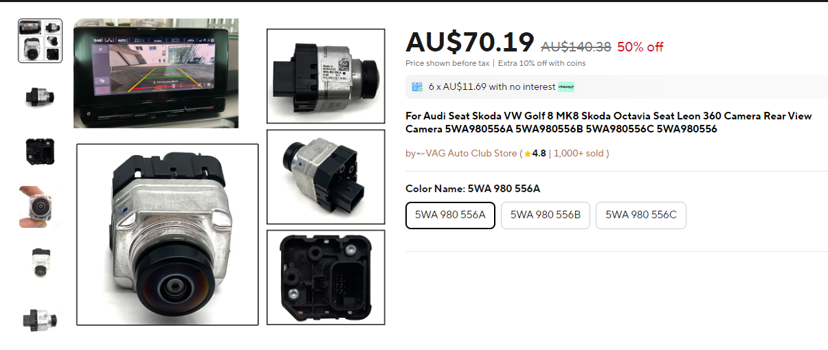

I'm thinking 1 potential issue could be incompatible camera parts.. Does anyone know what the difference between the reverse cameras are?
From my research there's a couple part numbers
- 5WA 980 556 A/B/C     (made in morroco)

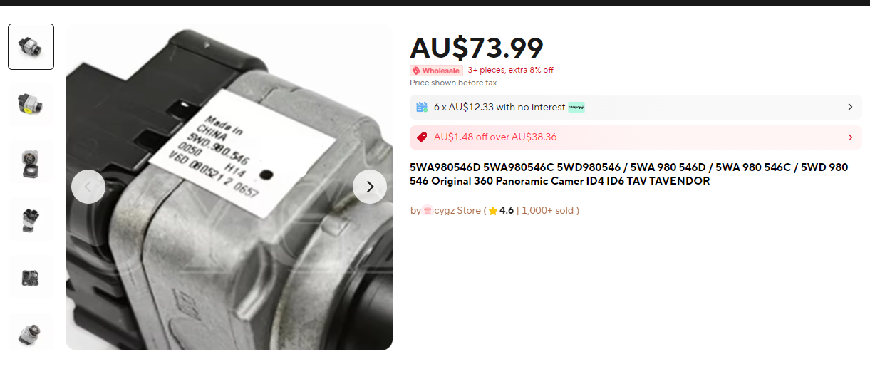

- 5WD 980 546                (made in china)
Other than the manufacturing origin, does anyone know what the other differences are? And if there are any compatibility issues with my RHD car (im based in Aus)?

556 is RVC
546 is area view
5WD is Asia
5WA is RoW
All 4 cameras need to be healthy to get a video output at first, on a new module.
Even if 3 are happy, if 1 isn’t = no output and faults for all 4 cameras

Interesting, my camera part is currently 5WD 546... should it be 5WA 546 instead? Just curious if its a compatibility issue as my previous reverse camera was indeed 5WA 960 556
And is there anyway to tell if the cameras are healthy? I can't seem to see any errors in ODIS - just the calibration error which is expected since not coded yet...
Nothing seems to be wrong with the wiring either.

I was speaking regarding the cameras themselves as that’s all you posted. The area view control module itself can be flashed to 5WA
You’ll get faults for all 4 cameras until all 4 cameras work at least once.
Check your wiring
Ok i'll double check the wiring again.. I have the wiring diagrams and everything looks right so i'm a bit stumped. I shall report back!
And just confirming do my 4x cameras need to be flashed to 5WA in order for it to work for RHD? My 6C Overhead camera module is also 5WD 907 556...
