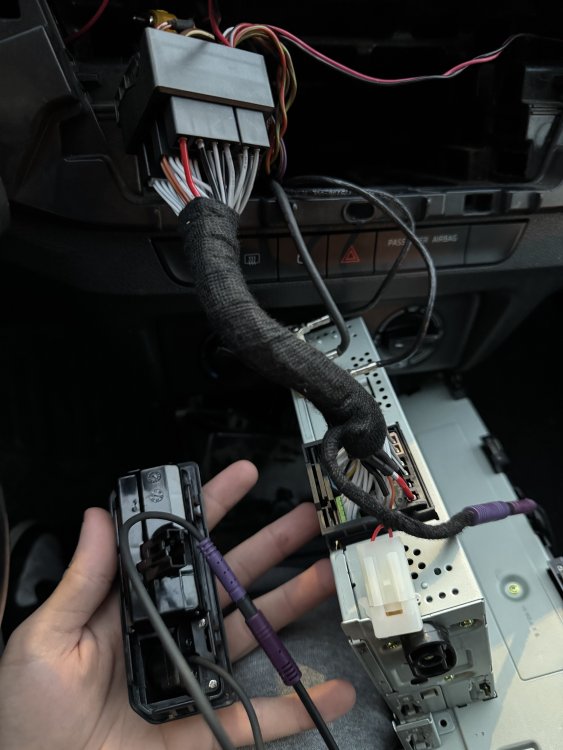

Hi guys, I bought the kit on aliexpress for the rear camera, how can I set it via obd on skoda fabia 3? I attach the photos of the radio + kit. Thanks.

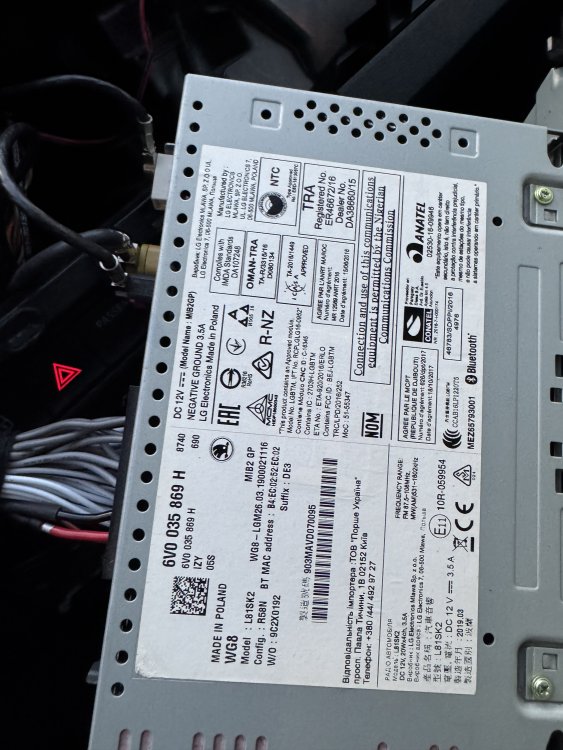

I'm not pretty sure if your unit supports RVC at all... as you already removed the unit pls disassembly it and post a picture of mainboard, at the rear part
6V0 035 869 H is without reversing camera support. the camera is supported from 6V0 035 869 J. he would have to buy another radio, replace it, remove the protection of the components and only then deal with the camera
