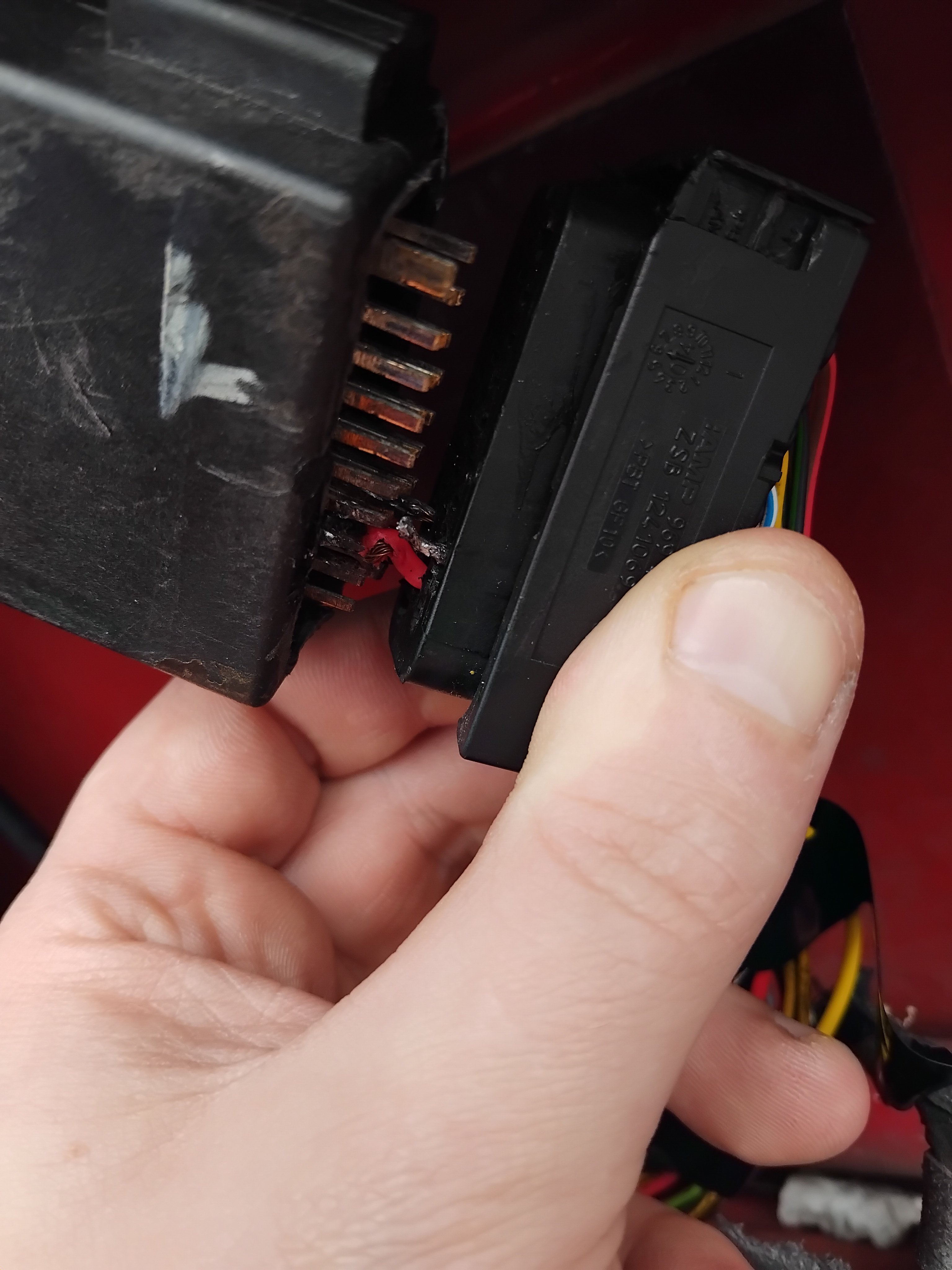

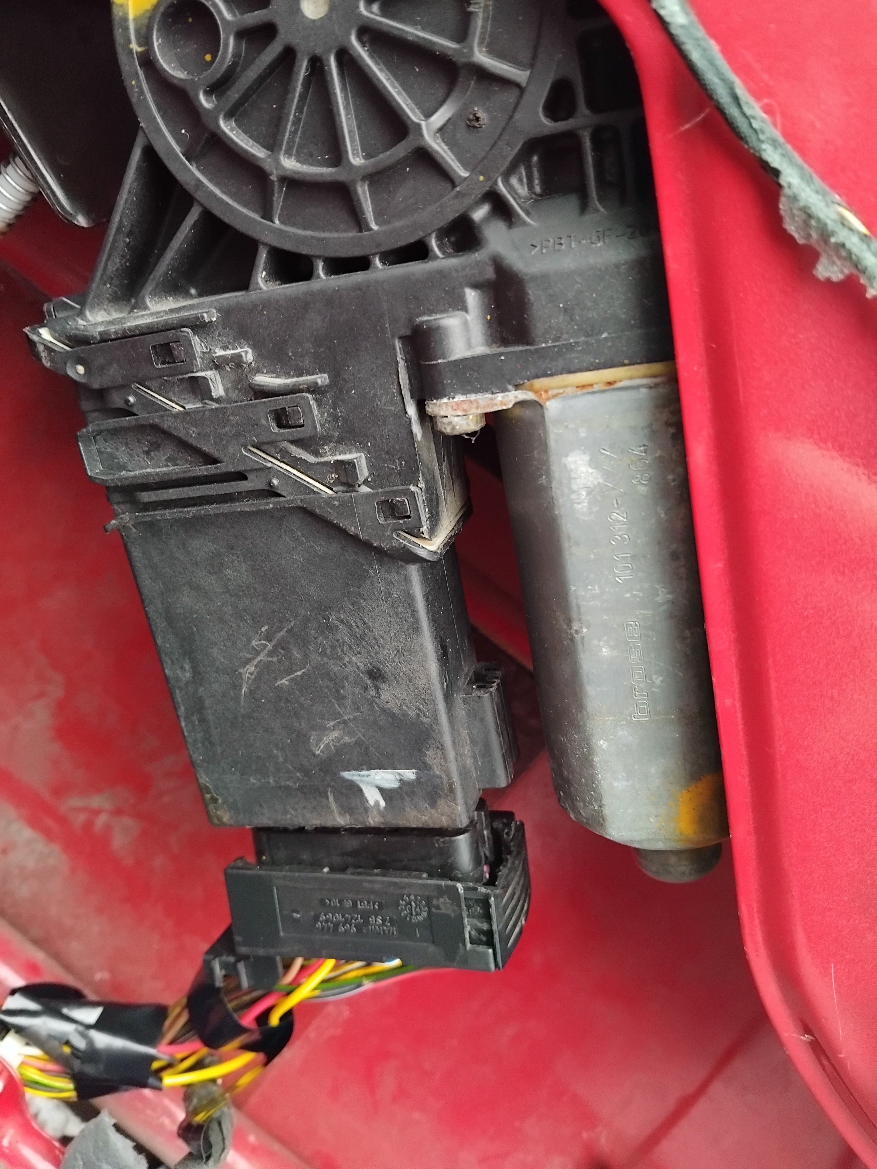

Could some one tell me what this part is called or can find me a replacement so I can order it it's stopping all my windows and electric Mirrors from working last people who owed it must have been right cowboys thanks
The door wiring loom looks a bit butchered. You might need to replace that.
The part that the wiring plugs into is the window regulator that raises and lowers the glass. That has nothing to do with mirrors, so most likely the wires going to the mirrors are broken too. Usually they break where the wiring loom goes from the door to the pillar.

If its an original Skoda/vw part it will have a part number stamped into the plastic or a sticker. My window motor is 1K0959792C. Yours may well be a different number but shoud look similar. . I generally google the part number and see what comes up. Try ebay for second hand ones? As far as the wiring loom for the door I reckon it will be a Skoda only part. I would replace/check wiring first. If the wwindows and mirrors arent working then its probably the wiring. Saying that it looks like someone has had a go at soldering the terminals on the motor.
