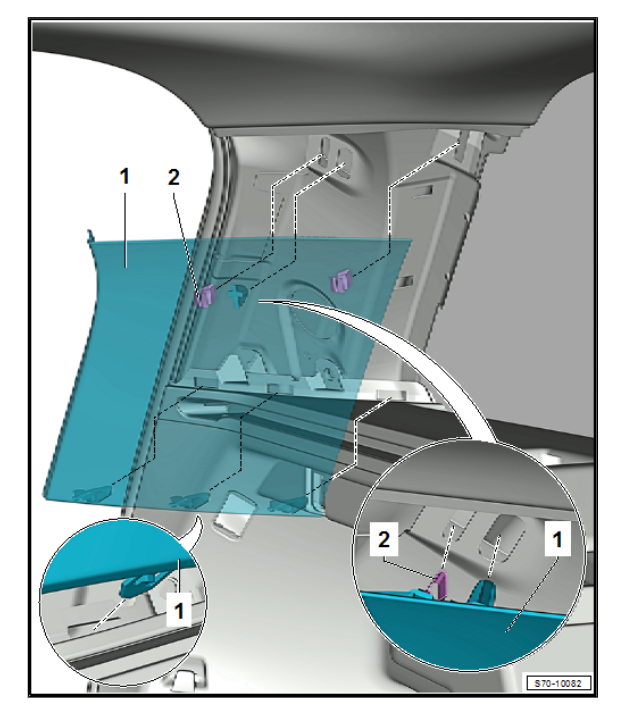

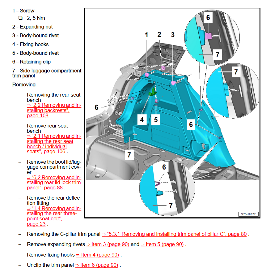

We started off by prying out the C-pillar trim, located just above the luggage compartment wall. We figured it was for taking out the luggage wall trim anyway, so we might save ourselves a lot of work if we found out it goes up the pillar instead of the expected down.
A mere six clips.

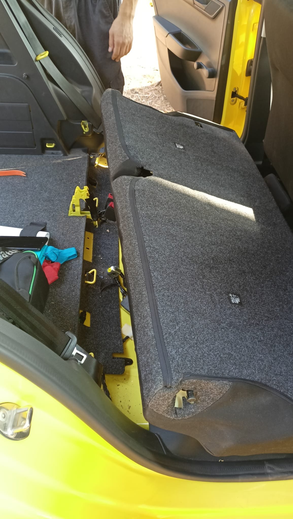

Nope, the wire routes down, and so out the wall trim had to come.
This included removing the rear seat and the backrests. The torque wrench we had didn't mate with the spline socket screw that holds down the middle seatbelt, so upon re-assembly, it was tightened according to the Gudentite specification rather than the Skoda one.
A bit of a lengthier process, but eventually we got the wall trim out.

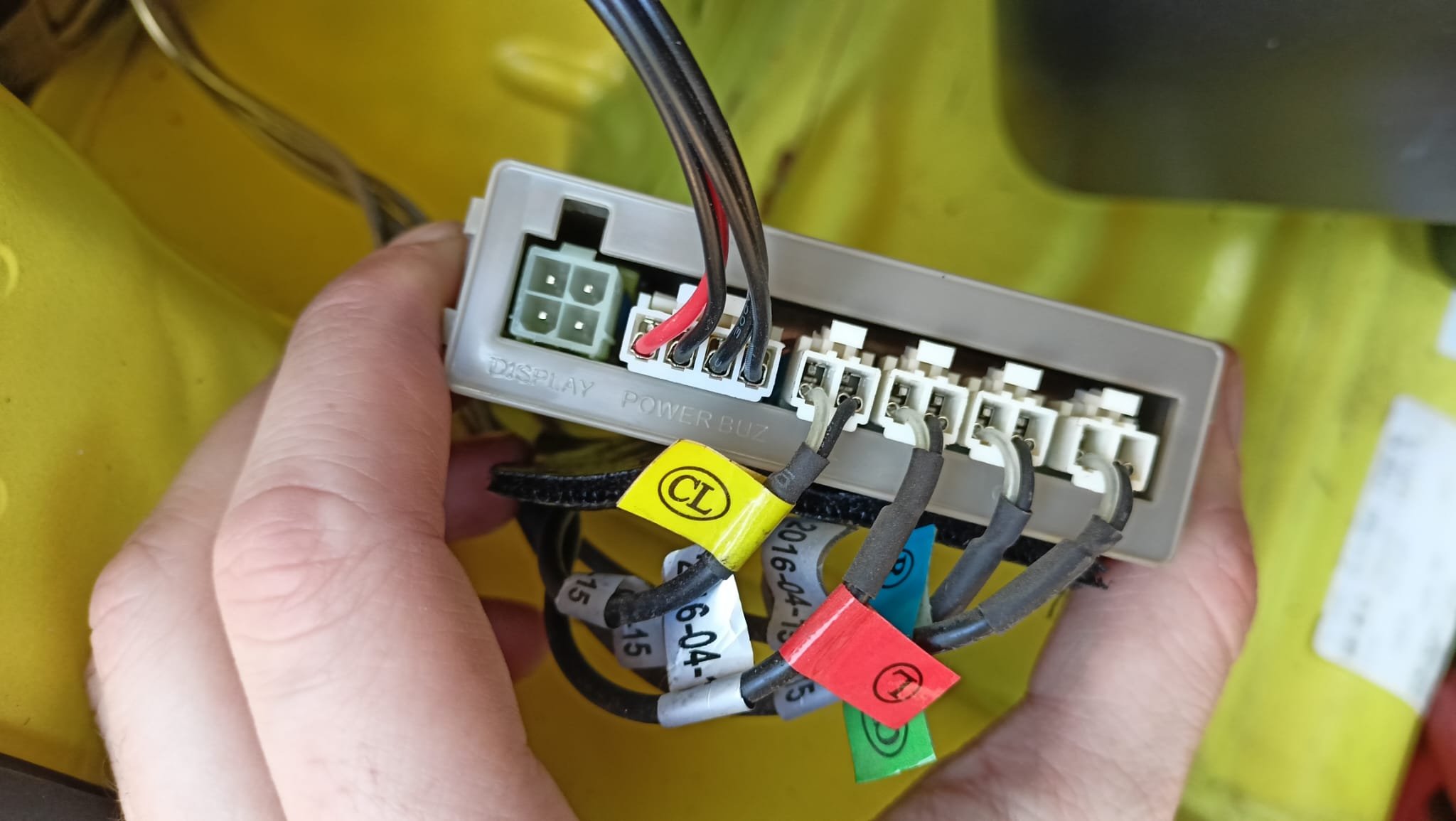

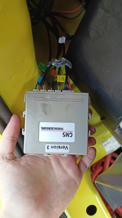

Upon removing the trim, we found that we had hit two birds with one stone - well, one of the birds was killed and the other was gravely injured: we found the parking sensor module.
image.thumb.jpeg.5ab1883f7f1352b0b1f39d5b4d2618fa.jpegimage.thumb.jpeg.e757dab57a81ebc01b3d7396da3ad862.jpeg
The JST connector is supposed to go to a buzzer. Switching the car into reverse gear and standing in front of the sensors indeed triggers pulses of voltage on the connector, exactly as you'd expect the buzzer to beep while reversing. However - where one would expect the buzzer, under the C-pillar, none was to be found.
Crawling under the car confirmed that the parking sensors indeed go up into the module as they're labelled.
Which leaves us with a question - why would anyone go through the trouble of removing the trim, just to take the display, and buzzer, which come with every kit?
Or, alternately, why would a dealership go through the trouble of installing the module, without installing a display and buzzer?
And, without installing a new kit, how does one find the correct display?
I am simply baffled.

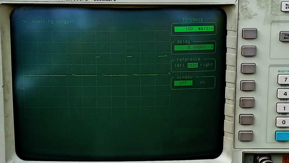

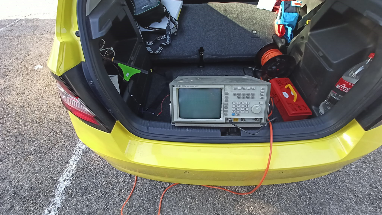

The buzzer has arrived, the wiring was made, and a test was run - no bueno. It made clicking or popping noises, but no real beeps. I immediately suspected that the buzzer I ordered was an AC one (like a speaker), while the system calls for a DC one (different mechanism).
I decided that instead of wiring up a DC buzzer and making another shot I'd check out the signal first, and put my oscilloscope in the trunk. The CRT was struggling a bit, but it was more visible in-person, the signal was clearly DC beep-beep-beeps
image.thumb.png.9fe3688e10c334273288912ef14e8372.png image.png.18460838e90276eb2f5f553ffd690070.png
 I've shopped the 2nd pic in powerpoint to make it clearer, so the scope also looks grosser. I've tried cleaning it to no avail 😆 We see 3 beeps 50msec wide, roughly one beep each 200msec.
I promptly soldered a DC buzzer to a fitting connector, and 3D-printed a small housing to protect the wiring and allow me to tape it in place using Scotch double-sided tape under the C-pillar trim. And... it works! I haven't yet figured out the display, but that'll happen... some day.
P.S. The scope is an HP 54504A I bought for ~120$ (400NIS) off of facebook marketplace, so it's not exactly new, but it works great and has some very nice specs and features.

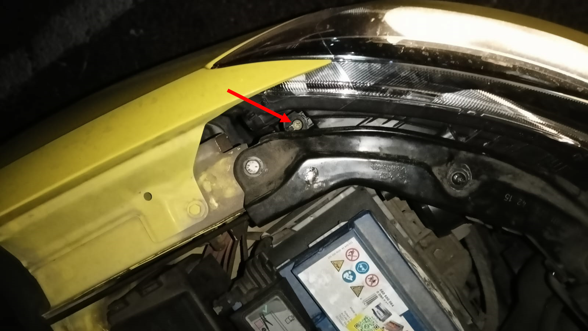

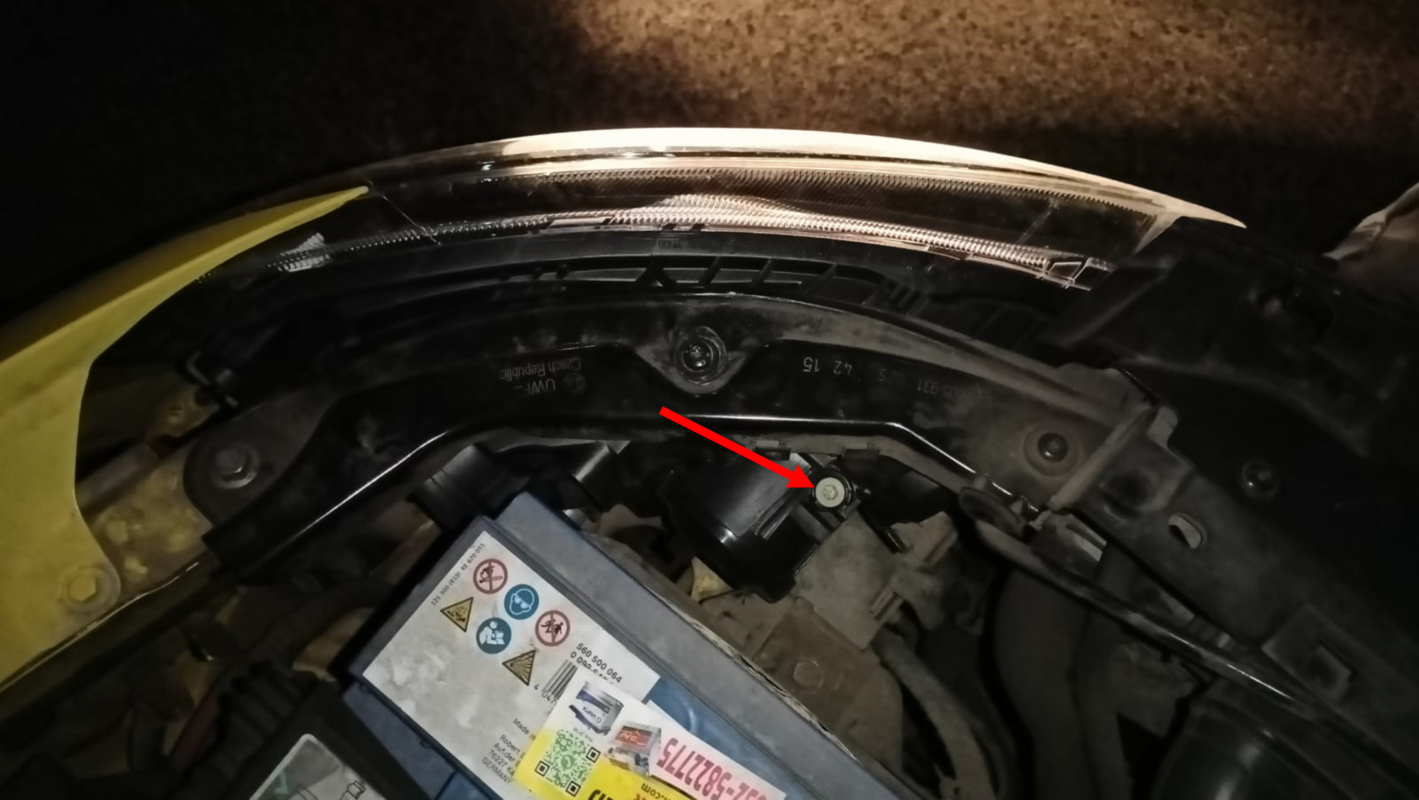

To adjust the headlights correctly, each headlight module has two screws with a phillips and hex head, hidden under the bonnet.
Turning these screws moves the headlight, note that the directions are flipped between the driver side module and passenger side module.
Up/down is adjusted by a screw on the "inboard" side of the module:
And left/right is adjusted by a screw on the "outboard" side of the module:
The screws are a little hidden, so since this job is naturally done during night-time, and since it involves closing the bonnet quite a lot, a headlamp is recommended.
Someone scraped my driver-side front bumper and cracked my headlight, so it was replaced. The new module has a white screw, but the old one is black - not sure if it's the plastic itself or just 8 years of engine bay grime, so YMMV. Apologies for the poor cleanliness state of the car, regardless.

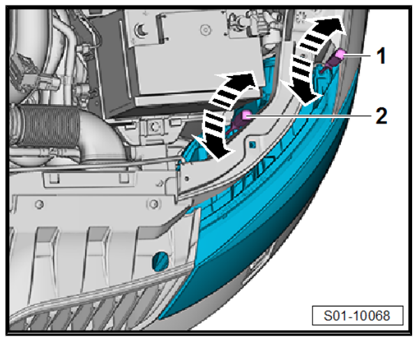

The documentation shows the screws as such:
(Maintenance - Edition 04.20 - Page 158)
