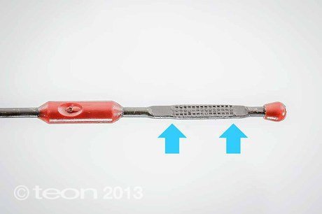

8CFCA627-99C5-49CB-8B92-A9E4B118ACD7.jpeg.aff33411b2364c2a79a21c568d3c82a6 (1).jpeg
Thanks all.
I have checked it when the engine is cold having not been driven since the day before.
I always believed this was the best time to check it? Is that correct?

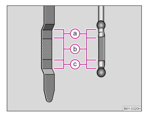

I have the second dipstick in the horizontal row above (Thanks for that) and it is about 1/3rd up the dipstick outside of the indented part (A)

Is the car level when you check? if so, that oil level is far too high, probably by at least 1/2 litre.
