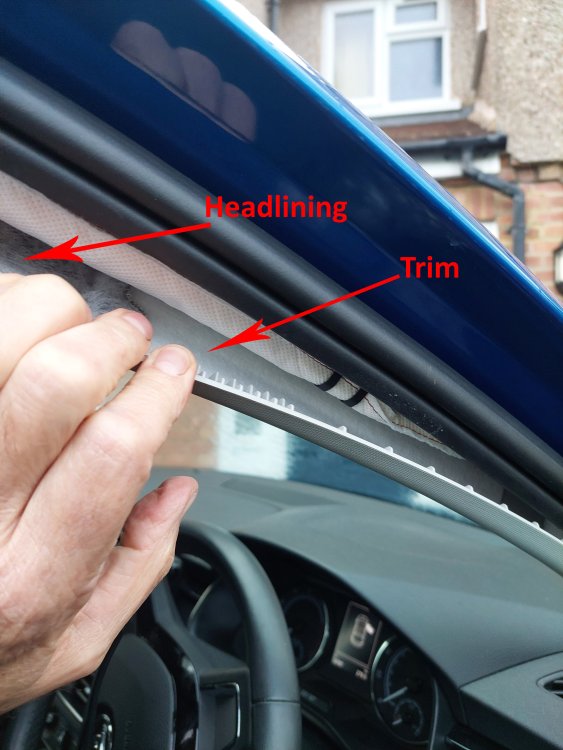

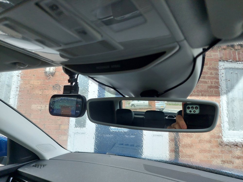

I'm trying to hard wire a Nextbase dashcam to a 2020 UK Skoda Scala 1.0 TSI. I'll position the camera on the passenger side to the left of the mirror (avoiding obstructing the daylight sensor on the back of the mirror). Then piggyback off the rear wiper fuse in the box under the steering wheel.
Which route do people take for the cable? I've looked at running it (untidily) over the mirror (see pic) to the driver's side, under the roof lining, inside the trim of the windscreen pillar; uncliping the panel on the end of the dashboard and then to the fusebox. However, when I peel back the pillar trim, it looks like an airbag is running continuously all the way down from above the headlining and down the door pillar (see pic). I don't want to obstruct it. How do people get from the headlining to the fuse box without crossing this airbag?
Is there an airbag in the rear view mirror area? (In which case I should probably route the cable the other way to the passenger's windscreen pillar and then find a way behind the glove compartment to the fuse box.) But I'll still need to avoid crossing the door pillar airbag.

RHD car guidance. I ran my dashcam cable on the passenger side, firstly under the headlining and then by removing the A pillar trim and running the cable behind the airbag. The trim on the left end of the dash (i.e. on the side of the glovebox) is easily removed, then I piggybacked on a suitable fuse. Top tip - if you unplug the passenger airbag switch in order to move the trim right out of the way, don't switch on the ignition with it disconnected. I did, and it generated a fault code which I had to clear using OBDEleven. Hint - put zip ties on the dashcam cable to keep it from slipping out from behind the headlining. Just zip tight and cut the end short, and the 'blob' will keep the cable neatly tucked away.
Thank you. I'll route the cable via the passenger side. It seems I need to pull the A pillar trim off completely and get the cable behind the airbag. I did have a quick go today at pulling off the trim but so far without success - I'll do a bit of digging for tips on the direction of pull etc.

All done now. Getting the pillar trim off was a challenge. Having unseated it from the door seal, I ended up pushing the top part from outside the car parallel with the windscreen. I was thinking I was going to damage it and then the upper section loosened off. Pulled it upwards towards the roof and with some hard wiggling it came off.
I ended up routing the cable from behind the glove compartment on the passenger side to the fuse box on the driver's side by pushing the cable in the join between the lower bit of the console and the upper part. I couldn't find a way to feed it through round the back.
Piggybacked off fuse 43 - rear windscreen wiper.
At first the camera wouldn't power up when the ignition switch was turned to the powered position. I measured the voltage at the bullet connector - 11.7V. Thought I'd got a faulty hard-wire kit. Then I remembered something about the dashcam only being powered if more than 12V is available. Turned the engine on and the dashcam powered up!
