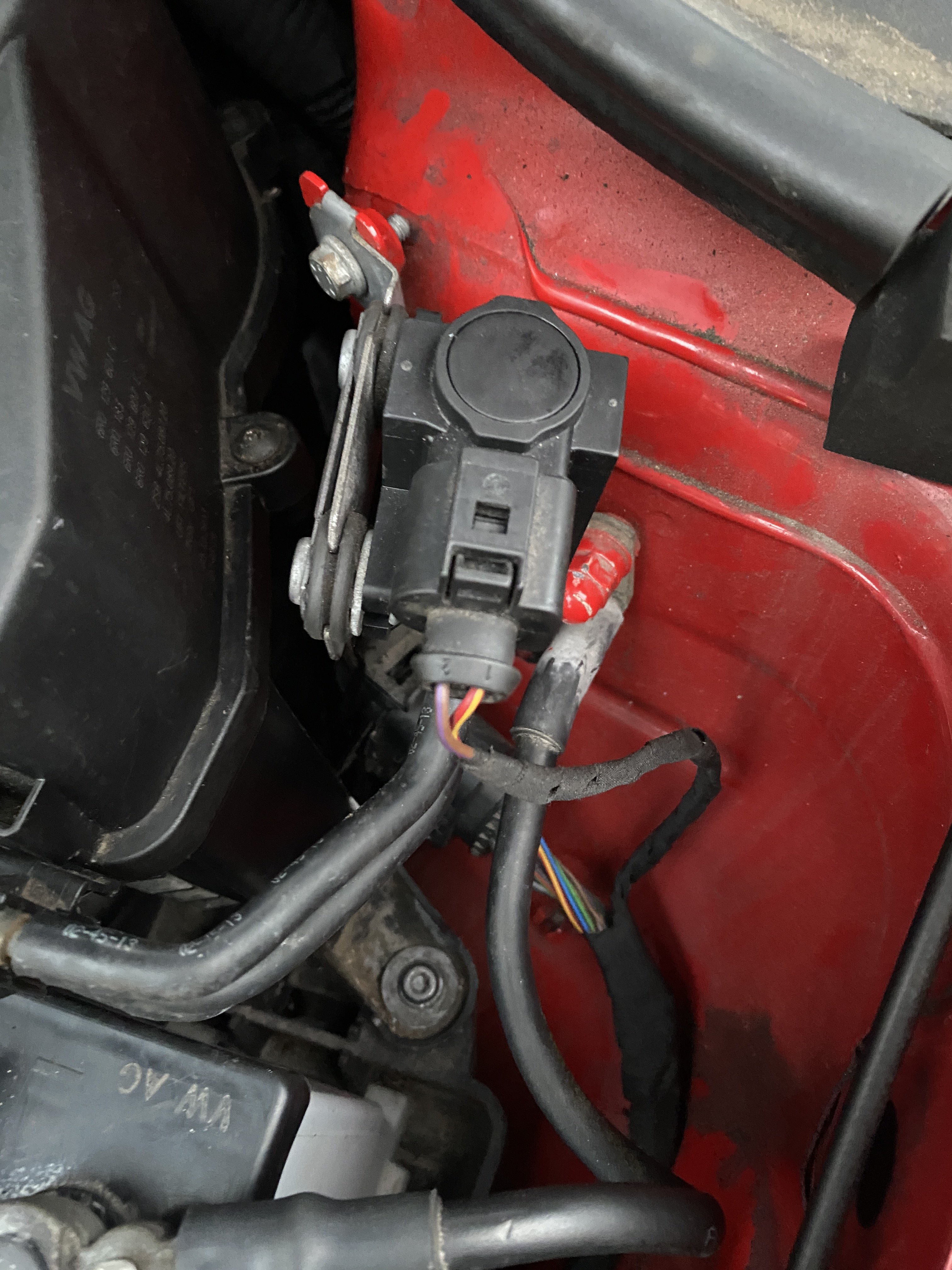

i’m getting a noise from the part in the picture (rhs of engine) what part is it?
seems to follow the accelerator pedel in sound if that makes sense until the roar of the beast drowns any sound out
also its just started idling at 1000rpm and not dropping back to 750-800
is this correlated?
Its thrown a few glow light / engine management lights that seem to cycle off after a few starts
ive had the codes cleared earlier today help with identifying the issue
just wondering if anyone has had the same issue?
apart from that the car seems to drive fine
thanks in advance
fitted new oem and resolved issues
however this was not the cause of the glow light flashing or EML
(P0101)
hopefully this problem is only a new maf had enough fixing things already lol
