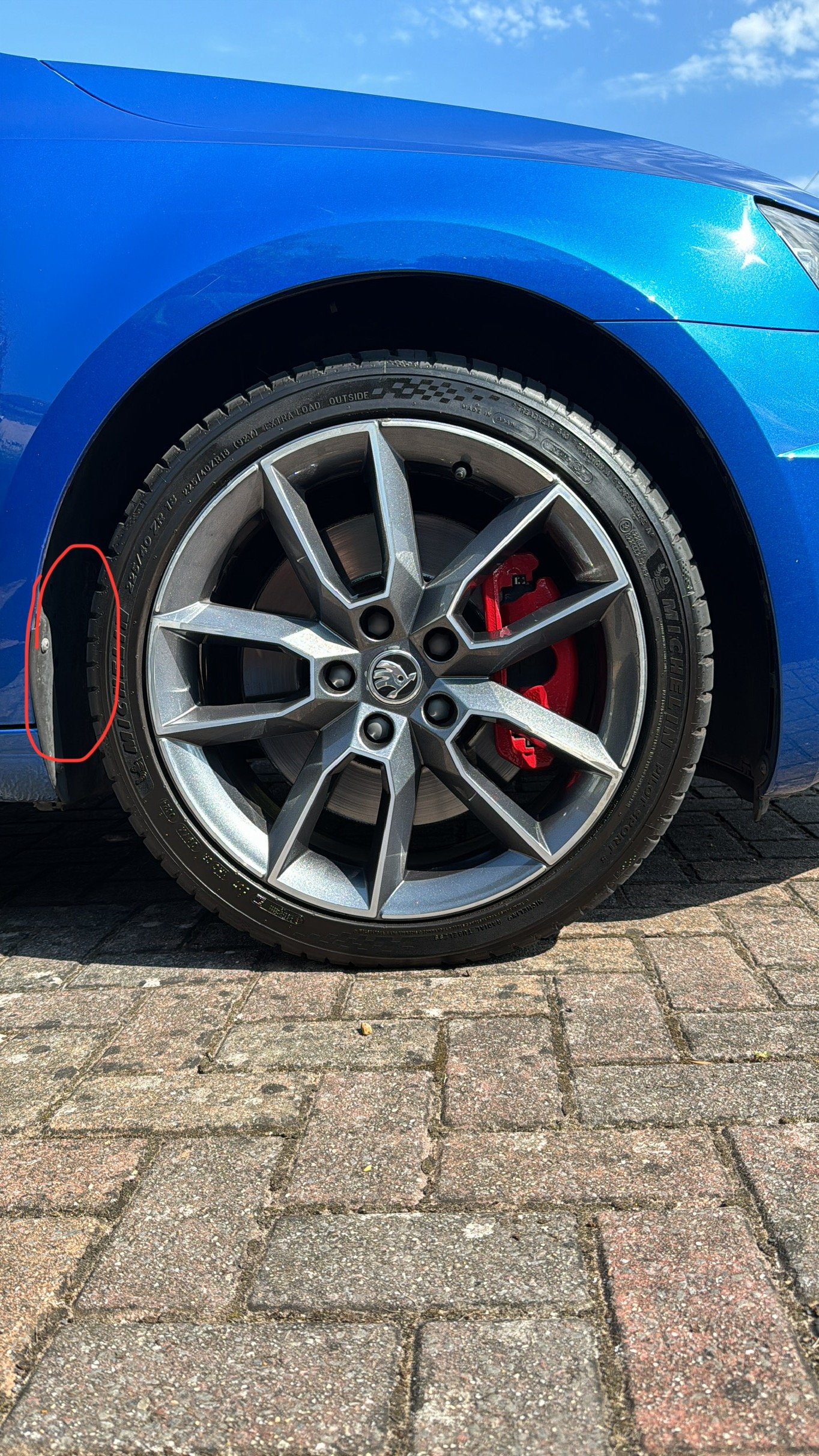

Upon returning from a road trip (I know), I gave the car a thorough clean, and noticed that my wheel arch brush would squeeze betweenthe right tyre and arch, but was a much looser fit on the left.

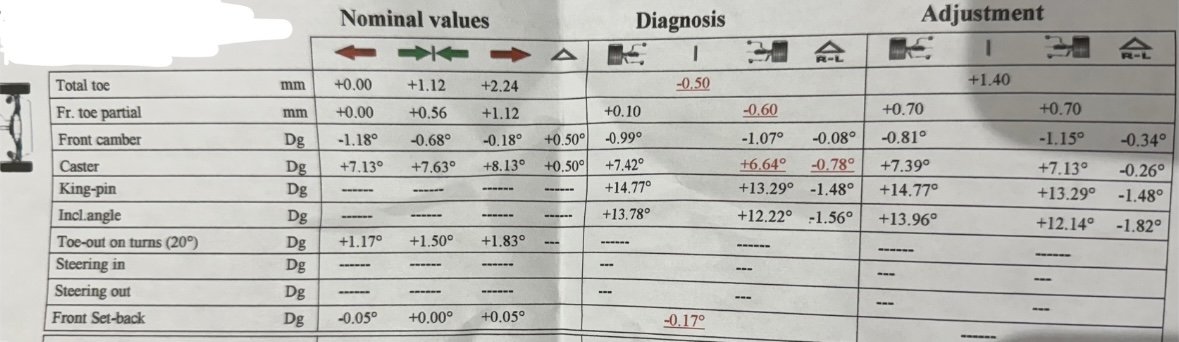

I visited my local alignment specialist and as soon as he loosened the subrame bolts, it popped back into place with a nice twang. Nothing seemed obviously out of place.
A full four wheel alignment was then done, with everything now being in spec. I figured it was sorted and got on with my life. Yesterday, when giving the car another (now rare) bath, I found that the same issue with the right front wheel was there, with the wheel appearing slightly pushed back. It's worth noting that the front right wheel has a pretty deep/sharp cut in the rim, however nothing even close to buckled, etc.

Everything is within factory spec (both on Hunter and S9 Aligner) - nothing seems to be bent that we can see. Certainly, if something was bent, then it wouldn’t all line up, would it?

It’s been suggested to me that the wing might just be a bit out - do we think this is possible? I would estimate the difference between the tyre and arch liner (see photo) on either side is about 5-10mm out. I.E. the brush squeezes into the right side but fits loosely in the left.

Alignment sheet from the S9 below -

I’m working on the basis that if the alignment is true and correct, but there is still a potential discrepancy in the spacing between tyre and arch (the photo was to show the distance I mean, rather than show it’s off), then the only other explanation can be the wing.
