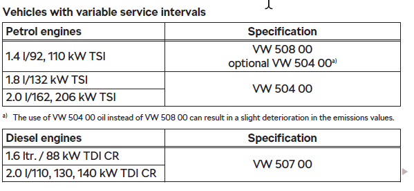

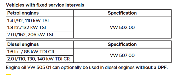

The Spec has not changed to 0w 30 FS III for a 2016 TDI.
The Spec is VW504 00 / 507 00,  so 5w 30 FS III,   **or if you want 0w 30 FS III. **
It was when the VW Group went to VW508 00 / 509 00 so 0w 20 FS IV that some TDI,s stayed at VW 504 00 / 507 00 & get 0w 30 FS III
That was for the WLTP Certification.
