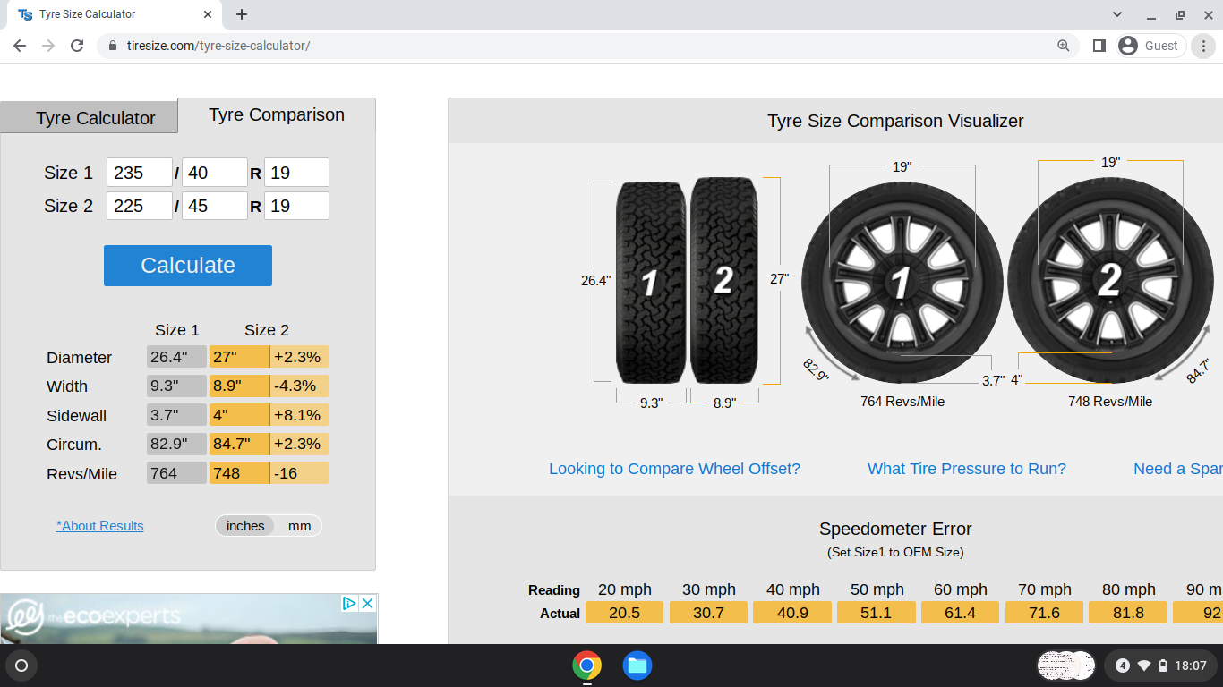

I've changed my tyres from 235/40/19 to 225/45/19

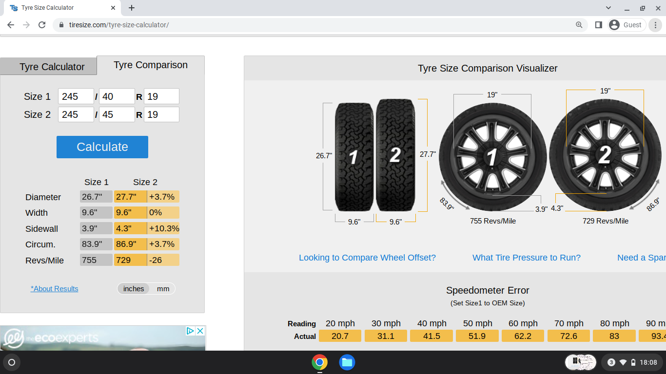

But I still feel it's still not comfortable enough. Can I put 245/45/19 or 245/40/19 I'm so confused any help anyone??

For decades now even if you buy a glorified shopping-trolley car it will have fashion oversized wheels and tyres on it so a big car called sportline will have even more oversized wheels and tyres, even with 190PS and whatever torque it has you don't even need 17" (and not as wide) wheels and tyres but fashion and willy-waving dictates "fillin' the arches" (not so good in snow and deep mud).  Comfort will also depend on the design, make, composition and compounds of the tyres you chose as well as size.  Also you need to consider and check the suspension system is in good condition and working reasonably.
