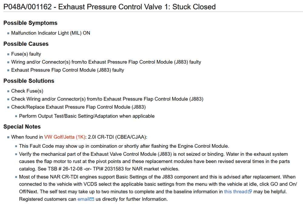

Code is p048e00
Thanks
That related to a failed or failing Exhaust Pressure Control flap.
