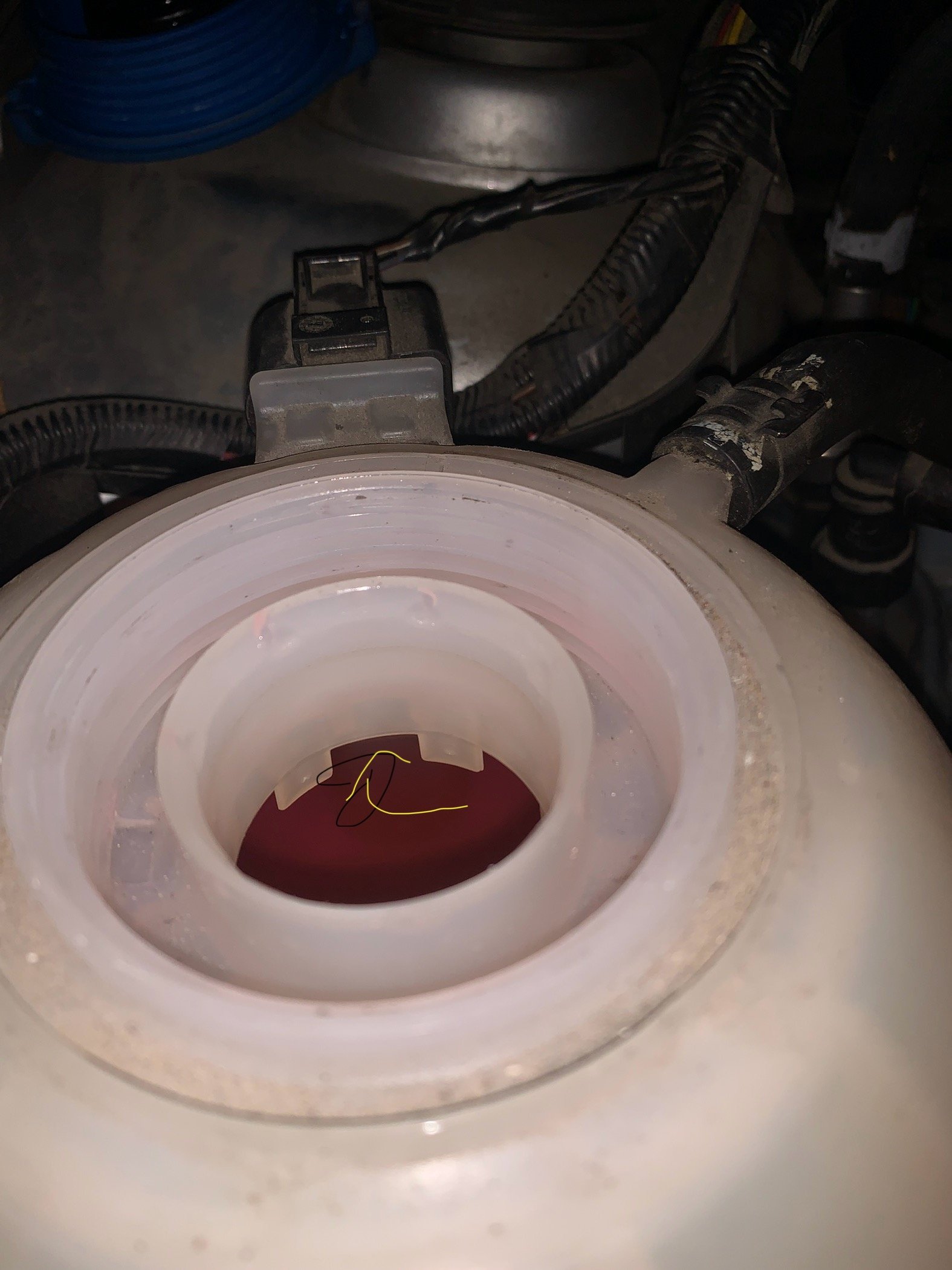

It’s a little difficult but I can make out two small round prongs at the back under where the plug location is. I can’t get the photo to show them but is that what you’re talking about? Or are they more central in the model your talking about?
It looks plausible. Can you reach them with a screwdriver? If not, a new expansion bottle was about £25 the last time I looked.
