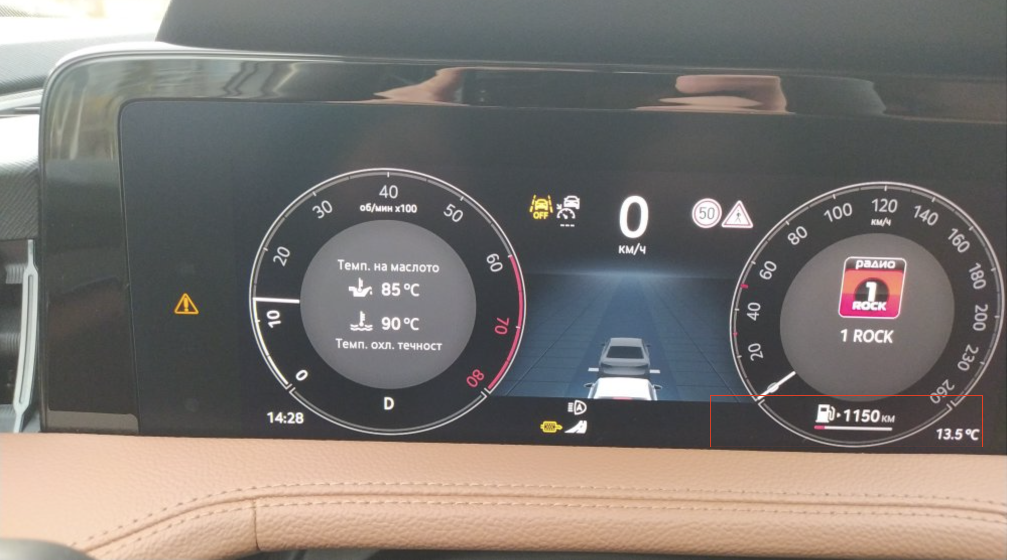

@Rigor is there any chance to get different view here. Instead the rest millage to refill, just ti be current petrol level?
@DasSkoda When i asked from the dealeri was told that no. The lower bar should indicate fuel level (quite poorly tbh), and intended way is to look at the milage remaining and decide based on that.
Okay, thanks for the clarification.
Tbh, it's poor design.

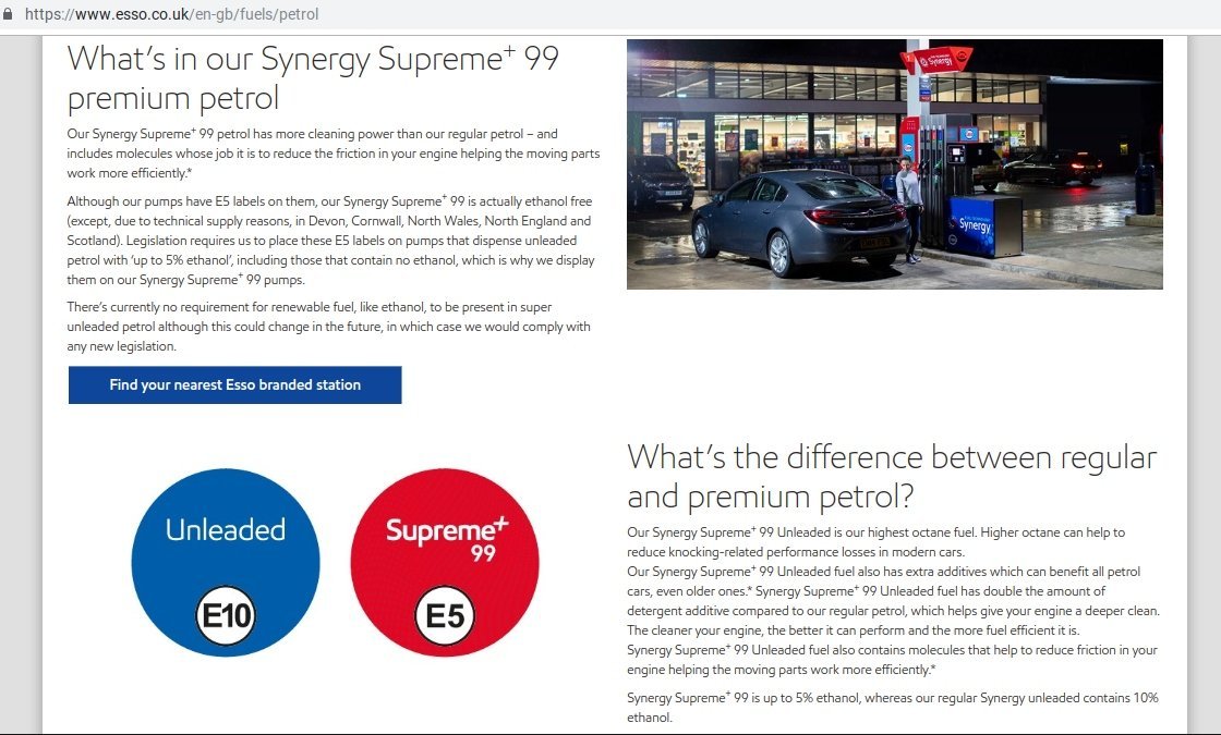

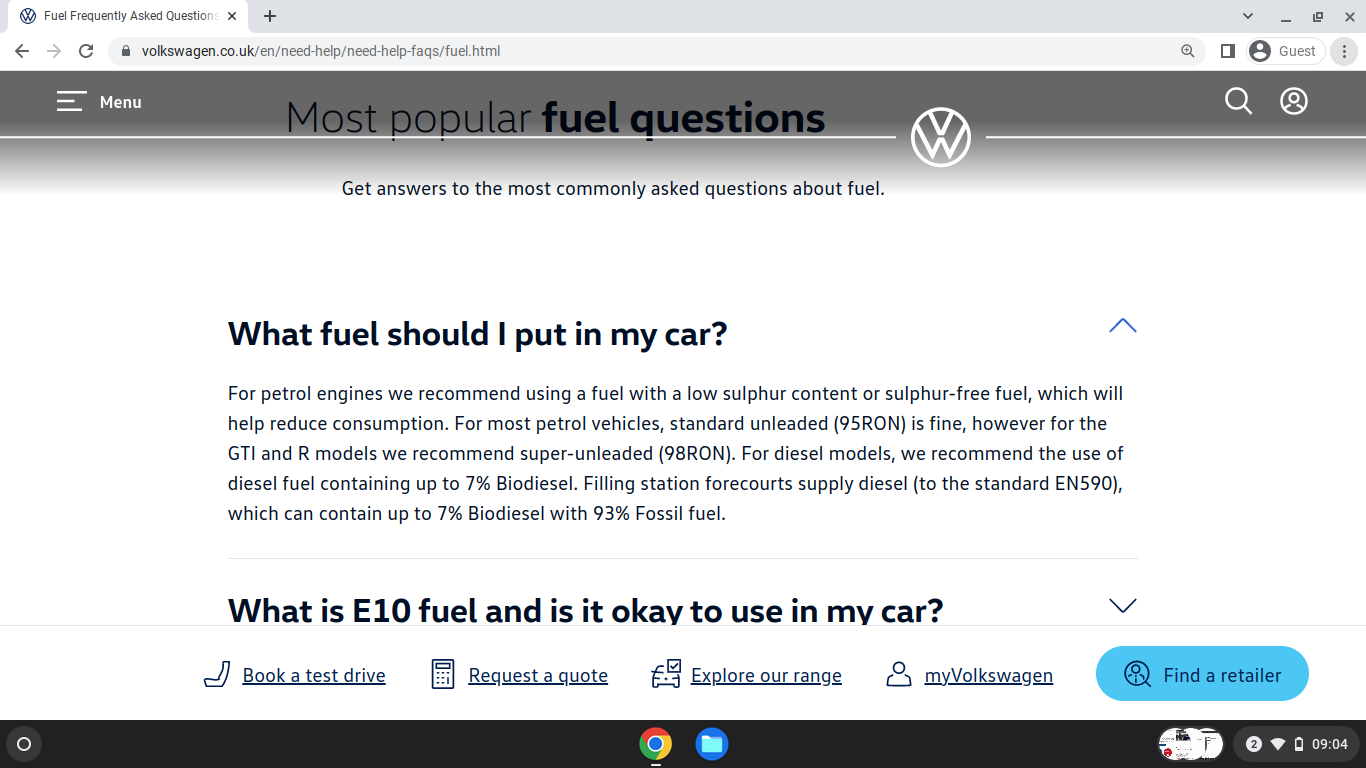

Have you read the Owners Manual?
They know very little about little.   As it is German Winter fuel is 100 ron.  Parts of Europe 102 ron.
They as in who you spoke to seem to ignore the VW recommendations for GTI,s / R,s.    But then that is common.
Shell V-Power might be considered as best by some in the UK, even when not.
The fuels are not the same from the same brands around the UK, as ESSO shows regarding theirs. Different Depots / Storage / Ethanol.
TSI,s love ethanol IME.
http://youtube.com/watch?v=qujugSrVhYc
VW have published this for many many years now.
98 Ron Super Unleaded has not been available in the UK foe more than a decade. It is 97 or 99 ron minimum.
95 ron E10 might not have 10$ Ethanol in the UK.

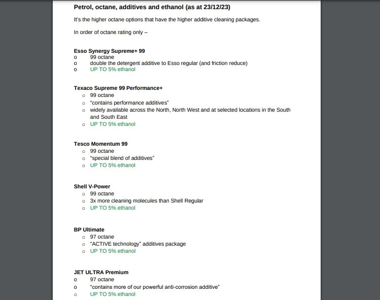

I've been trying to find evidence of an improved additive pack in Sainsbury's Super Unleaded, but I've never seen any to confirm this.
Sainsbury's don't make any claims for it, which IMO is either Sainsbury's missing a trick or keeping their mouth shut on a deficiency.
Tesco Momentum has an excellent reputation, so I'm not sure why Sainsbury's wouldn't want to promote their fuel if it was in some way outstanding.
38 minutes ago, DasSkoda said:
Bulgaria.
From the dealership told me, that they d o not recommend high octane to be used. They observe issues with sparks.
That's why, will go with that approach.
Hmmm. That does not sound very convincing. I wonder what the issue with sparks is?
@EnterName  Simples, Sainsbury just guarantee 97 ron minimum, which is good, and at good prices.
I do not want an Additive pack / detergents which is why for special occasions i bought 102 ron track fuel.
Carless Hiperflo 250  Just double the price of the best Tesco Momentum 99, but great with the right map. 'Vital Equipment'
You used to get 102 ron BP at a filling station near Knockhill Race Track.
You get 102 pump fuel / Shell near car factories and tracks in Italy.  & Shell ran adverts with a F1 on Pump Fuel, not showing it was 102 ron not 98 as was sold in the UK back then
Sainsburys Super Unleaded can be Tesco Momentum 99 if Greenergy deliver.
They buy at the best prices,
Greenergy produce & supply to most of the ESSO filling stations in the UK, hence the difference in Ethanol content in some areas of the UK.

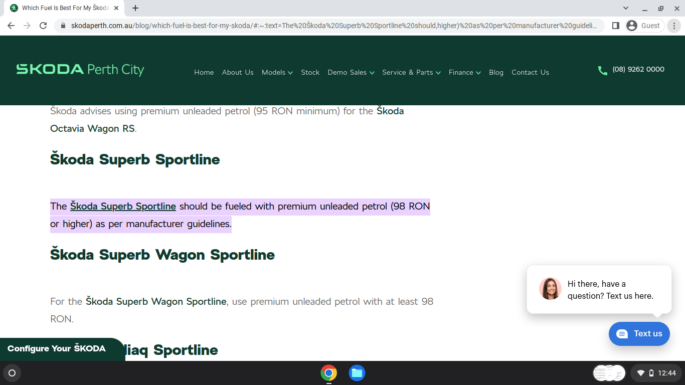

Perth...................Australia.
