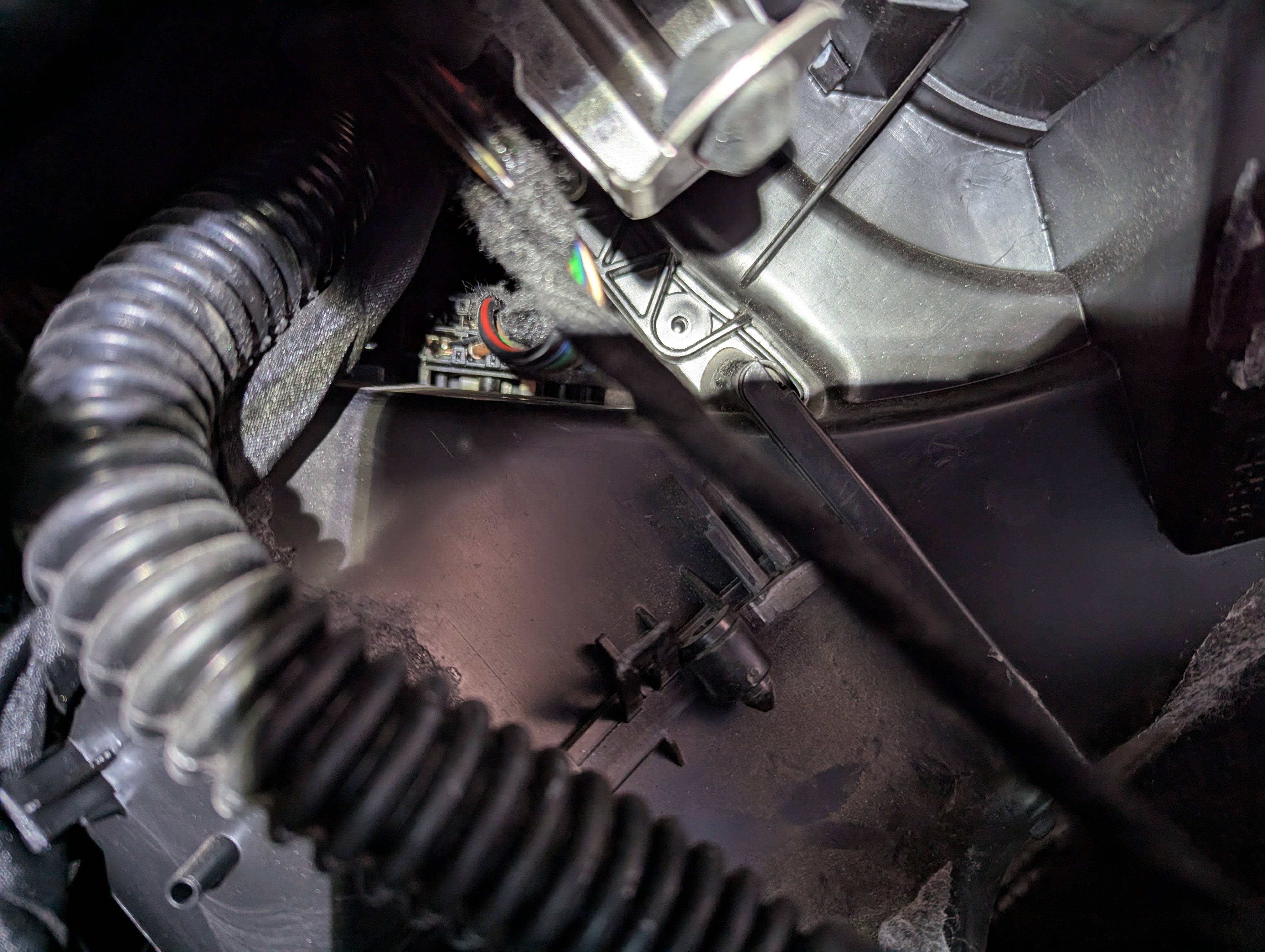

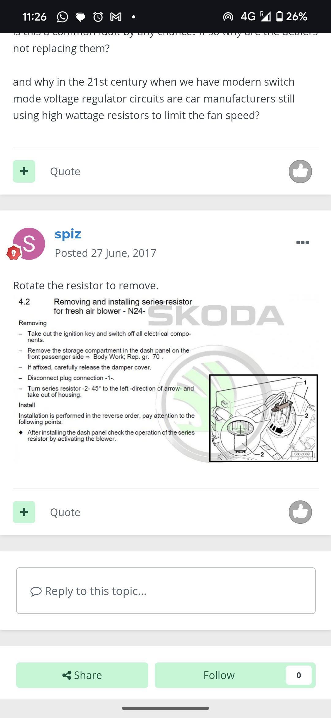

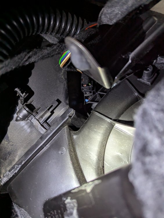

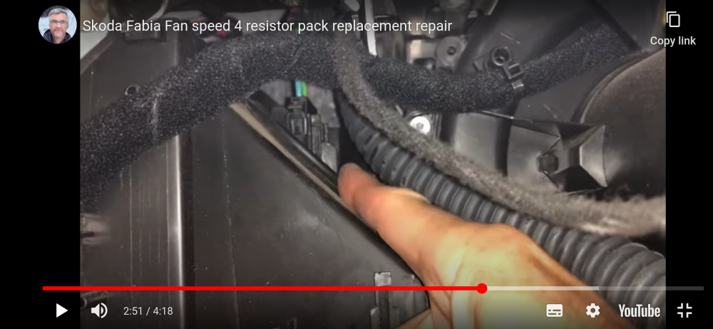

Hello I have a skoda rapid 2013 and am trying to find the blower resistor but can't find it. I followed the guide in a previous thread about this. The first screenshot is a YouTube video that was linked in the post but I seem to have something different see my picture of the same location in the third picture.
Can anyone explain what I am not understanding or where I am going working and how to fix it?
You probably have the Climatronic system which uses a transistorised controller instead of the resistor pack.
